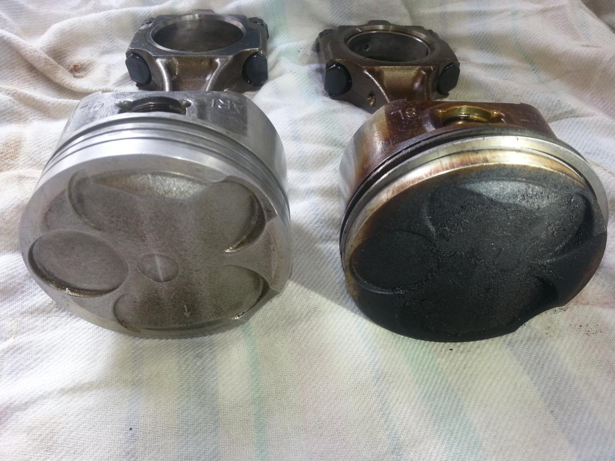

carbonboy Posted January 20, 2015 Author Report Posted January 20, 2015 Well, things are a little bit chaotic but still making progress. Decided against using the 20v pistons & started cleaning up the 16v pistons. Only to find this on #2. Spoke to an engine builder, who believes that was caused by detonation, either from heat buildup in the carbon deposits or from incorrect timing. Definitely something to be aware of now that I am going to be using these. Waiting on parts to be able to dummy-assemble the engine & check for piston/valve clearance. Hoping for 1.5mm+, back to square one if not. Cylinder head is also getting sone treatment, valve guides replaced & basically a full recondition. Quote

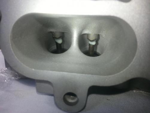

carbonboy Posted January 24, 2015 Author Report Posted January 24, 2015 Out of everything that I have ever experienced in my life that has been nerve-wracking, honing engine cylinder bores is definitely up there. Gave it a damn good clean, flushed out all the galleries, air gun dry then a coat of WD40 & it's currently on the stand covered in cling wrap. On a side note, picked up the cylinder head from its freshen up. All the valve guides replaced, valves/seats machined, new stem seals & all clearances set. Ready for 4A-G4C V2.0. Quote
