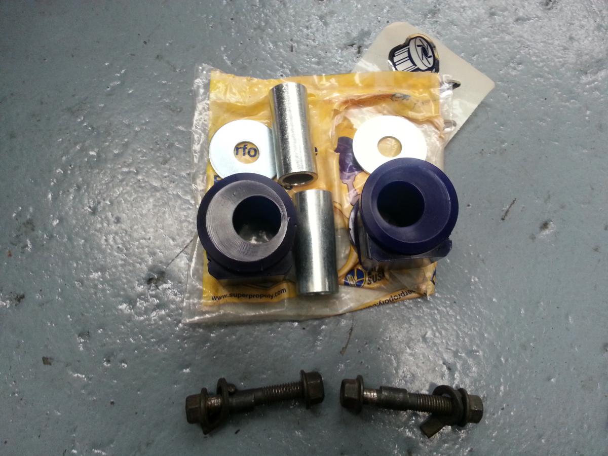

carbonboy Posted July 28, 2014 Author Report Posted July 28, 2014 It's seriously an awesome feeling, I certainly don't regard myself as some sort of engine guru (I did follow step by step instructions after all), but it is the most complex thing I've ever put together. Finally pulled my finger out & installed the castor bushes on the front control arms & a set of camber bolts in the rear hubs. Currently repairing a stripped thread on the front swaybar mount so haven't 'tested' the new handling traits just yet. Quote

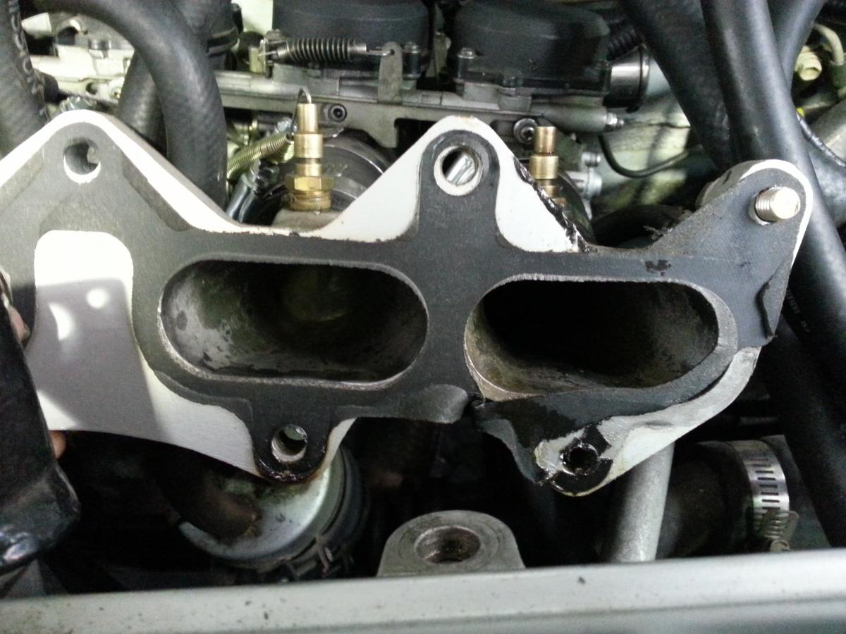

carbonboy Posted August 29, 2014 Author Report Posted August 29, 2014 I spent last Saturday afternoon/evening & ALL of Sunday trying to get the carburetors in sync. Went through about 25L of petrol in the process, but no luck. I could get 1, 2 & 3 all good but number 4 just didn't want to play ball. Found out why this afternoon. Obviously I stuffed it installing the manifold, which was sometime around February & the manifold hasn't been off since. :blush: Installed a new gasket, haven't tuned it yet but the difference.....oh my! :) Quote
carbonboy Posted August 30, 2014 Author Report Posted August 30, 2014 Managed to get the carbs in sync & then advanced the timing/changed the curve to suit. Running at 13° btdc at idle (~1,000 rpm) & curving upwards at 1,500 rpm to a maximum of 35° btdc at 4,000 rpm. Goes nicely, will post video when I can. Quote
