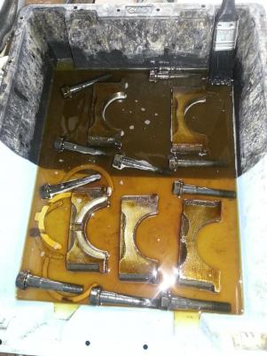

Yep, they have a WD-40 coating for now to stop rust forming on the conrods until the time comes that I install them.

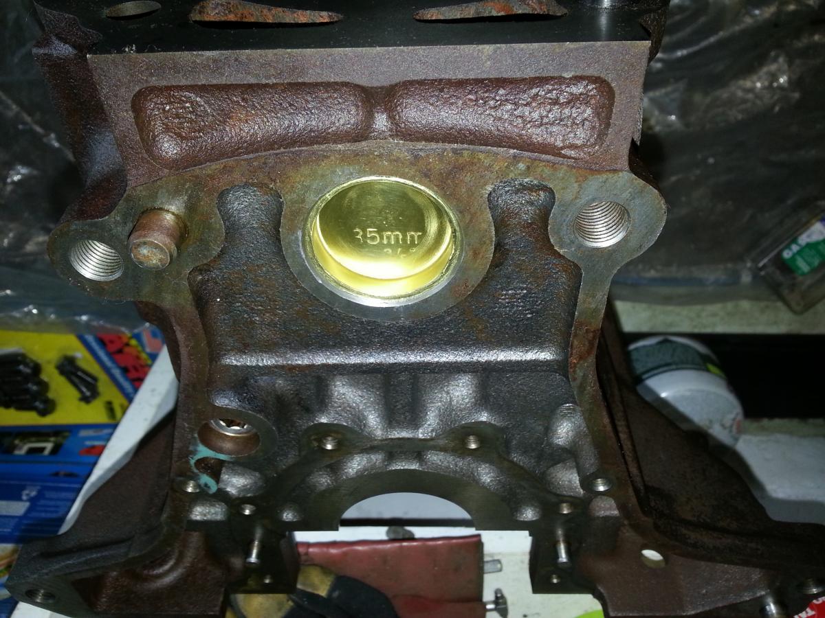

New core plugs in, happy-hammer-fun-times.
