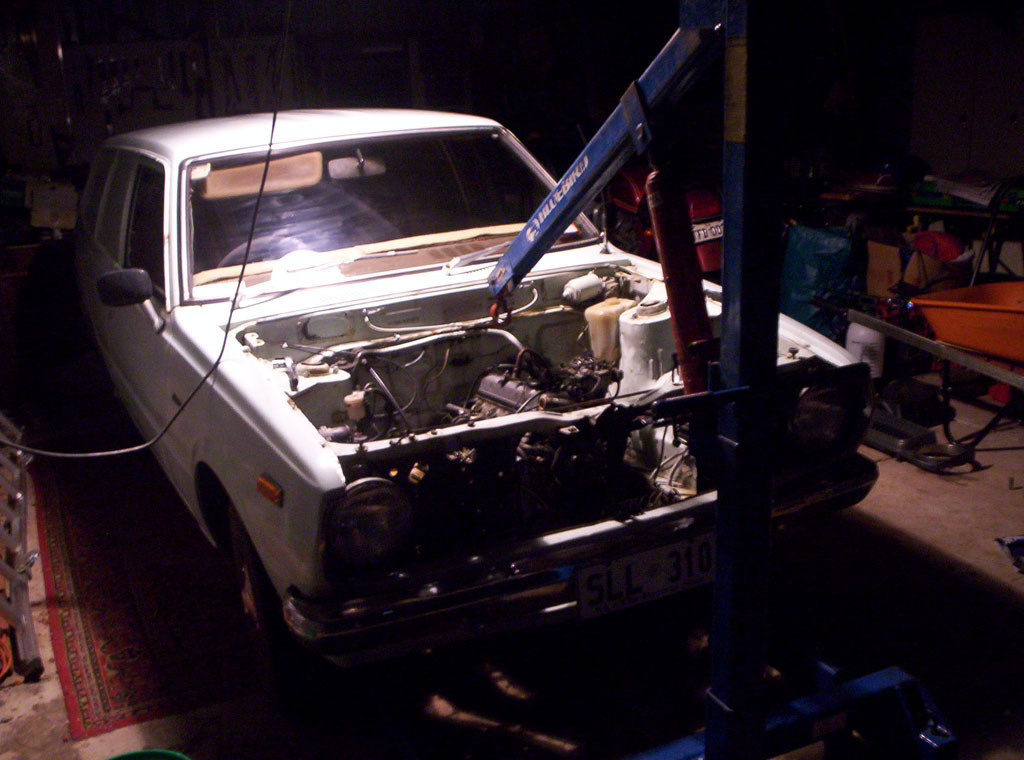

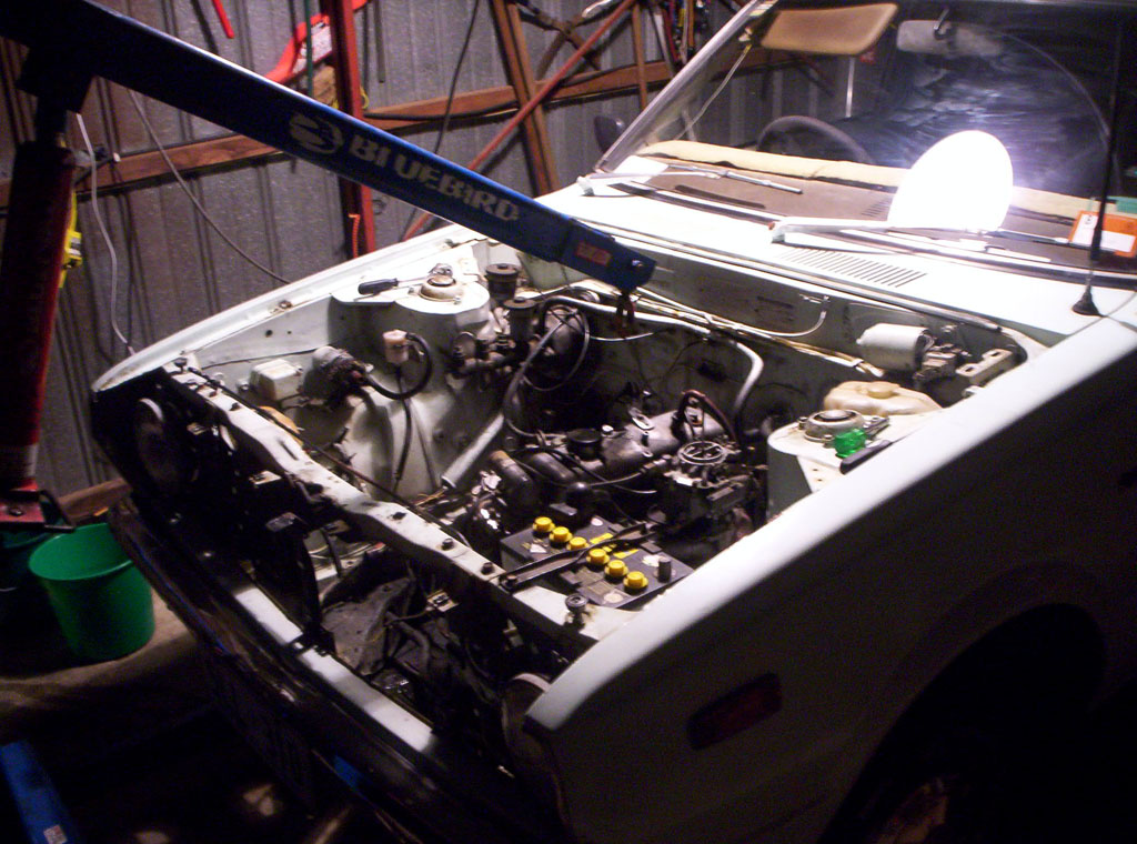

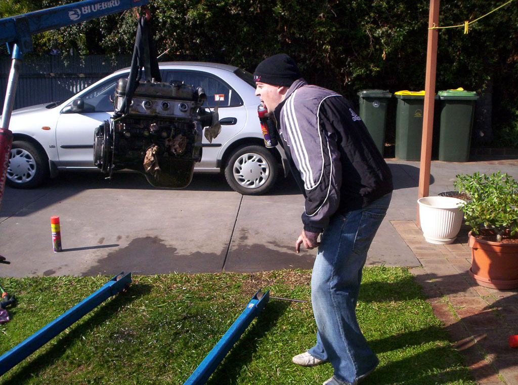

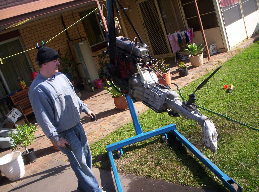

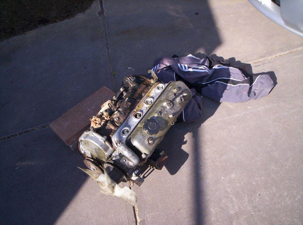

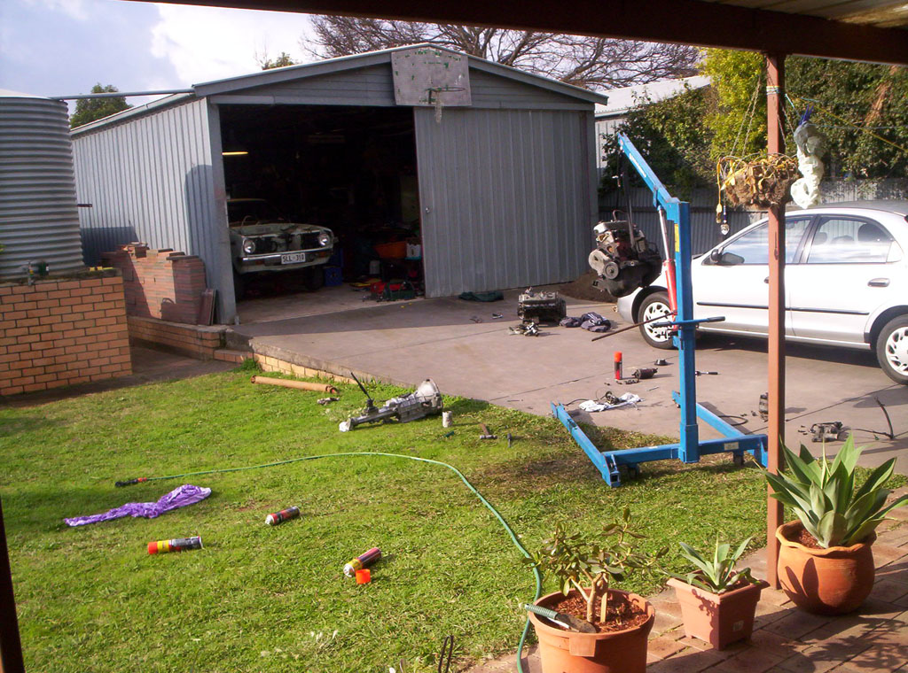

Raven Posted June 2, 2006 Author Report Posted June 2, 2006 (edited) Engine Removal Pics Good ol' ROL-110 was awesome enough to sell me a short motor fairly cheaply. So when I pick that up tomorrow, I'll fix a few gaskets and then pop the engine back in. So here's a few engine removal pics after 30 mins work. Edited June 4, 2006 by AE35 Quote

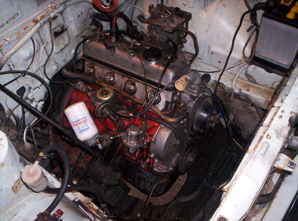

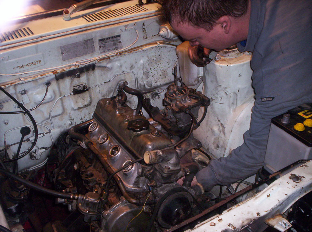

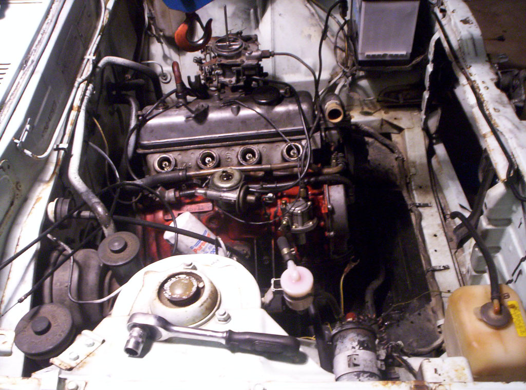

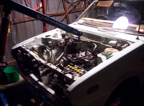

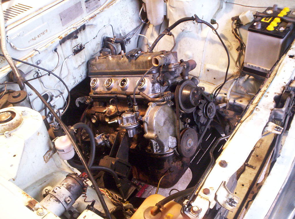

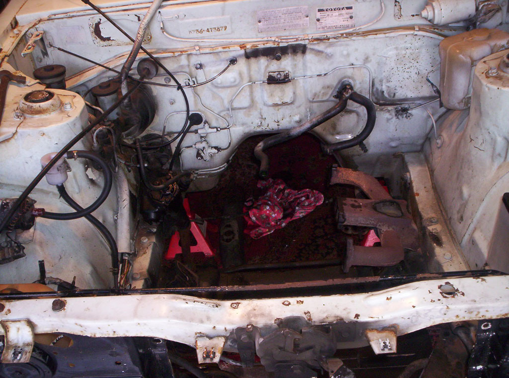

Raven Posted June 3, 2006 Author Report Posted June 3, 2006 (edited) Engine Swap and Install Pics *Thats Mr. Faulksy in those pics giving me a hand too* Well, I got the 4K in, bolted everything back together and it wont start. Don't ask me if I've checked the order of the leads and made sure Piston 1 is at TDC, because I've checked all that. AND To top it all off its pissing oil out of an unknown location. Who wants a freakin' panel van? Edited June 4, 2006 by AE35 Quote

Raven Posted June 6, 2006 Author Report Posted June 6, 2006 Success! After lining up the oil pump (so the dizzy was in the right spot), it started with a little bit of coaxing, I timed the engine and now I just have to fix the oil leak (which is coming from the oil filter bracker). Once all that is done, I'll save a bit of money and put the 3K head on the 4K block and maybe regrind the cam and get a 32/36 weber and extractors for it, then a sports exhaust. Quote
