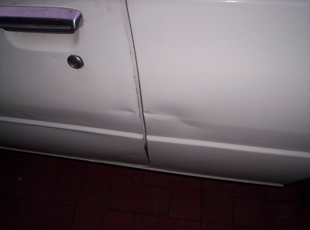

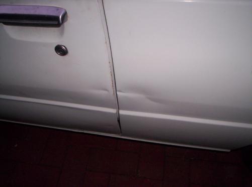

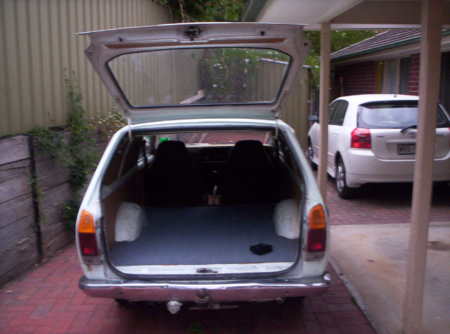

What needs to be done:
* Engine Swap
* Roof lining has collapsed at the rear
* Dented Passenger door
* Both front guards have dents/ripples
* Hinges dropped on both front doors

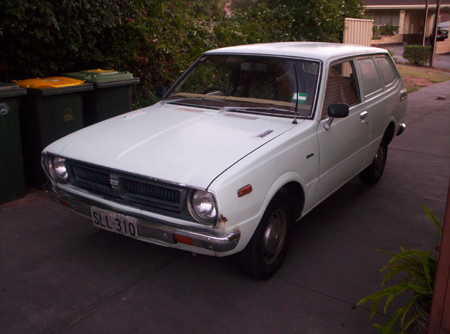

Update *1*

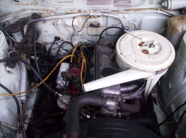

Ok, i've got the car home. I managed to get it started and drive it onto the trailer so no winching required and it started first pop when i took it off the trailer, running on 2 and sometimes 3 cylinders.
Anyway, i drive it into the driveway and pop the bonnet. Check all the leads and distributor cap and notice cylinders 3 & 4 arent firing and that the dizzy contact points are corroded and the rotor button is dirty. So i clean up the rotor button.
So, i start it up and it starts running on 3, so i pull the choke out and it sounds like its running on 3 all the time so i give it a rev and voila, its running on all 4.
I check the radiator, No oil in the water. Check the oil cap, its not milky.
Go around to a mates shed and degrease the engine and pull the leads off the dizzy. Number 4 lead is stuck in the dizzy. So i pull it out and its corroded heaps in there.
So yes Valandor, it was an electrical problem.
It needs a tune and tappets adjusted but other than that its all sweet.
Pics will be up later tonight.
