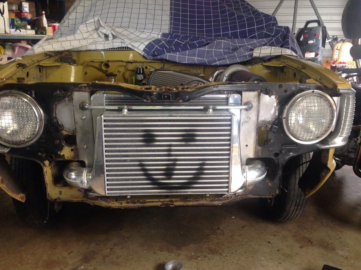

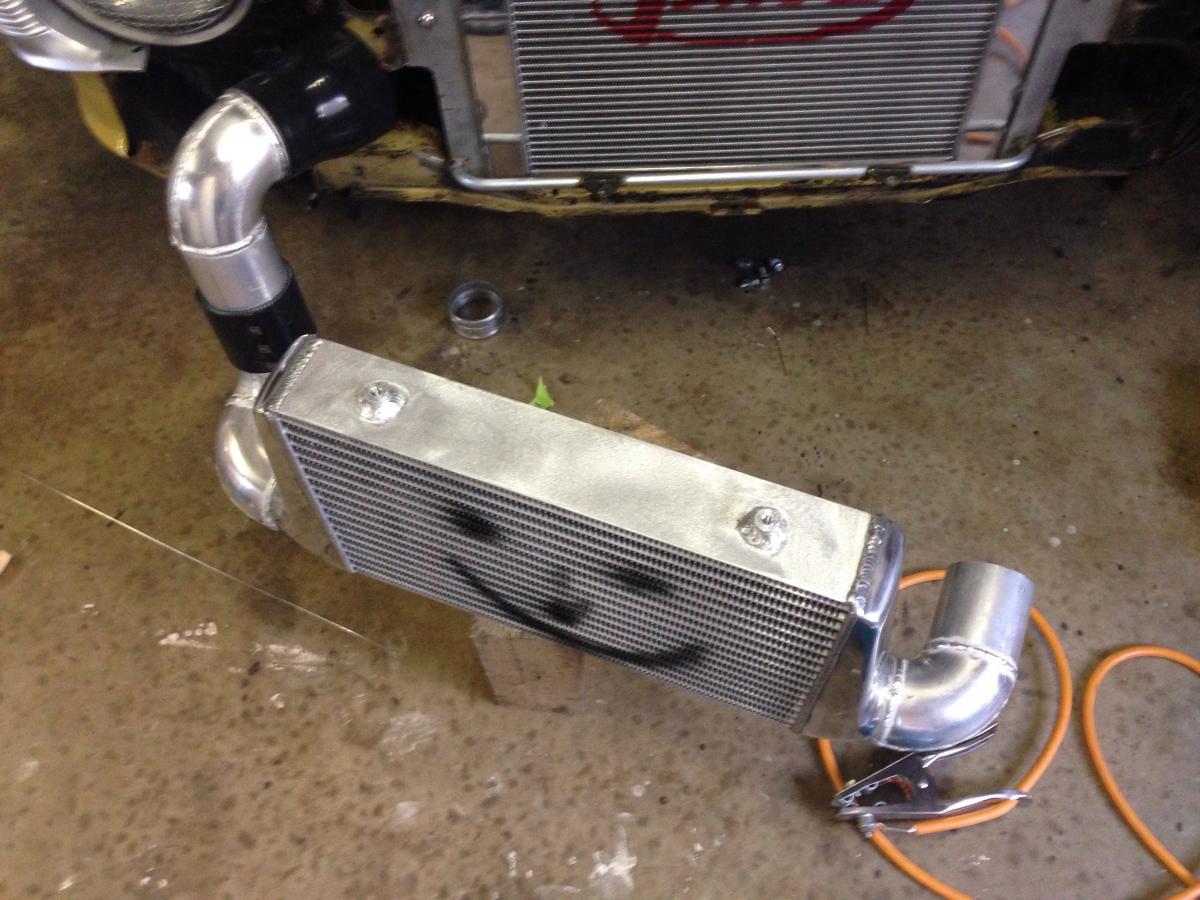

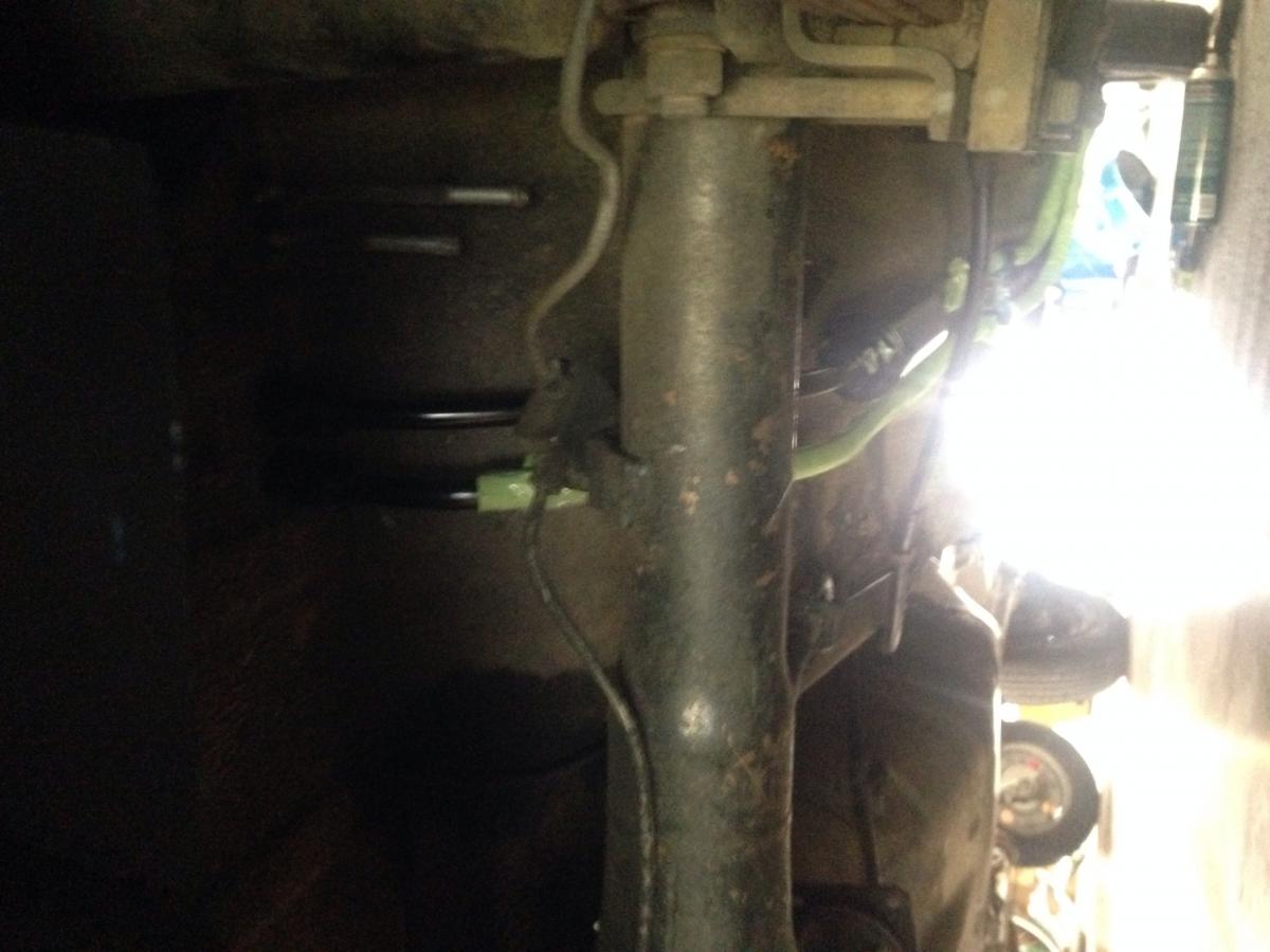

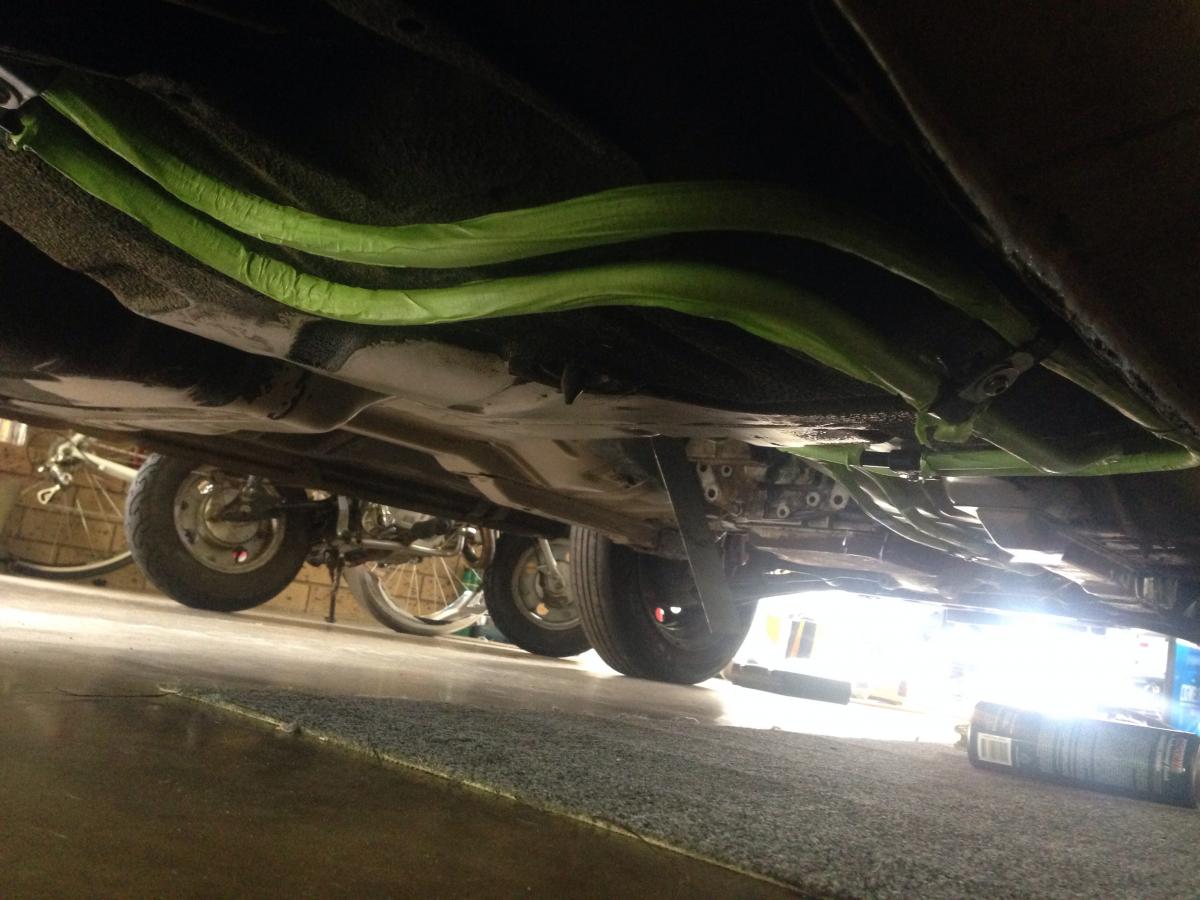

grundle84 Posted February 12, 2014 Author Report Posted February 12, 2014 Got few hours this week to work on it so bent up the hard fuel lines under car fri back to front and fitted the main fuel filter, made some small u shape brackets I cut from bit of 50x25 rhs and welded nut to it so I didn't cut or drill through floor. Also welded up alloy donut and cut and welded it to intercooler to get it all to fit nice, just need to finish off I engine bay. Quote
grundle84 Posted February 12, 2014 Author Report Posted February 12, 2014 Really hard to see the whole fuel line setup under car but use your imagination, green masking tape around lines just cos they anodised black ones and didn't want to scratch them yet. Quote

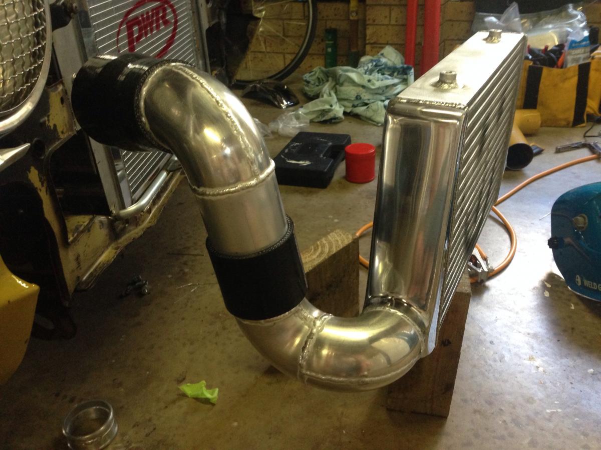

grundle84 Posted February 16, 2014 Author Report Posted February 16, 2014 Another intercooler piping weld job pic. Just for others ideas Quote
