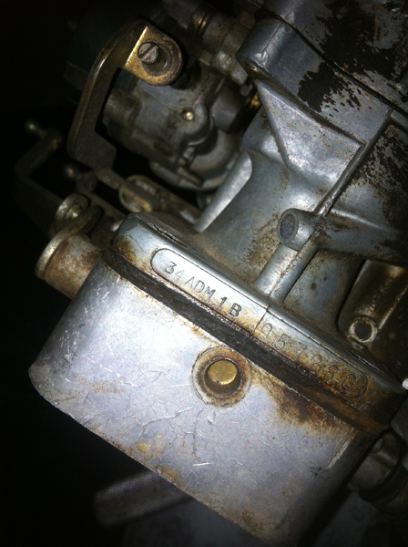

and my ADM 34:

This is the carbie adaptor for the 32/36 which doesn't work for 34adm... still waiting on longer studs to arrive, gonna bust a nut soon. Also thinking about running dual asains and making a manifold.. probably just a pipe dream though ( get it?)
