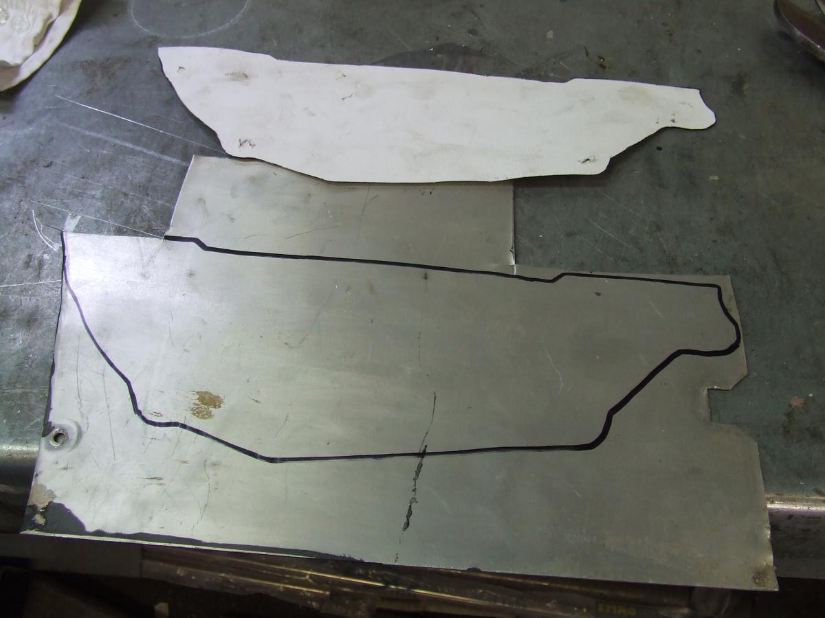

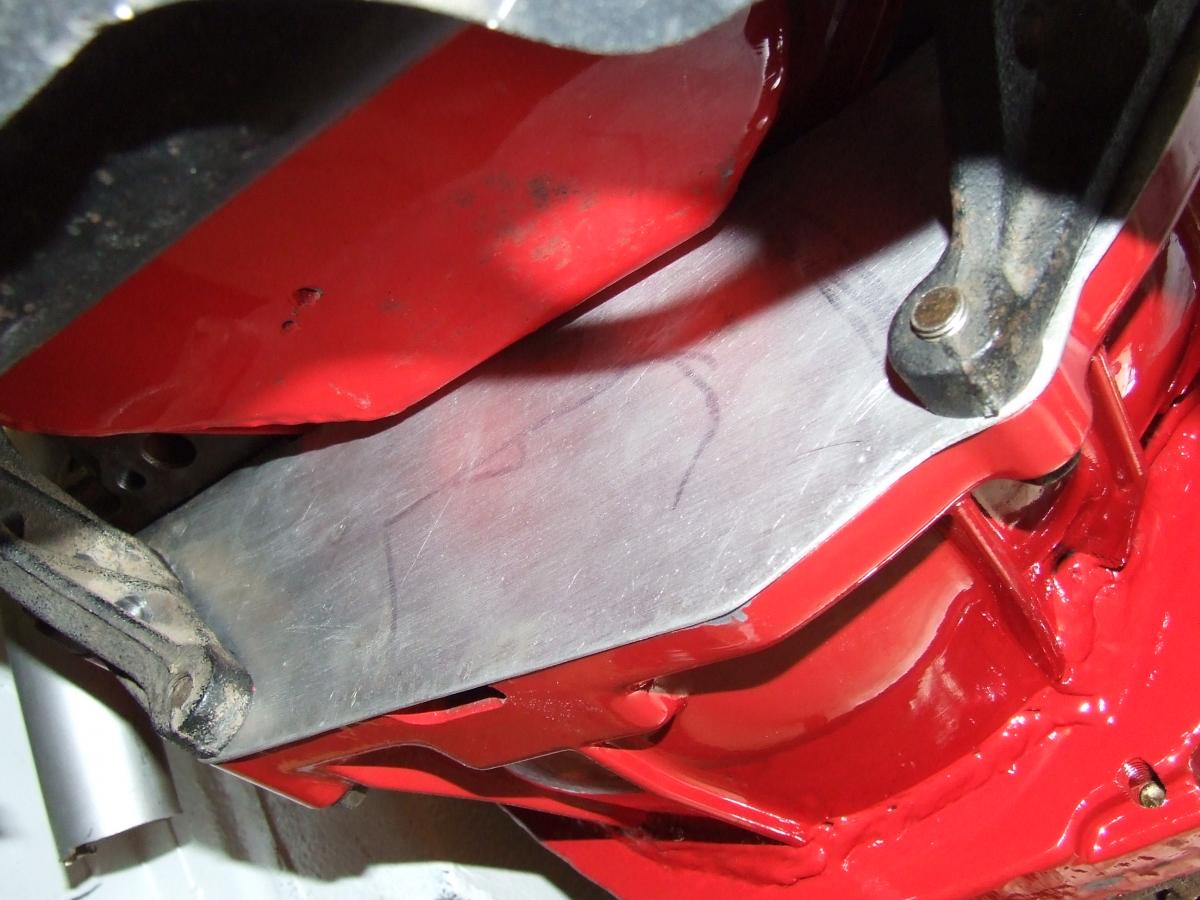

supra2 Posted May 27, 2014 Author Report Posted May 27, 2014 (edited) Hey Justin, Ive already sold a few but I have a spare sitting in the mold if your interested. You stole my IRS idea so I figure we're even.LOL ;) Made an alloy flywheel cover. Edited May 27, 2014 by supra2 Quote

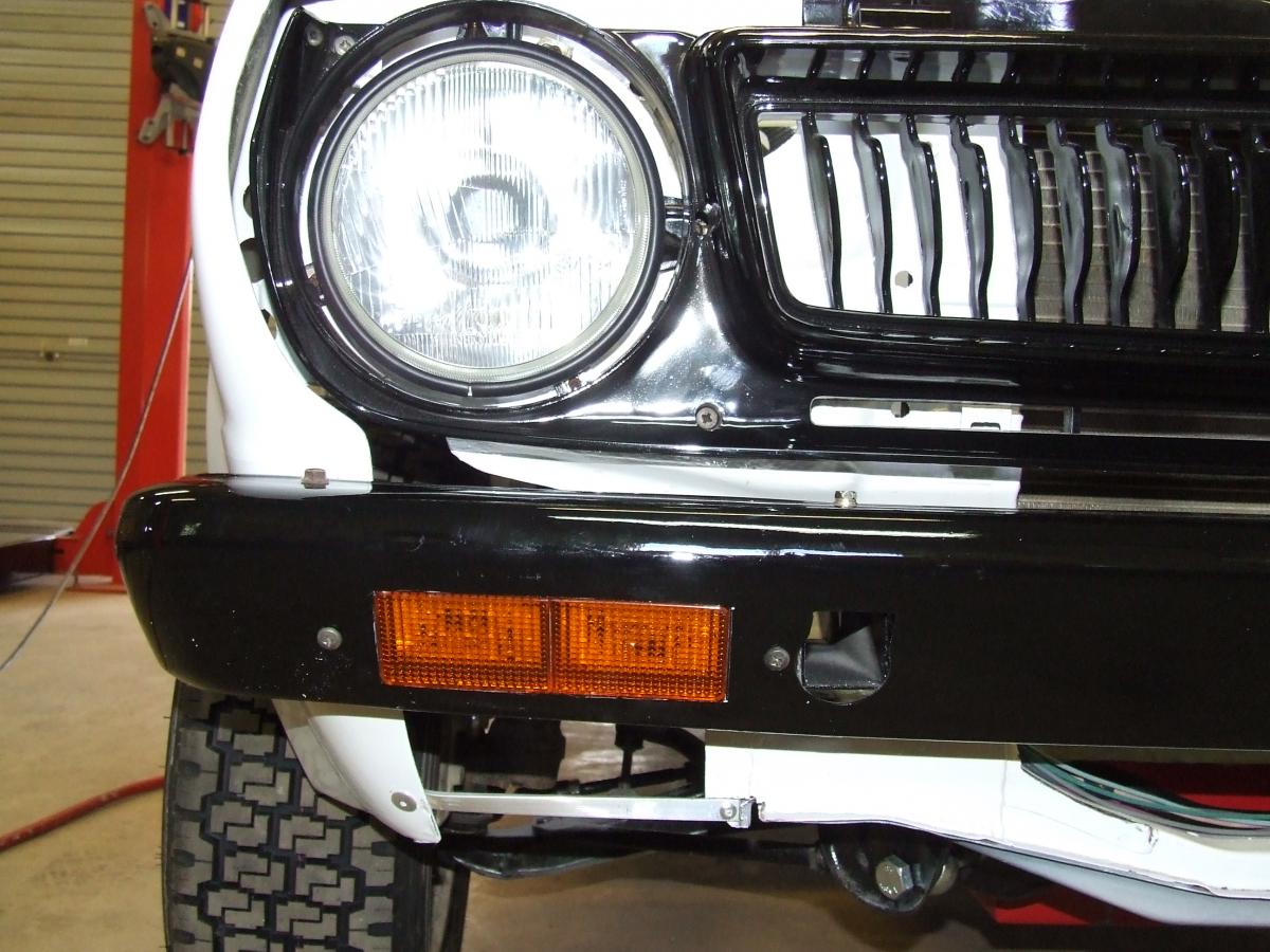

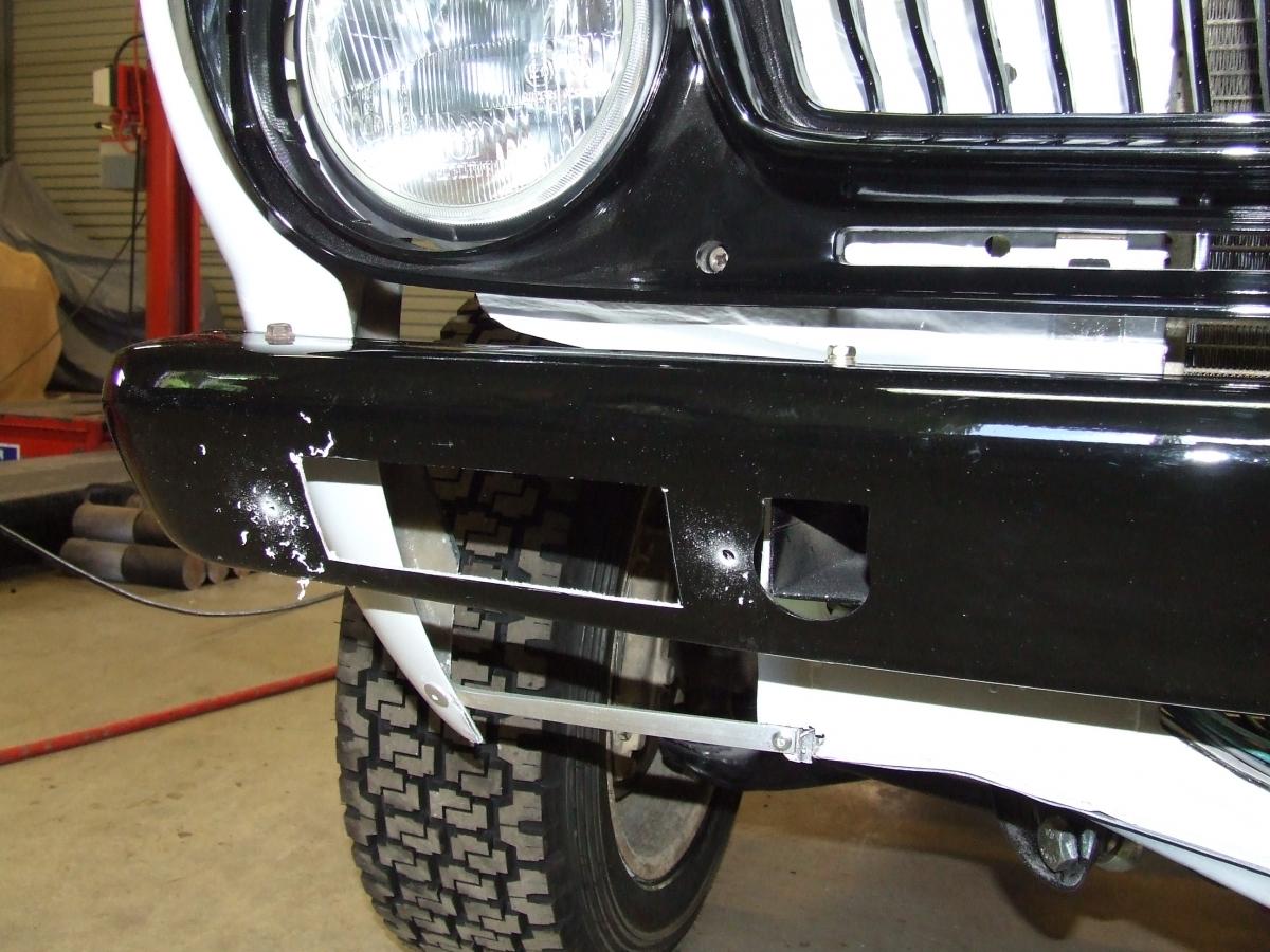

supra2 Posted May 29, 2014 Author Report Posted May 29, 2014 Its all good. Got the front indicators fitted in the bumper. Quote

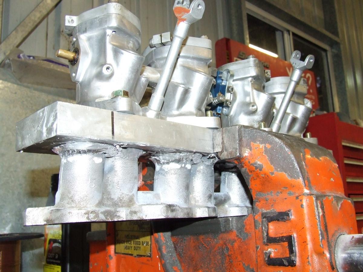

supra2 Posted June 3, 2014 Author Report Posted June 3, 2014 Thanks Stephen and Stuart. Not much photo worthy stuff happening at the moment. Got the clutch hooked up and working and some more wiring done. Started making the inlet manifold. Ill get some more photos up soon. Quote
Taz_Rx Posted June 4, 2014 Report Posted June 4, 2014 So are you not running a front stone tray? Quote

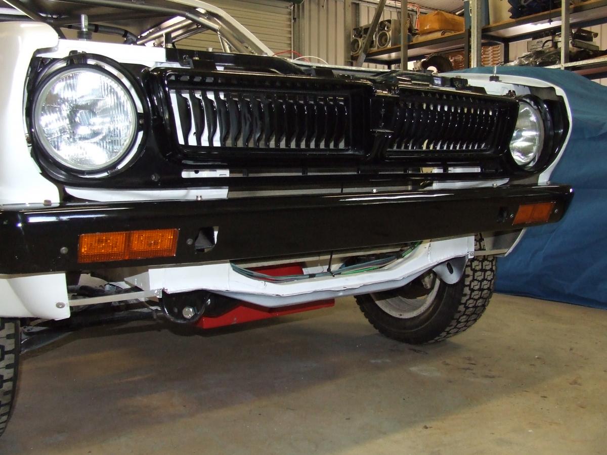

supra2 Posted June 6, 2014 Author Report Posted June 6, 2014 Hi Si. Yep it will have a front valance under the bumper. Hope to get on to that this weekend. Quote
Taz_Rx Posted June 6, 2014 Report Posted June 6, 2014 Another fibre glass item I'm guessing? Half rolla, half Corvette lol Quote

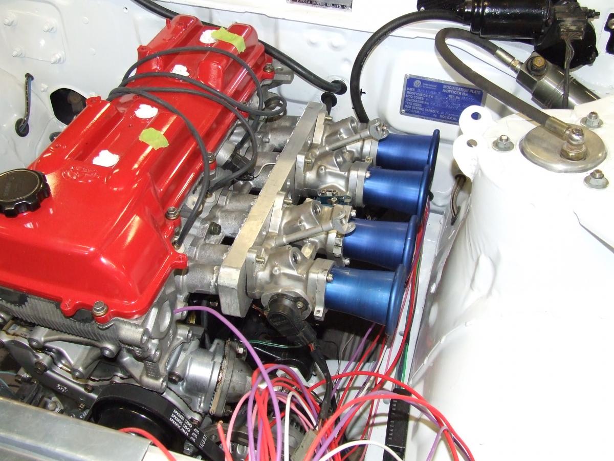

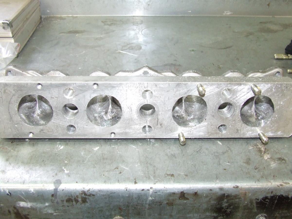

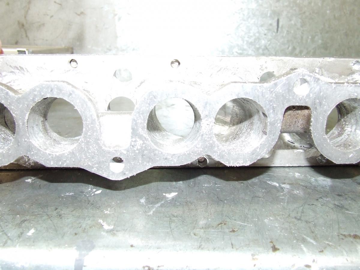

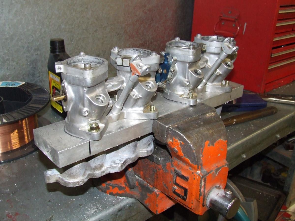

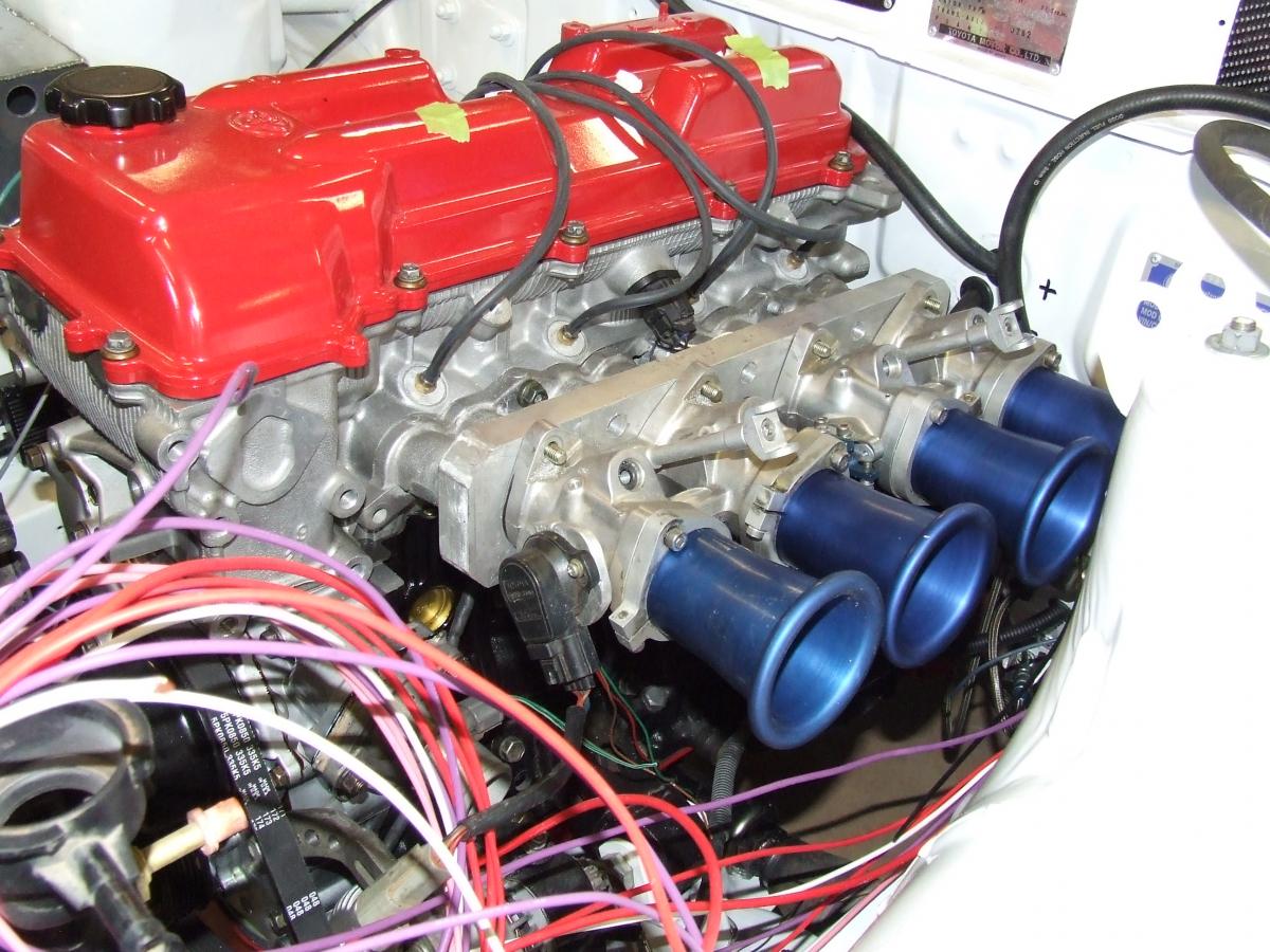

supra2 Posted June 7, 2014 Author Report Posted June 7, 2014 Ill be using the plastic one from a RA60 Celica. Still have a couple of spares. Making an inlet manifold to suit the quad throttle bodies. Quote

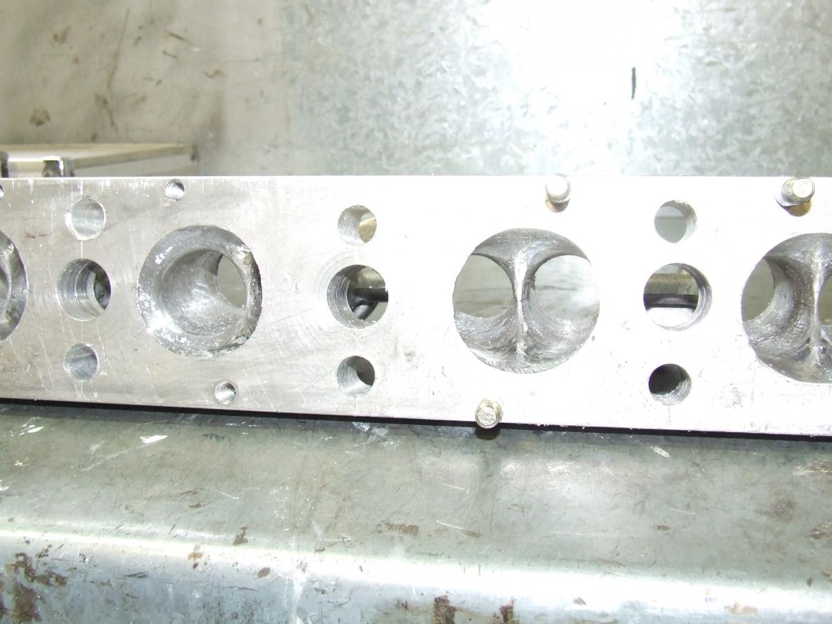

supra2 Posted June 10, 2014 Author Report Posted June 10, 2014 Porting the adapter plate on the modified manifold. Quote

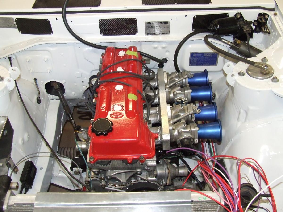

supra2 Posted June 11, 2014 Author Report Posted June 11, 2014 Intake manifold fitted. Ive looked at a lot of air filter and air box set ups and none will fit in the space thats left in the engine bay. So its back to the good old filter socks. ugh. Should make a nice noise in the forest. 1 Quote
Feral4K Posted June 11, 2014 Report Posted June 11, 2014 (edited) MMMMMM INJECTION!!!!!!!!! Edited June 11, 2014 by Feral4K Quote
