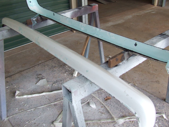

supra2 Posted March 10, 2014 Author Report Posted March 10, 2014 First bumper out of the mold. Weight= 750grams. Will be close to 1kg with some mounts. Quote
