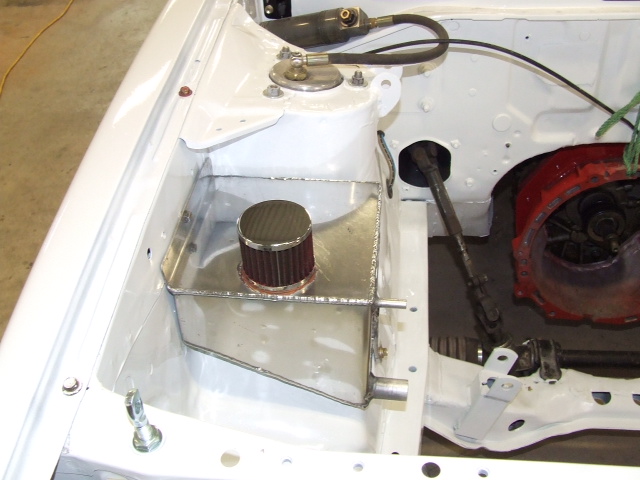

supra2 Posted February 20, 2014 Author Report Posted February 20, 2014 Thanks Ryan. New catch can/ engine breather fitted. Quote
