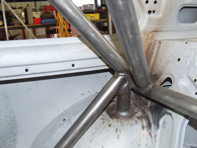

What's with the little stubby leg in there ? is that because the stays coming rearwards from the base of the main hoop would have clashed with the wheel arch if they went straight back to the node ?
Thanks Reed.
Hi Mika.
The small stub tube is a bit hard to explain why, I just felt the car needed it.
Main reason is because the car now has rear strut towers transfering load into the rear fire wall.
The Corolla steel is quite thin gauge, even with the 3mm plates, it just needed the load to be spread over a larger area to help reduce flex.
