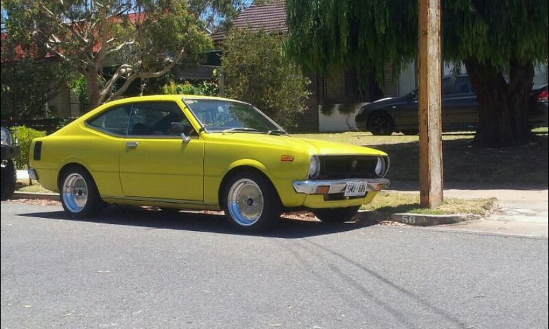

back in march last year i bought a ke35 coupe with a 4age in it. it had been sitting in a shed for the last two years. when i got it the master cylinder had ceased and only the rear brakes were working. made it a very interesting drive home.

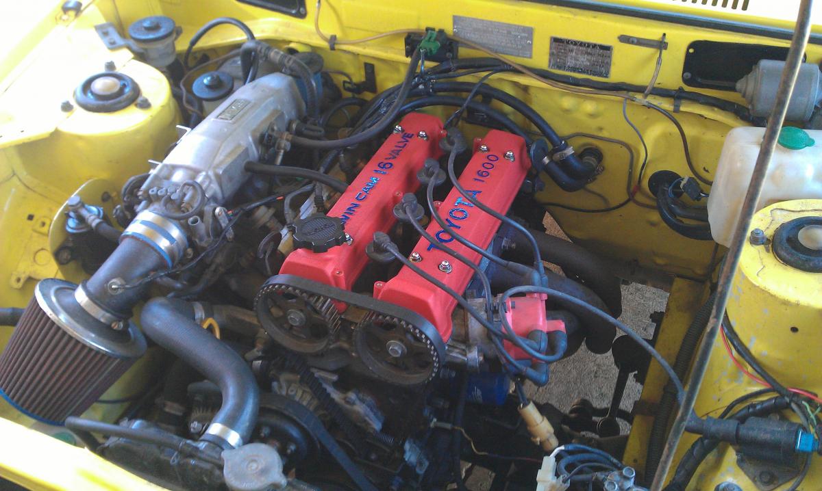

here are some of the specs on it when i got it
Yellow 77 ke35 coupe (last of the 35's so it has a ke55 dash in it)
AE86 rwd bigport 4age with t50
haltec e6m computer
RA40 front struts with the crossmember dodgy drilled out for more camber.
14X6 super lights

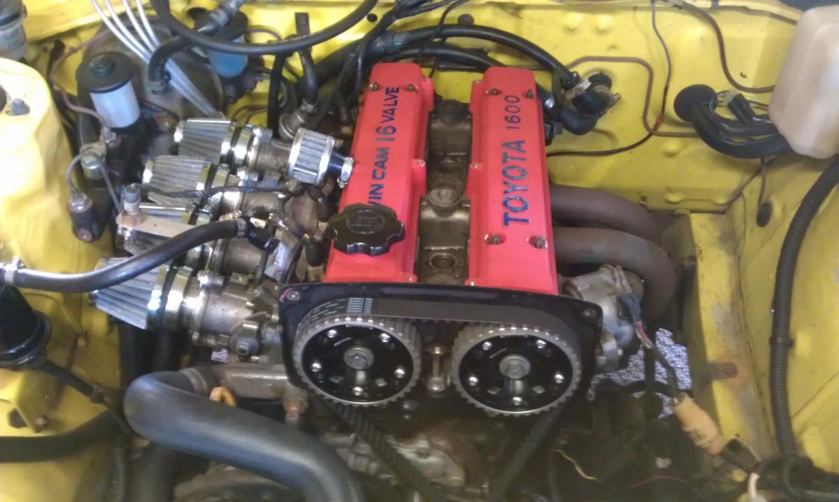

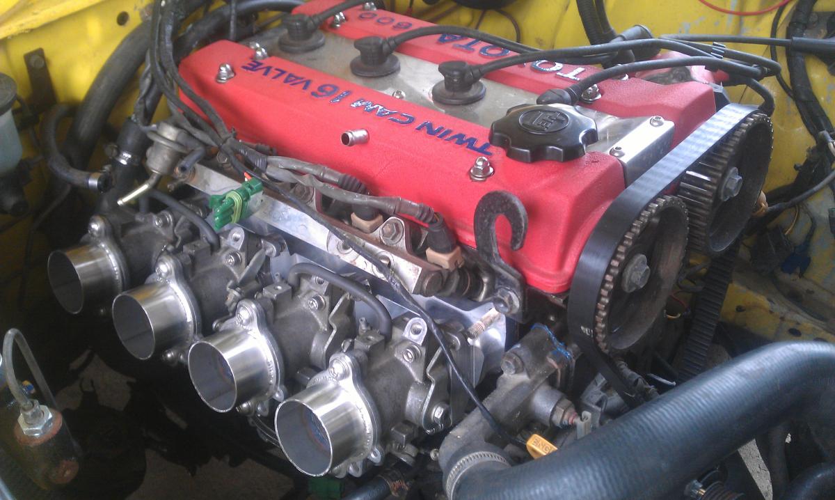

Before i had bought this car i had purchased a set of silver top 20valve quad throttle bodies on a t3 bigport manifold and I was gonna make a manifold to suit k series motor and go all out on one. Any way when i bought this thing i put them on after a 3 months or so of having it. I decided I wanted cams as well so I bought a set of crow 277 degree cams to suit. With the cams and quads it made 75rwkws on a mainline dyno with a ignition break down.
the best thing about it is the noise that it makes either a deep gargle like webbers or it screams pretty damn loud when your right on it.

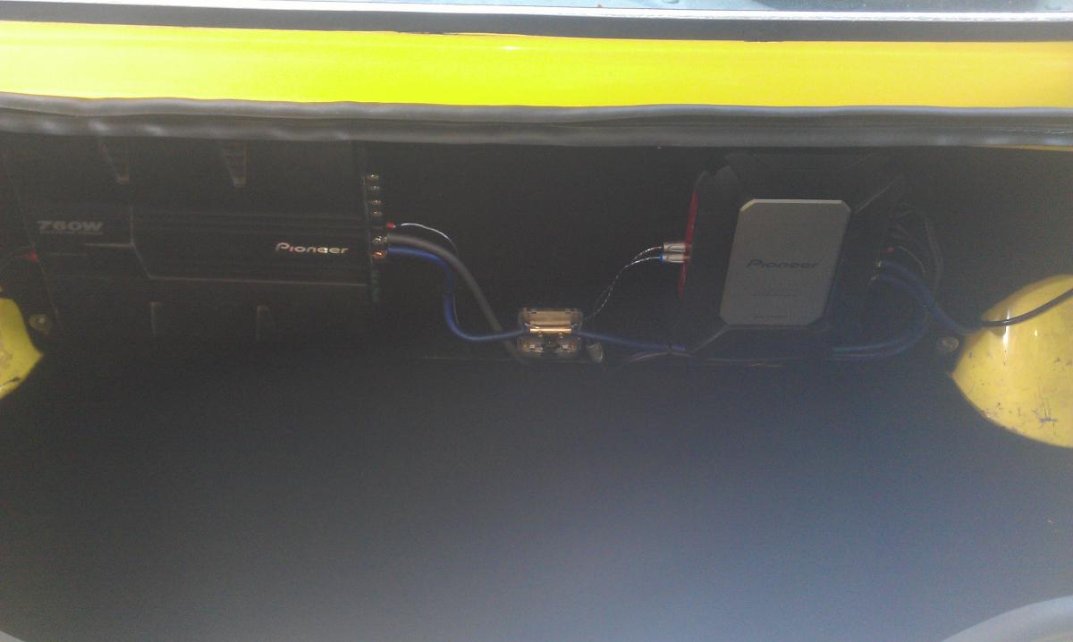

Also during the time the car was off the road having the cams fitted and waiting for it to be tuned i carpeted out the boot and fitted a sterio to the car and bought the set of coilovers out of slo30's ke38 wagon.When fitting the coil overs i discoverd the mess that some one had made with the crossmember so that got swapped at the same time.

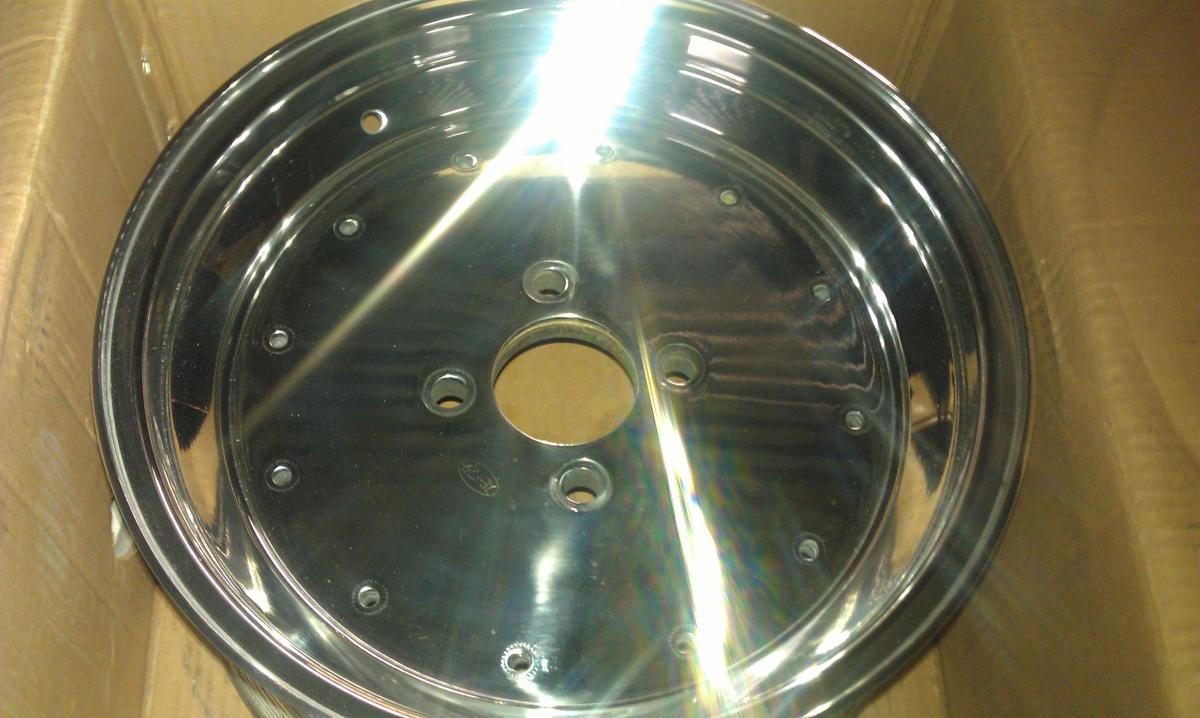

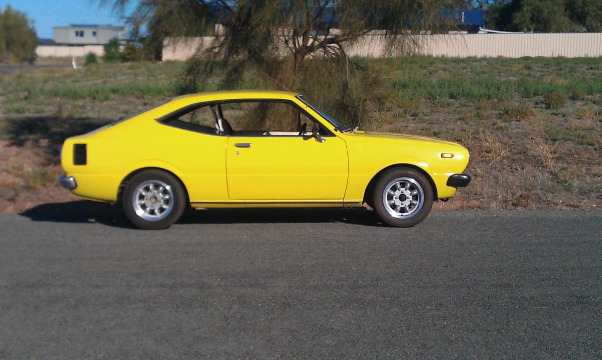

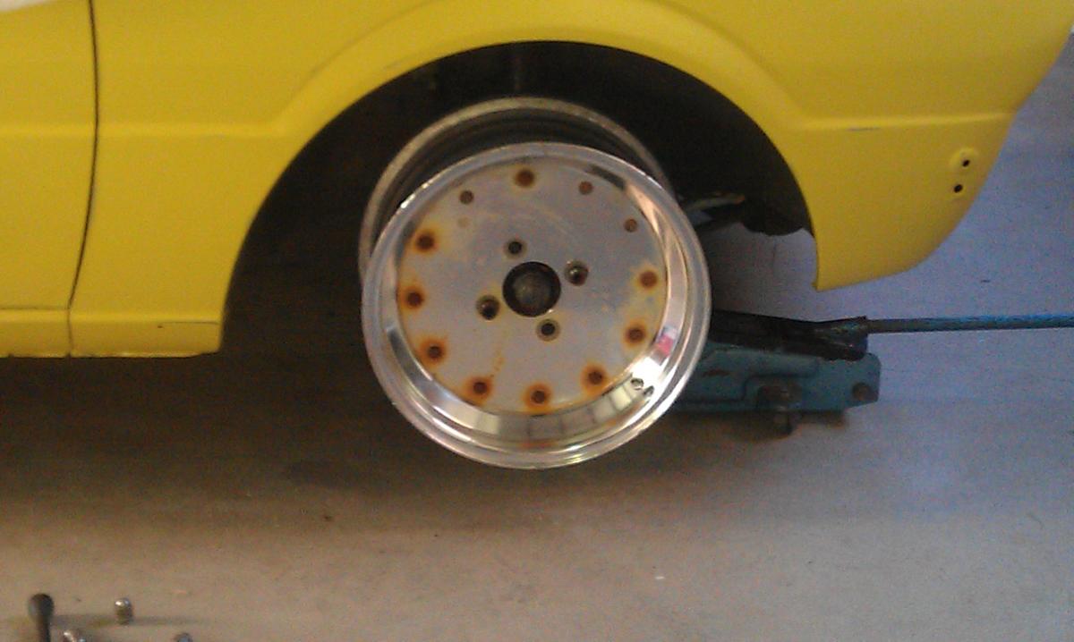

I wasnt a fan of the super lights ever since i got the car and one day looking through the otomoto wheels page i found a set of ssr MK1's in 15X7 +12 pretty cheap so they became mine pretty quick. Once i got them they were sent off to the polishers due to the being rusty around the bolt holes, then fitted with some 195/50R15 Khumo KU31's
other little things i have done to the car is nardi wood grain steering wheel, trd leather shift knob and a fixed back seat.
