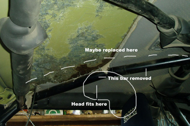

Boosted Posted January 5, 2013 Report Posted January 5, 2013 Nice write up, perhaps a few things need to be clarified though, eg cutting out the diagonal bar in the roof of the rollcage. Quote
altezzaclub Posted January 5, 2013 Author Report Posted January 5, 2013 (edited) The cage was built too low for a guy well over 6foot with the frame to match, his head was jammed in between the side rail above the door and a diagonal bar that went from the main hoop to the front corner by the windscreen. I mean his HEAD was jammed, that's without a helmet! The only way to get room was to cut that diagonal out, which is part of the over-built system CAMS wants in the national series cars, so he can't do CAMS Nats like it is.... meh- big deal, there is plenty of rallying to do without that. I want to slice all the feet off the whole thing and raise it up 50mm hard against the roof, then we can replace the diagonal while leaving some head room. Meanwhile, the weeks slip away while the girlfriend is on holiday and the RA40 sits neglected.... Edited January 6, 2013 by altezzaclub Quote
