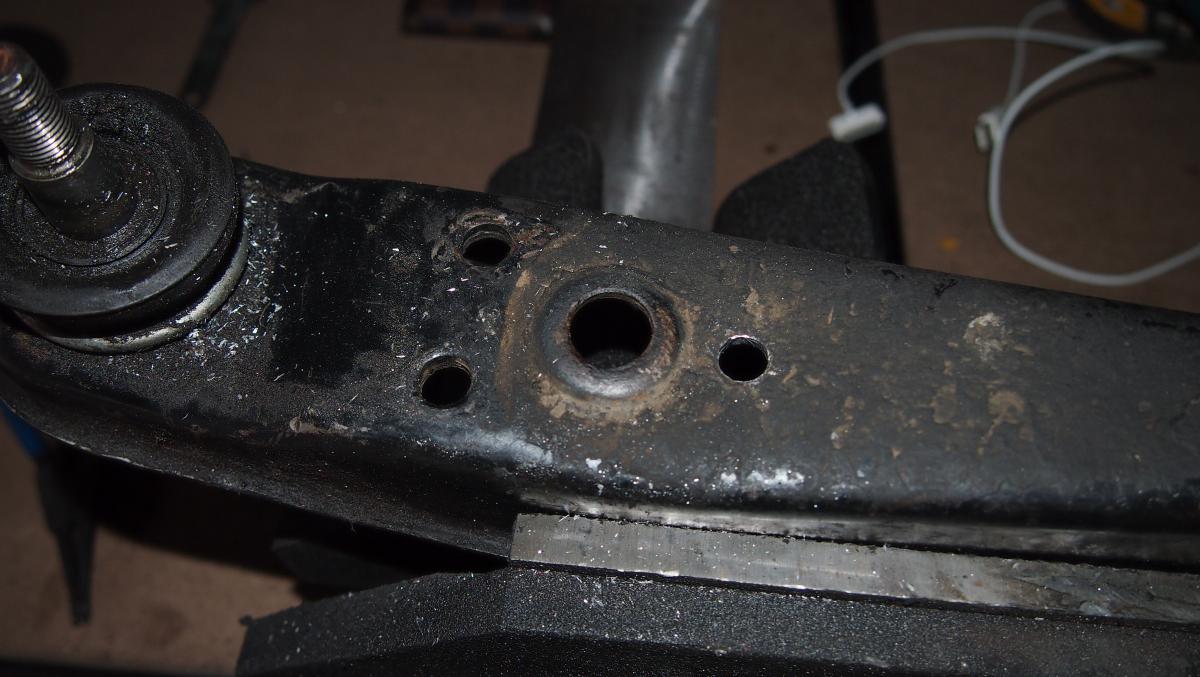

me!!! Posted December 15, 2012 Report Posted December 15, 2012 Hey all! I've just been test fitting a bunch of parts I got for my old KE70 I got some S15 coilovers (same as s13) with AE86 camber tops fitted On S13 "JDI track spec extra lock knuckles" with nonTurbo brakes (smaller) And R31 Control arms (because they're a bit shorter then S13) I have done some searching but not finding heaps on the use of R31 arms, so, anyone thats used them, some questions; Firstly the rackend/tube/tierod como; I have read for S13 arms you'd use Bluebird TRX tierod ends and RA60 Rack ends, I suppose the TRX option is so the stub part fits in the S13 knuckle or something, right? And since the R31 arm is shorter, will this combination still be the right length? Or what about RA40 tierod and RA60 tube? What would people recomend? And I have fitted the coilovers, knuckles and arms no problem, but the swaybar link is at a retarded angle, like the hole in the r31 arm is too far in (toward car center), Others got the same problem? Just Drill another hole? I'm aware caster rod holes must be drilled, don't recall hearing about the swaybar though. I can get pictures if necessary. Any info/advice/links ect much appreciated, thanks all! Quote
NinjaMekanik Posted December 15, 2012 Report Posted December 15, 2012 (edited) On 12/15/2012 at 1:59 AM, me!!! said: And I have fitted the coilovers, knuckles and arms no problem, but the swaybar link is at a retarded angle, like the hole in the r31 arm is too far in (toward car center), Others got the same problem? Just Drill another hole? I'm aware caster rod holes must be drilled, don't recall hearing about the swaybar though. just redrill it mate. did the same thin on my ke55 when i put sigma LCAs in. the standard sigma hole was too far out. EDIT: not sure what the go with the picture there is... wont embiggin. you get the idea though .... Edited December 15, 2012 by NinjaMekanik Quote

me!!! Posted December 15, 2012 Author Report Posted December 15, 2012 On 12/15/2012 at 2:05 AM, NinjaMekanik said: just redrill it mate. did the same thin on my ke55 when i put sigma LCAs in. the standard sigma hole was too far out. Yeah, seams pretty fair, thanks pal. On 12/15/2012 at 3:06 AM, irokin said: False! There are a few small but critical differences. Probably the most critical is the bolt diameters, IIRC S13 is 12mm and S14/15 are 14mm or something to that effect. Yeah, your right, the S15 are 14mm, but thats not a major issue. Still wondering about the steering side of things... Can I just use RA40 tierod and RA60 tube? RA40 tierods fit in the s13 knuckles? The ke70 ones seem to fit fine, so I guess RA40's should too... Just need more length. Quote
