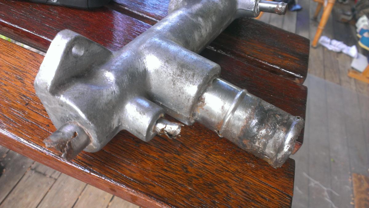

ke70dave Posted December 31, 2012 Author Report Posted December 31, 2012 So a small update and a question for the board. playing with my newly aquired christmas present, that orange drill, i got enthusiastic and bought a wire wheel and had a bit of fun. now onto the problem. Does anyone reckon that a radiator shop will be able to sell me those steel inserts? they look like a standard size. And what do we think of this? This is where an o-ring sits and it sits inside the water pump housing. I'm wondering if i can just get that crack brazed. Quote
Trev Posted December 31, 2012 Report Posted December 31, 2012 If they can't sell you a pipe section then get someone to machine up a bit of aluminium pipe and give it a weld once it is pushed in, you should also be able to fix that o-ring section. Quote

ke70dave Posted January 6, 2013 Author Report Posted January 6, 2013 Right well this car is turning into a right pain in the ass :P parts replaced and work done so far: -head reconditioning, all top end gaskets replaced (VRS kit) -new radiator ($290.....) -fixed coolant pipe behind water pump (the one in the previous photos, i ended up fitting some copper/brass hose fittings in place of the rusted pipe) -new radiator hoses and hose clamps -new overflow bottle -new small steel water pipe near radiator -new radiator cap -rebuilt front diff with new seals and new grease and oil (like $300 here :S) -new spark plugs -new rubber things that stop the doors from flying open -oil/oil filter Around $1200 in parts/fluids so far, head reco costing ~$475 incl vrs kit. All new stuff, no wreckers part. Bolted it all back together on saturday got to the point of putting the airbox thing back on, fill it up with water, and water is pissing out the water pump weep hole!!! So ordered a new water pump on Saturday, it will arrive tomorrow hopefully ($46 incl express postage). Half pulled it appart but got annoyed so gave up! I have pretty much replaced or fixed everything in the coolant system....this is why you use coolant and not water! Maybe this weekend i will get it running :) Oh i need to track down a radiator shroud, found one for $39 plus post. So might get that if i can't find a second hand one for reasonable price/location. Total current cost is $3400 incl purchase of car itself. expected another $300 on brakes and misc other bits for RWC (brakes kinda don't work at all). there is a leak on either the gbox or transfer box (there is oil everywhere....), but ill degrease the hell out of it soon and see if i can pinpoint the leak. So probably close to $4000 when I'm done. which sounds expensive, but alot of the cars for sale are asking $4500 and sound like they need a bit of work. Good news is it will be a brand new engine (from the headgasket up) when I'm done. Let the fun continue, proposed camping trip to bribie island as soon as i finish, so i has a goal to work towards! Quote
