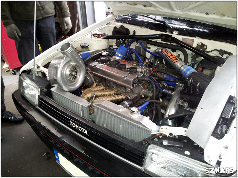

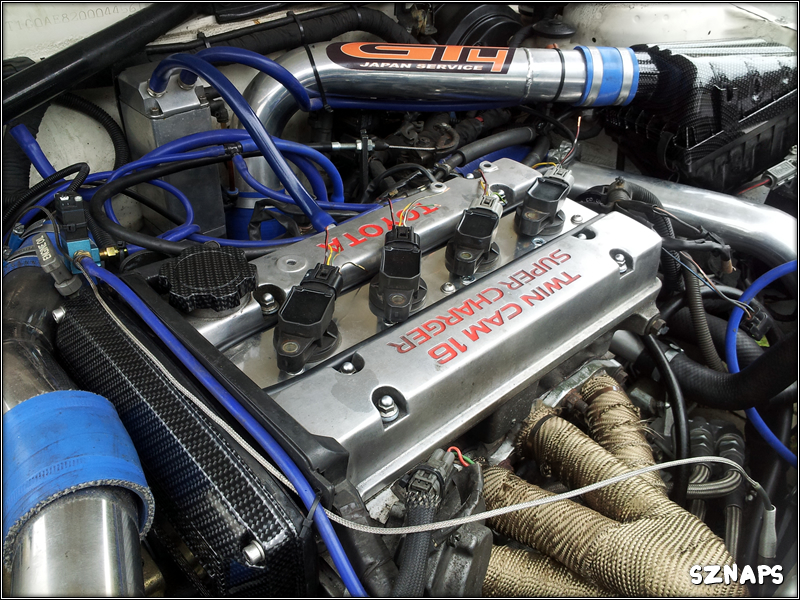

Sznaps Posted August 6, 2013 Author Report Posted August 6, 2013 I am going to install bypass valve so the twincharged system can show full potential by breathing freely in high rpms. I found a perfect candidate for the switch - Nissan Maxima 3,5l v6 throttle body. Its an electronic one and seems to be working just fine for my needs. Quote
Sznaps Posted September 16, 2013 Author Report Posted September 16, 2013 (edited) I removed oem 4agze dual coil packs and i am in progress of installing these sweet independent ignition coils. Also bypass valve fully operational hopefully also will be completed this week. Edited September 16, 2013 by Sznaps Quote
Skellington Posted September 17, 2013 Report Posted September 17, 2013 I like the bypass idea. please post more of this if you end up using it. independent ignition coils look sweet. Are they from a newer corolla? 2007ish? Quote
Sznaps Posted September 19, 2013 Author Report Posted September 19, 2013 (edited) yes the ones I'm using are Toyota coils made by Denso No. 90080-19021 (these particular ones are from Yaris model I think) Edited October 22, 2014 by Sznaps Quote

Sznaps Posted October 3, 2013 Author Report Posted October 3, 2013 (edited) ok bypass valve and coils ready. Waiting for ecu adjustments. can't wait ;-) Fingers crossed. Edited October 3, 2013 by Sznaps Quote

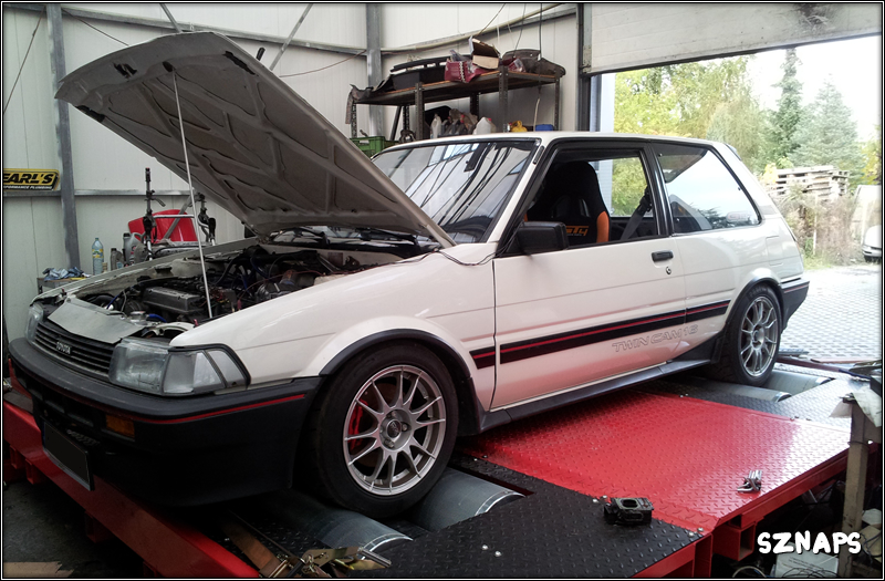

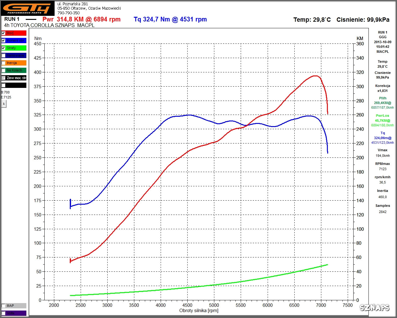

Sznaps Posted October 11, 2013 Author Report Posted October 11, 2013 A taste of things to come (unless we blow up something). Soon the twincharged tuning with workingbypass valve. The target max boost is 1.3. Just out of curiousity we did one run with just turbo with bypass valve wide open on 1.6bar boost. Anyone curious about the result? Quote

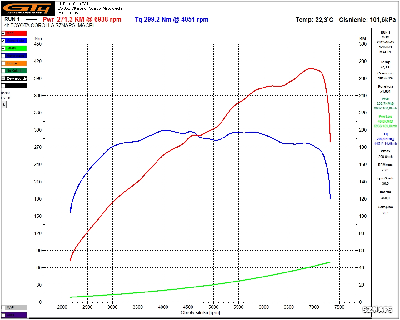

Sznaps Posted October 12, 2013 Author Report Posted October 12, 2013 Allright guys the setup received bypass valve which opens when supercharger is disengaged and lets turbo breath freely with nice cold air through second intake. We have tuned it and I have let myself have lots of runs today. Got few things to share when I manage. But lets start with numbers. We made test run on just turbo with bypass valve constantly open so supercharger is not used. The run was on 1.5b because we were curious what the numbers would be with higher boost. But also we can compare the characteristics of just turbo to twincharge system on same engine. If you look at charts below you will notice that twincharge simply has torque line plain and stretched throughout all rpms when compared to turbo. Also what is not visible on charts - in twincharge setup you have boost everywhere and whenever you want. But lets get to the point. How it was - twincharge - 1.2b - turbo sucks constantly through supercharger (engaged and later on disengaged) How it is now - twincharge - 1.2b - turbo sucks through supercharger but when its disengaged bypass valve opens and turbo sucks nice cold air though second intake. Impressions - Its better :-). Without bypass valve when turbo was getting over disengaged supercharger I could feel dip in power. Not much but there was and even the top rps were good I knew it could be better. Now its like lift or vtec engaging. As a bonus there are cool sounds when bypass opens. When it opens and supercharger still spins you can hear for a moment whats happenning inside intake. It sounds a bit like plane hiding landing gear. Got some recording of that wanna hear? :-) Quote
Taz_Rx Posted October 12, 2013 Report Posted October 12, 2013 Bring on the vids. What unit is the power in? KM? Quote
