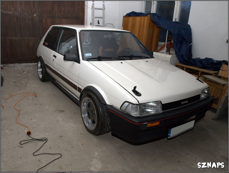

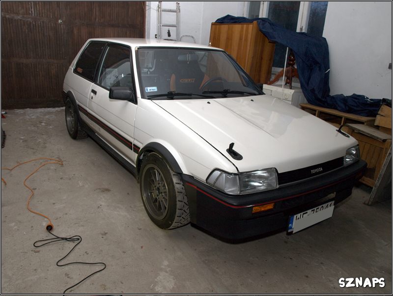

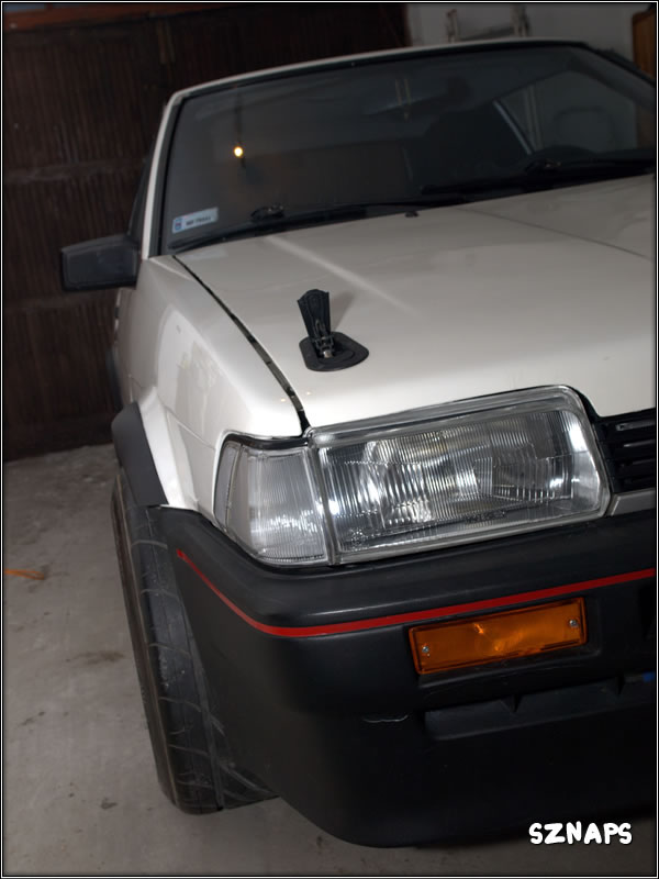

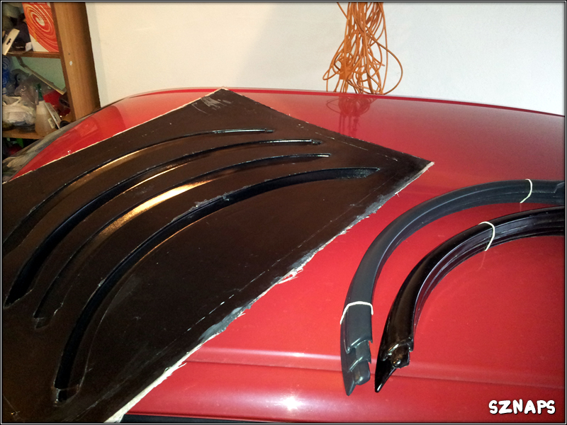

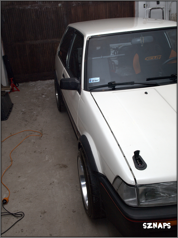

Sznaps Posted January 13, 2013 Author Report Posted January 13, 2013 Got three news: 1. I have weighred the car to see how mass is distributed and: front is 645 kg and rear 339 kg. So quite normal for FWD 2. I am going to make fibre glass fenders. Have already took one off to make mold 3. The looks of my rolla is still bugging me in a way. Especially since Subaru_kid posted these picks of his rolla on BBS wheels :-) I have borrowed 15x8 et 0 Zender rims with 195/50 rubber from my friend to see how it would fit to current setup: Currently - 15x7 et 13, 185/55: On borrowed 15x8 et 0, 195/50 I am thinking that if I decide to go that way I would mount 15x8 et 25 rims with 195/50 rubber. Rims would be different than these zenders. I am thinking more about some BBS RM like with polished lip and dark middle. Few more pics: What do you guys think? Is this the way to go? Quote

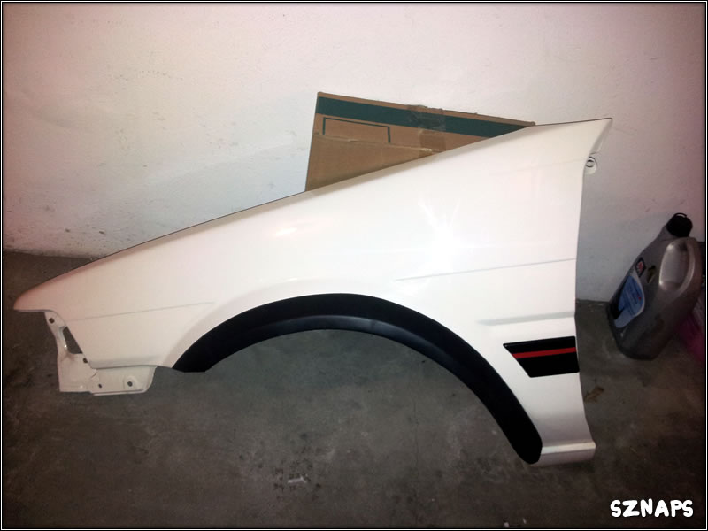

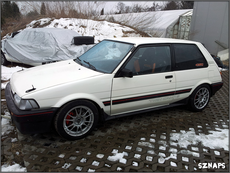

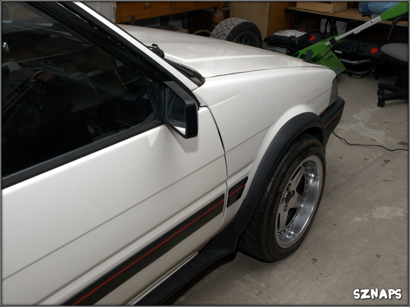

Sznaps Posted March 29, 2013 Author Report Posted March 29, 2013 Winter does not want to leg go but I got her out from garage. I got back to previous OZ wheels and lowered suspention a bit. Going back to OEM look - oem fender flares already wait to be installed Quote
azza91 Posted March 30, 2013 Report Posted March 30, 2013 how are the fibreglass fenders coming along? Quote
