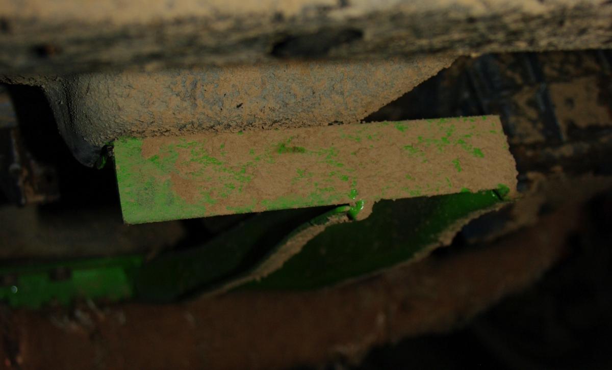

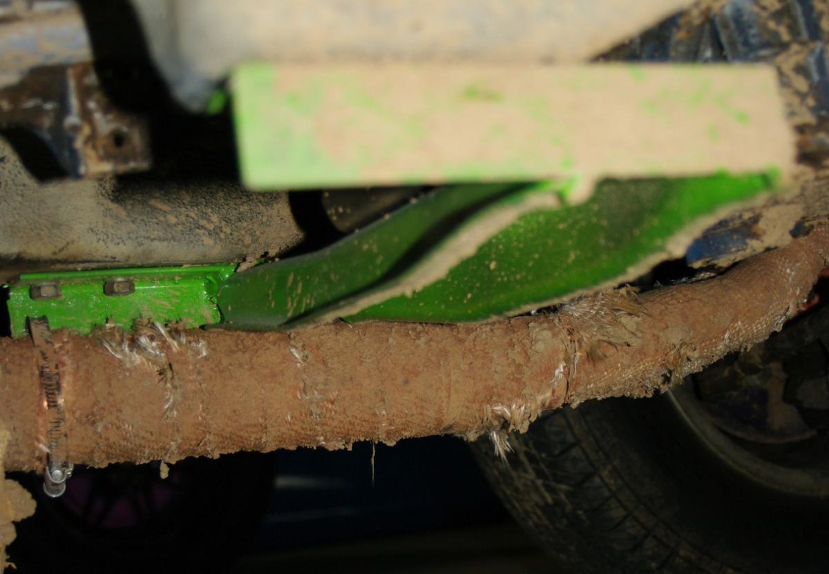

mcsniff Posted November 8, 2012 Report Posted November 8, 2012 We are in the process of converting my KE30 from auto to manual. I have searched extensively and have 99% of the parts but am stuck on the cross member. I have a '78 KE30 with the trimatic which has the different gearbox crossmember and mounting points. The manual crossmember I have doesn't match up with any holes on the car. I understand I have to make my own or weld the 2 crossmembers together. What is the best way to do this? Does anyone have any images or pointers to help me out. Thanks! Langdon Quote
Andy43 Posted November 15, 2012 Report Posted November 15, 2012 Langdon Here's how I did it. manual xmember and some 3mmX25MMX25MM angle I think and a mig. Andy 1 Quote

Andy43 Posted November 15, 2012 Report Posted November 15, 2012 Thanks Just finnished a reshell, and had the same problem. The crossmember hasn't broken, So I think it works OK Quote
