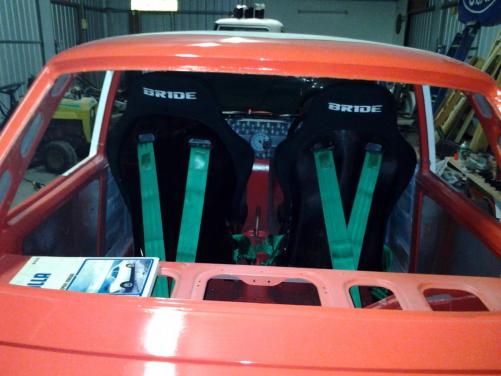

Feral4K Posted August 6, 2013 Author Report Posted August 6, 2013 MORE GOODIES!!! the seats n harness setup, were gonna need two seats for events like EASTERNATS SUMMERNATS LARDNER PARK Etc So clevo told me to go lightweight in the drift dept so BRIDES N TAKATAS it is! hope you guys like em cheers.... certainly really good fun puttin all the good bits in..... Quote

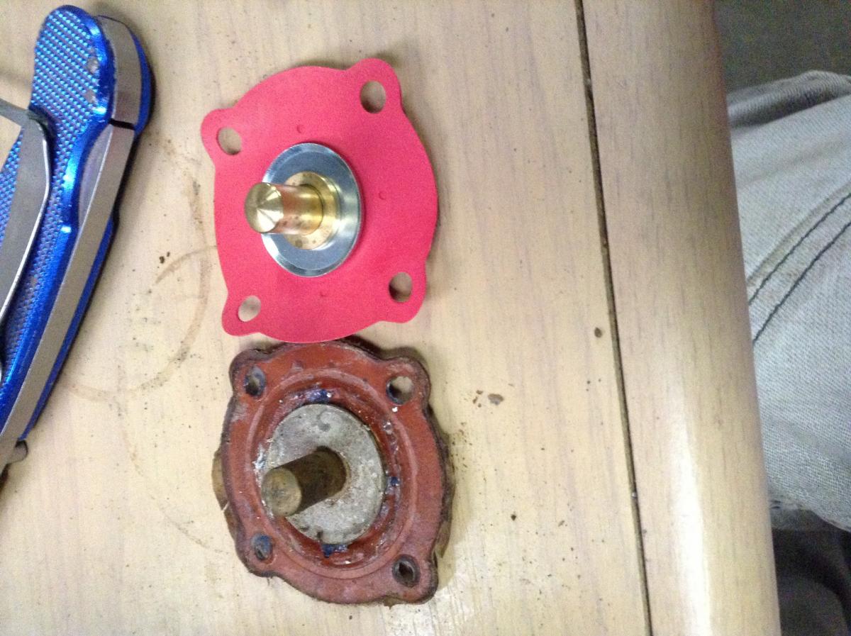

Feral4K Posted August 20, 2013 Author Report Posted August 20, 2013 And so I've just finished rebuilding the twin delortos.. Full new gaskets, O-rings, and accelerator pumps. Needle valves out in and cleaned up every nut bolt and screw. Â Â Check out the state of some of the parts!! Â Â Quote

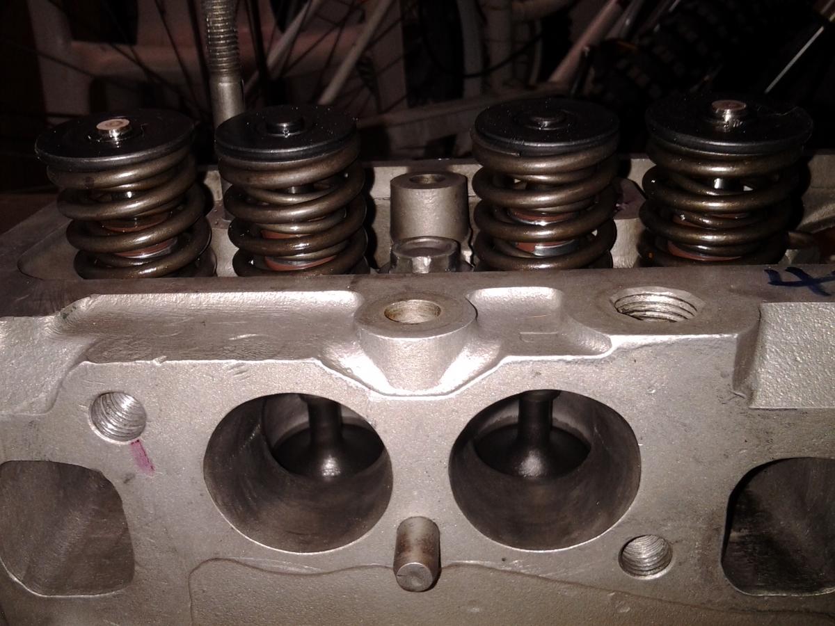

Feral4K Posted September 21, 2013 Author Report Posted September 21, 2013 Got the cylinder head back from shop!, 3k bigport, dads porting,3mm oversize FIAT intake valves, 1mm oversize ALFA exhaust valves all stainless, LANCIA double valve springs 80 pound pressure, new seats , guides,and vnv6 valve stem seals, heres some pikkies .... Quote
