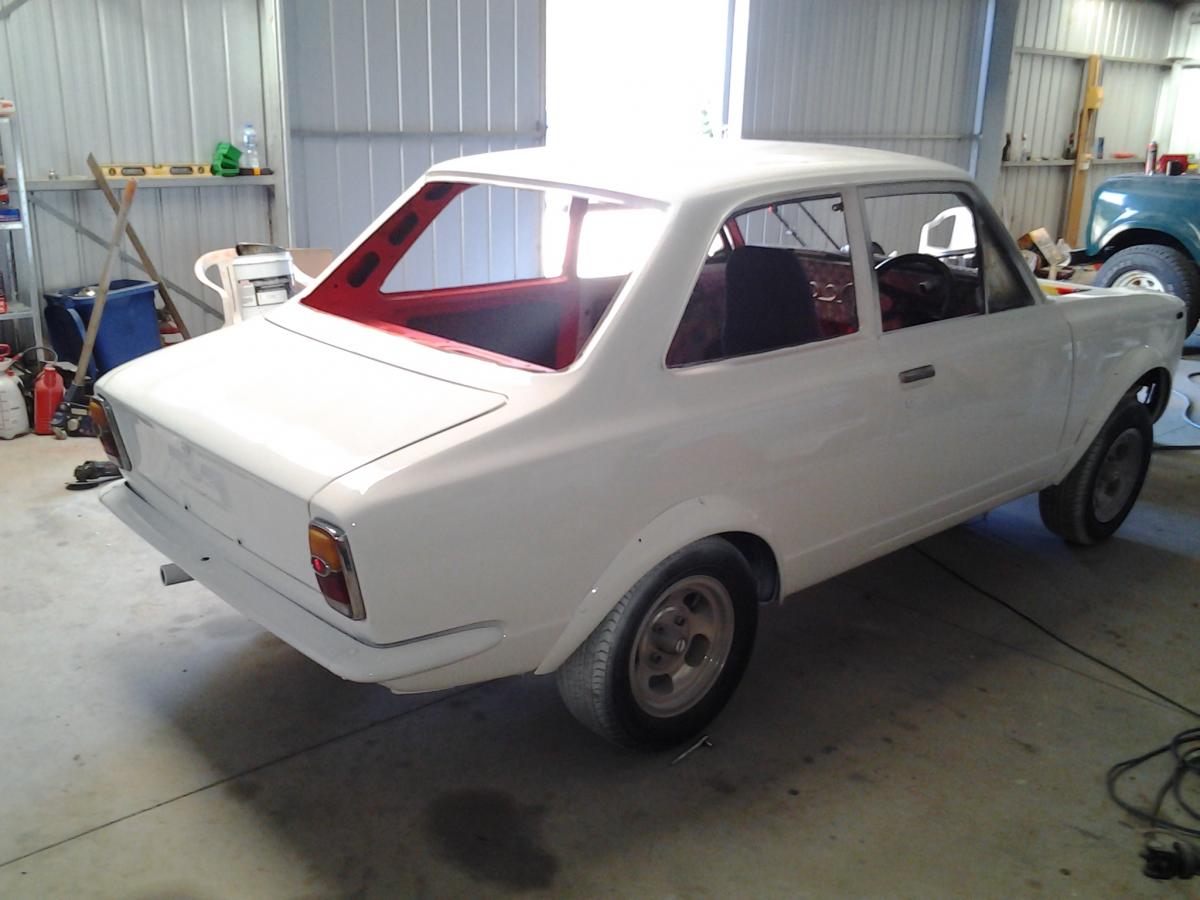

Hey guys, it's Cleveland here. Dads a bit busy, and I thought I'd throw a few pics up of the old rolla. As it is I'm about to start assembling the race engine, and here's hoping it'll be done soon :D I reckon it looks alright now, I might go work on it :P

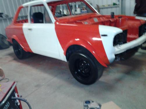

Looks alright I say, not bad, Stay tuned, I don't even know the paint scheme is yet :o (Dad wont tell me either)
Not bad you say Clevo?
I think it looks wwaaaayyyyy better than when I saw it last!!!
My offer to take that Scout off your uncle's hands still stands!!hahaha

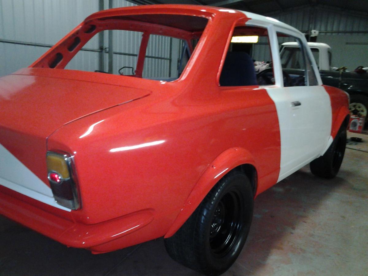

More pikkies! rear bumper finished and fitted ( sorry purists but they were far too gone to rechrome em!) so they were
stripped panelbeated lightened and colorcoded....
post-17369-0-95475600-1374031035_thumb.jpg How ya all goin with the bumpers bein bodycolor?

Reckon those bumpers look alright, kinda works with overall look and flared guards.

Hey guys got a bit more done today, mainly the outside colorscheme, I know its quite brock like but sennas mclaren just doesnt have enough bodywork to make,
the old scgool marlboro paintscheme look good, imo ...also thinking of replacing the MARLBORO lettering with ROLLABRO seeing as the boy is half maori lol....
post-17369-0-35374600-1374751060_thumb.jpg Originally it was supposed to be an AYRTON SENNA TRIBUTE but its kinda morphing into an early brockie,
ohh well the VB TO VK commies looked tough as anyway!!
