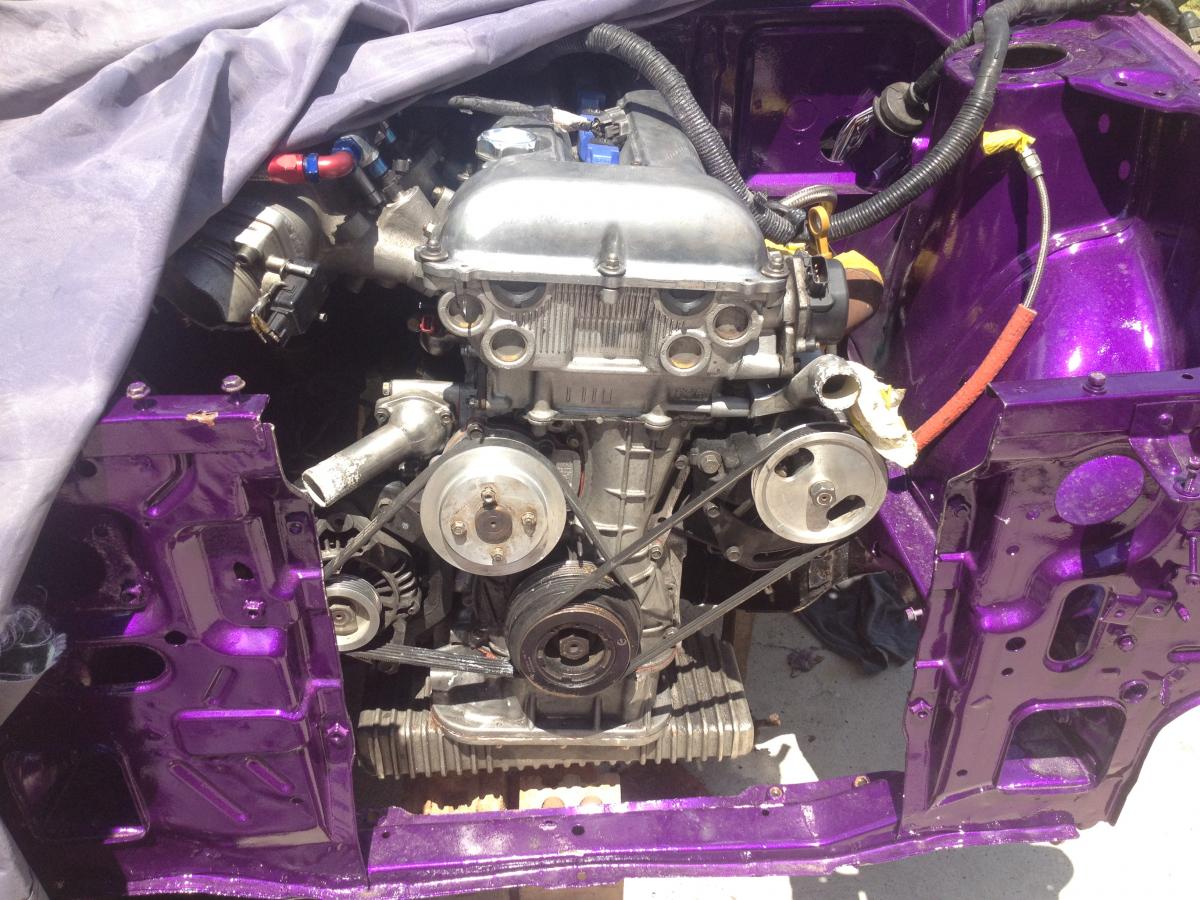

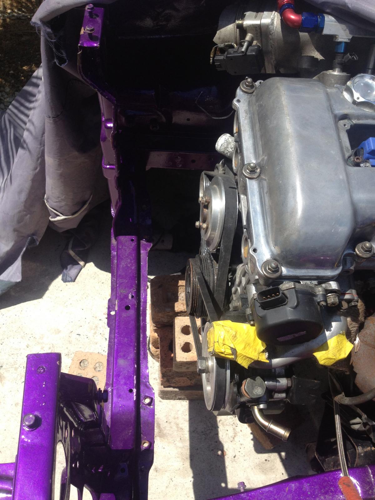

flawless-paint Posted November 6, 2012 Author Report Posted November 6, 2012 i know .... touching the tunnel, firewall and the back of the crossmember which I'm going to cut off Quote

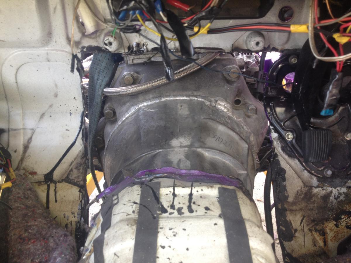

flawless-paint Posted November 17, 2012 Author Report Posted November 17, 2012 (edited) finally brought myself to cut the gearbox tunnel out... now the motors all bolted up .... just need to get a new gearbox mount made up.... Edited November 17, 2012 by flawless-paint Quote

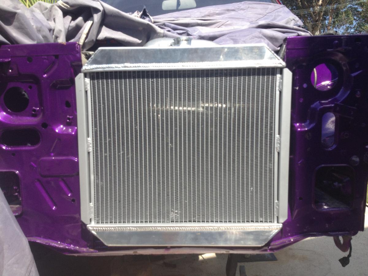

flawless-paint Posted November 18, 2012 Author Report Posted November 18, 2012 how it sits at the moment bolted in quite close ... Quote

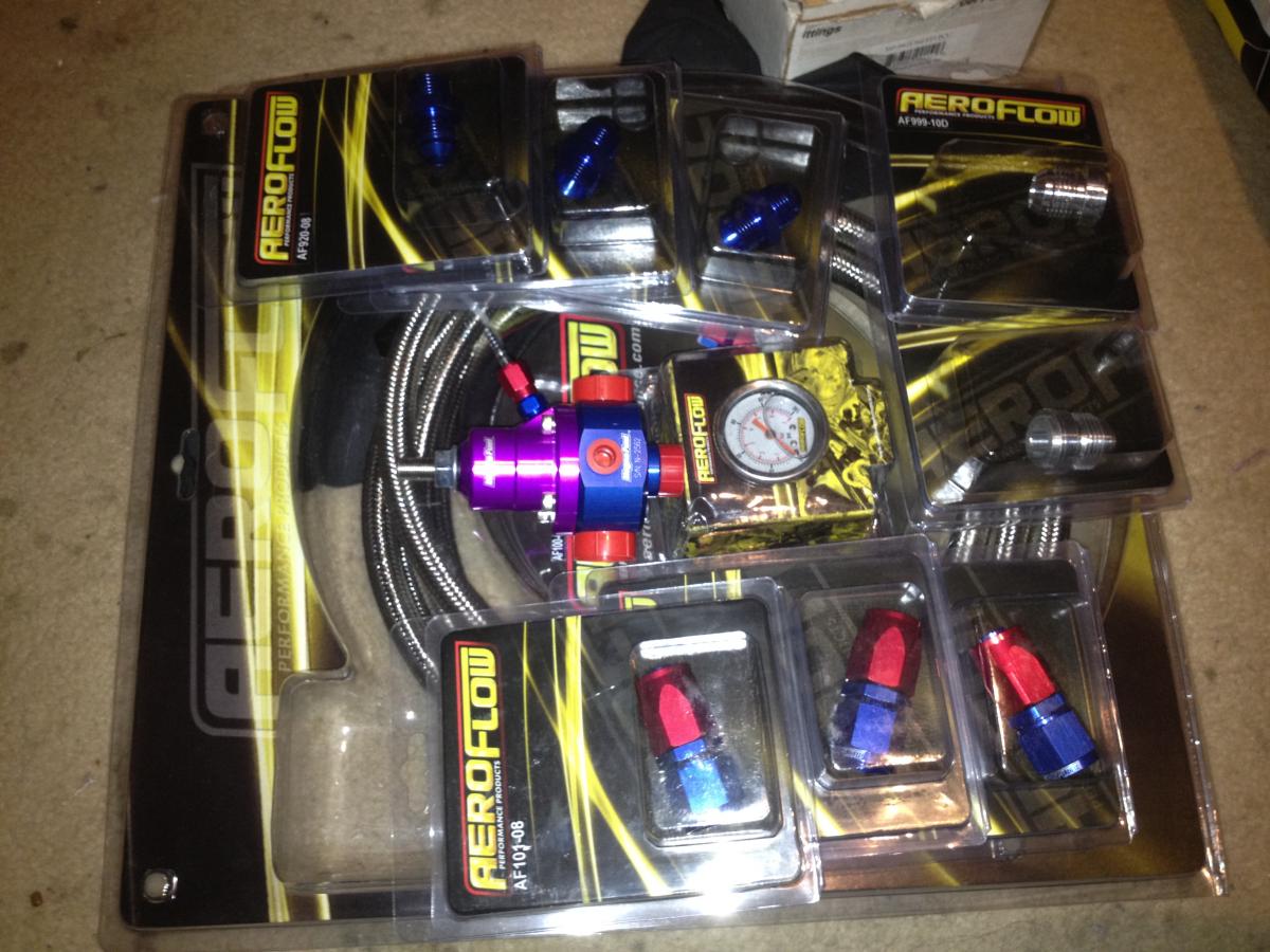

flawless-paint Posted November 28, 2012 Author Report Posted November 28, 2012 been shopping ,pwr intercooler bought fuel setup bought, alloy radiator is in the process of been made by nathan at just alloy radiators and the tailshaft just got rebuilt n strengthened all round by kcdr driveshafts . and a few little bits are getting fabricated now so the coil overs n brakes fit, just have to mount the radiator cooler fuel reg and all the braided lines , weld the tunnel back up install the coil overs then she's off to get wired up and have the drag link installed Quote

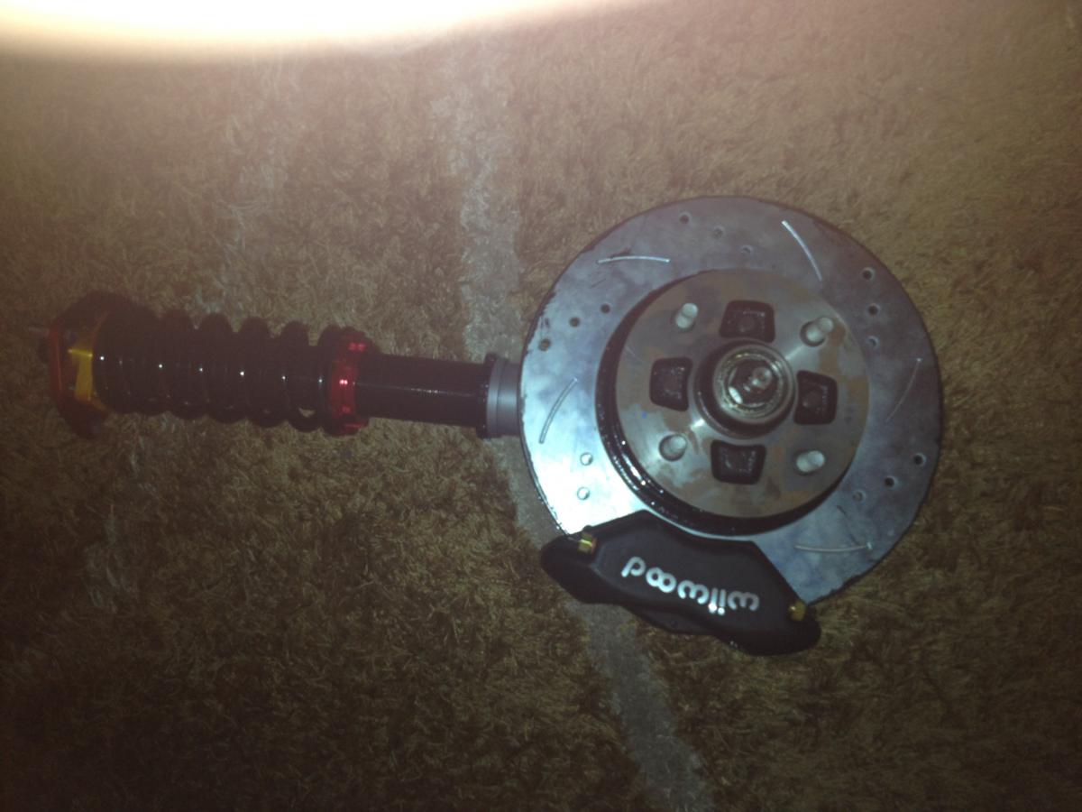

flawless-paint Posted December 8, 2012 Author Report Posted December 8, 2012 radiator,coil overs, brakes n steering knuckles in .... and 17s on the way ....pretty sure they won't fit but o well ...ill try it anyway Quote
