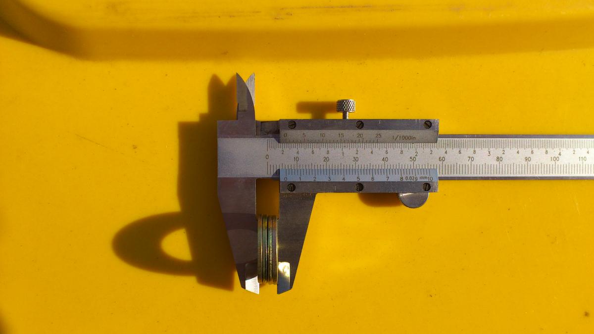

Adrogen Posted September 27, 2012 Author Report Posted September 27, 2012 I grabbed some washers and packed the wheel up one by one, to see how thick a wheel spacer would have to be to clear the caster rod. A bees dick over 6mm. just for curiosity does this mean a 14x7 +2 wheel would fit here? Quote
ke70dave Posted September 27, 2012 Report Posted September 27, 2012 Assuming the current wheels are 14x7 +8 then yep, to stick out 6mm more it neesd to be 14x7+2. dare i say it, 6mm slip on spacer? Quote
Jono.C Posted September 27, 2012 Report Posted September 27, 2012 Yep, 6mm slip on spacer, set you back than $20 a pair Quote
