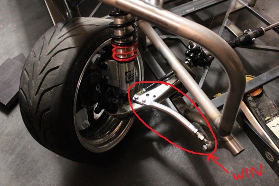

Need help with my ke70. The front tyres hit the caster (tention) rods when ever you try to turn all the way left or right :(

none "dialed" in, the caster adjustment was slackened right off until there was no load on the LCA to install the sway bar links with out any huffing and puffing then caster adjustment pulled up to about the middle of its thread for a starting point ready for alignment.
will winding the caster back and springing on the LCA bushings pull it away from the caster rod???

sounds to me like the combination of the slightly positive wheels, lock spacer and ps arms creates too much lock and the tyre hits.
You could weld a lock stop onto the LCA to stop the steering arm going to far.
its quite possible that everyone with this setup rubs the crap out of their tyres on full lock.
We had something of the same problem, but ours rubbed on the chassis at the back.
Setup is Sigma LCA's, AE86 PWS arms, no lock spacer, and 13 x 6 rims with 195/70 rally tyres and a quaife quick rack..
Face it, you'll have to remove some lock out of the steering or change your rims.

If it's a street car he's right ^
If it's a track car just lengthen the lower control arms to buggary, more track to push the wheels right out..
Or look into dog legging some castor rods
yeah I had started to think about caster rods with a small kink in the right spot, has anyone done this? seems like a perfect solution if it could be done...
car will be registered so need to keep things looking neat.
