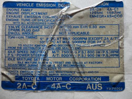

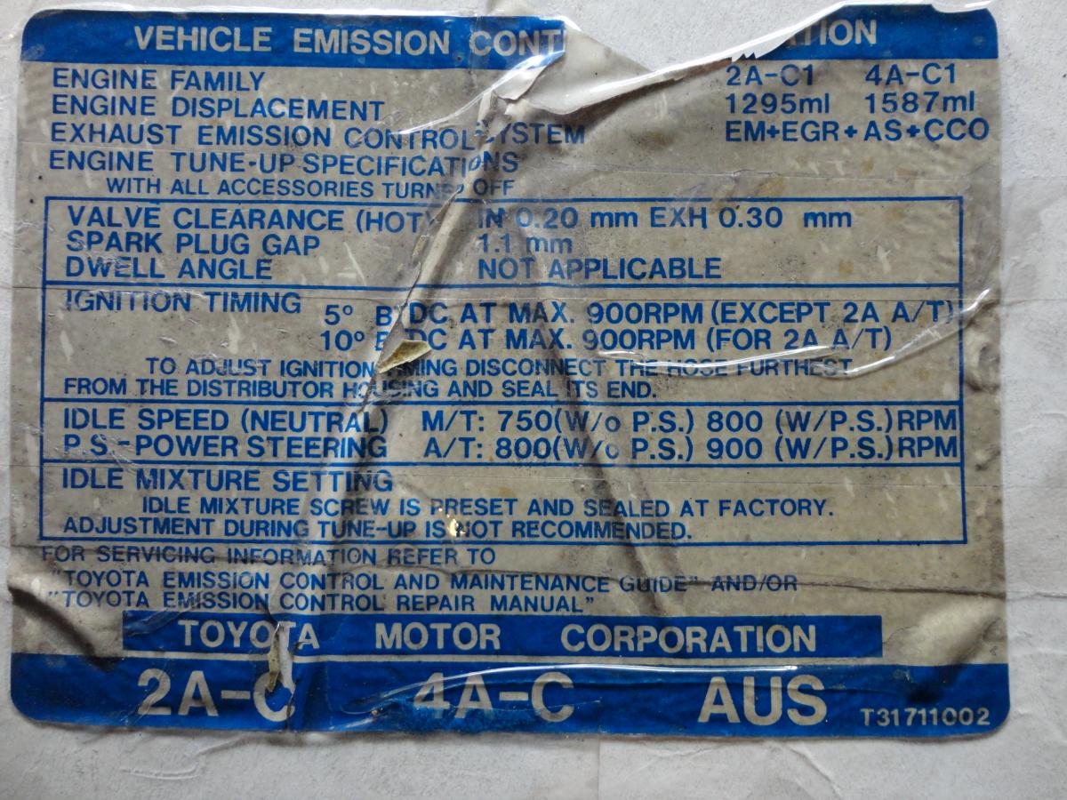

It's my old car, It has a 4AC 5spd manual. Head has been redone 40k ago. now when I had it, it was no where near as bad however it may have been an infant gremlin. I swapped the relay for the cooling fans and they ran once, put a new relay in and they haven't run again. It was a once off. It had a shitty idle that improved with leads and plugs. The car is running rich, it has a shit load of power, drives well but will NOT now idle below 1400 rpm approx. I bought the emmisions control, body and engine Toyota manuals off ebay and everything as far as emissions is hooked up right. Can't do the timing properly because I can't set an idle. Basically the idle is set as if you were trying to keep it running on 2 cylinders. at one point on the 4 plugs one was reddish, 2 were sooted and one was lean. I can not hear an air leak, but I am wondering if it may be time to do a manifold gasket due to trying to get the exhaust/inlet 2 piece set up square. I have been working on cars for 17 years and I assisted with the manifolds going back on and I'm quite willing to admit to my friend and say well, maybe I got it wrong if it is looking like a manifold gasket. Thing is I can't hear a leak
Maybe because it's red (Really) and it's a Corolla it just wants to go fast Oh and Compression is 150 across the board so mechanically the engine is fine and it has good spark + 2 Carbies (one rebuilt) are doing the same thing
