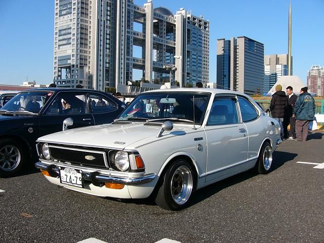

Willis Posted September 8, 2012 Report Posted September 8, 2012 Off topic here but dear God, that white car pictured above is just amazing. Quote
