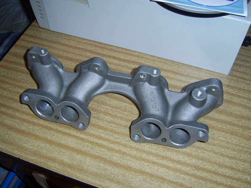

jluc_93 Posted August 21, 2012 Author Report Posted August 21, 2012 It's a redline manifold and the carbs are 40mm DCOE webers. http://www.rollaclub.com/faq/images/9/9c/Post-6-1153469779.jpg is the manifold, I'm not too good with stuff like this so I think it has a pcv inlet. I like your setup but unfortunately I don't have an air box. What would be the next best thing? Run a line from the valve into the mainfold then put a filter on the other? Cheers! Quote
corollaart Posted August 21, 2012 Report Posted August 21, 2012 The inlet on that manifold is for your brakes. Quote

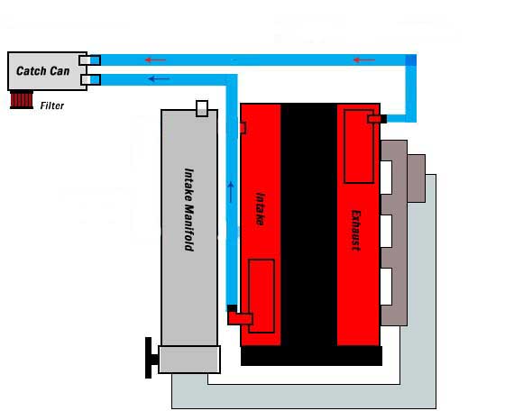

altezzaclub Posted August 21, 2012 Report Posted August 21, 2012 (edited) Just plumb both those tappet cover vents into a suitable-looking can with a little filter on top. Basically it will leak oil & water vapour out of that filter all the time unless you hook it up to the inlet manifold so the motor can suck some of the fumes in and burn them. So best would be to keep the PCV valve & run that line into the brake booster line in a T-piece and have the other line going to the filtered catch-can. Under cruise and idle the strong vacuum sucks the PCV valve shut so it doesn't suck out of the engine, so the small amount of blowby goes out of the catchcan filter into the atmosphere. Under acceleration the inlet manifold vacuum goes to nothing with the throttle open so the spring in the PCV valve can push the piston back and allow the inlet manifold to suck the greater blowby into the motor. Fresh air then goes IN through your filter and catchcan. I ran mine on the brake booster line for ages until Rob said I shouldn't, but t made no difference when I moved it. Then again, we have different ideas on how a PCV is meant to work too! Edited August 21, 2012 by altezzaclub Quote
