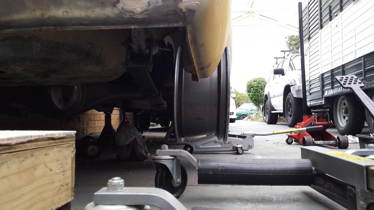

indelible Posted March 22, 2014 Report Posted March 22, 2014 did i hear that right ? die grinding centre hole of wheels out to fit larger hub ring so no hubcentric ring for the wheels anyomore? Quote
maccat01 Posted March 22, 2014 Author Report Posted March 22, 2014 (edited) Nah. Its not a tyre on the rim. Just sitting the rim on a tyre so it doesnt get scratched on the garage floor. It is getting 50 profile tyres so the honda cluster is speed accurate. Edited February 17, 2015 by maccat01 Quote

indelible Posted March 23, 2014 Report Posted March 23, 2014 hopefully the modified centre holes aren't far off centre doing it that way and cause vibrations if you are still going to locate them off the hug ring they don't have to be far off at the rpm wheels can be spinning Quote
maccat01 Posted March 23, 2014 Author Report Posted March 23, 2014 (edited) Wheels fit the hubs great Edited February 17, 2015 by maccat01 Quote
maccat01 Posted March 24, 2014 Author Report Posted March 24, 2014 Minor win with fitting the wheels :-). Hilux doesnt have hub centric wheels. So bore size of rear wheels doesnt matter :-) Quote

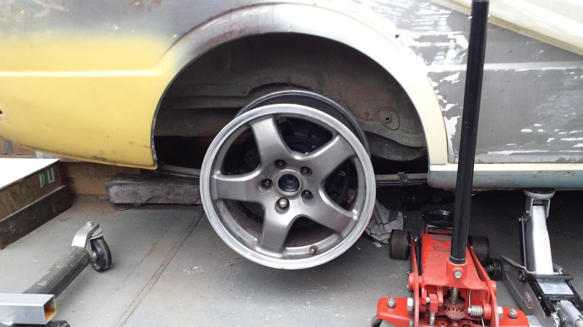

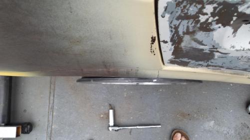

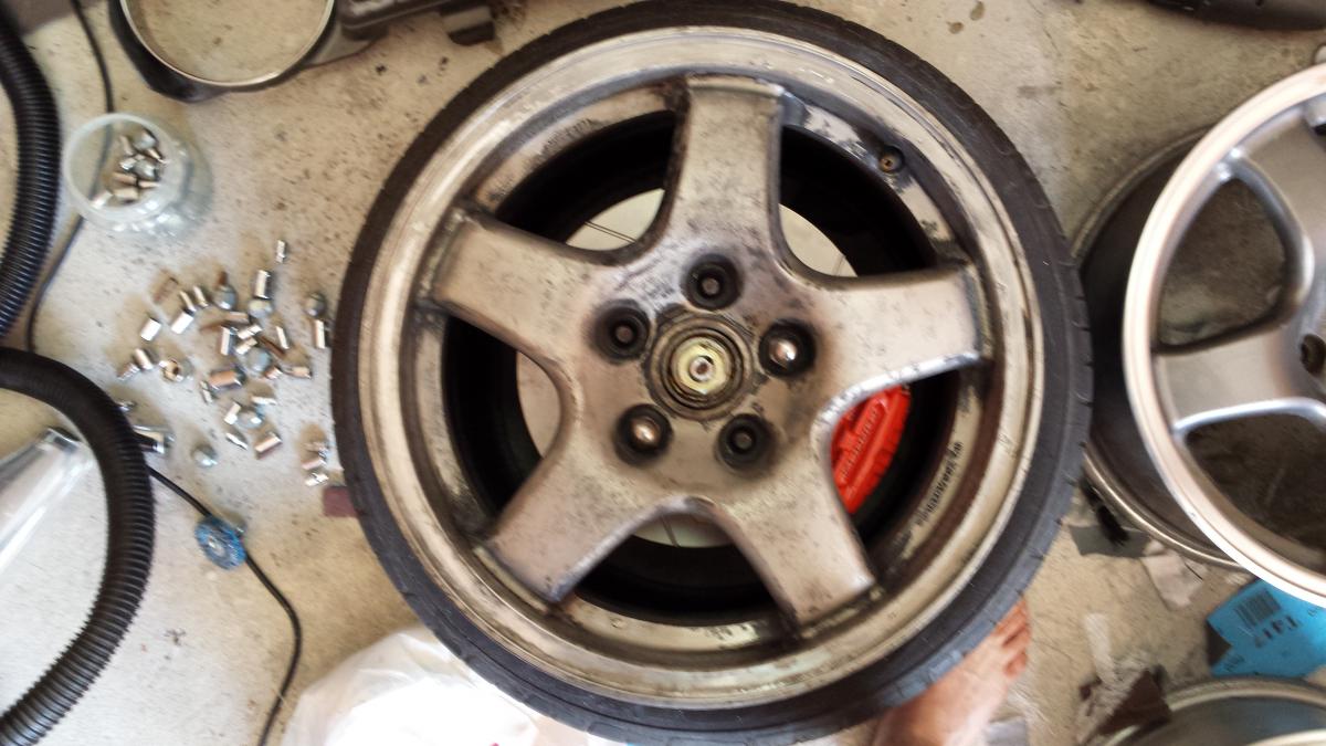

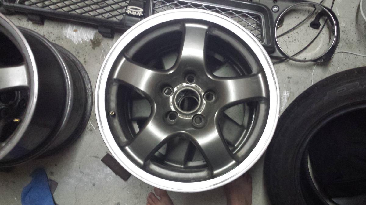

maccat01 Posted March 31, 2014 Author Report Posted March 31, 2014 My front brakes looked huge by them self but inside the wheels they look tiny. Oh well Test fitted rear wheels on car. Have found ill need to flare the rear guards about an inch. Shouldnt need to add any material as I'm hoping that a bit of heat and hammer and dolly will flare it out ok. Lastly, I have polished the lips on all the wheels. They were badly damaged on two of the wheels and the one in the pic was the worst. So they came up good. Quote

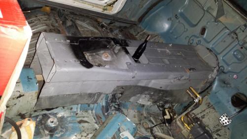

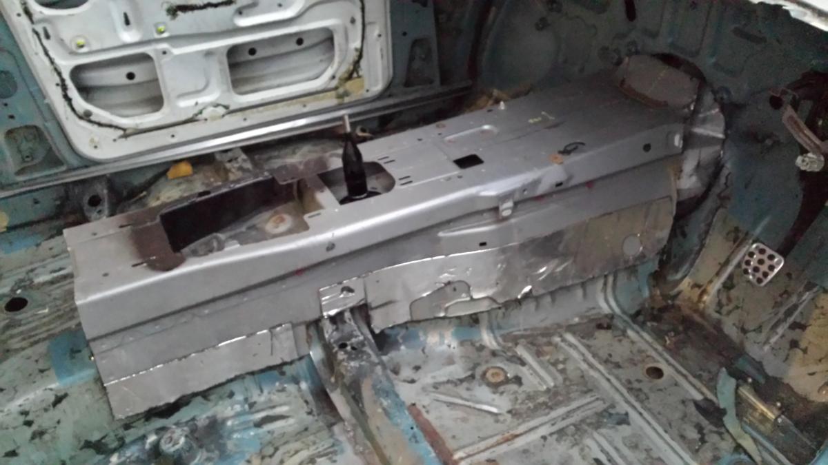

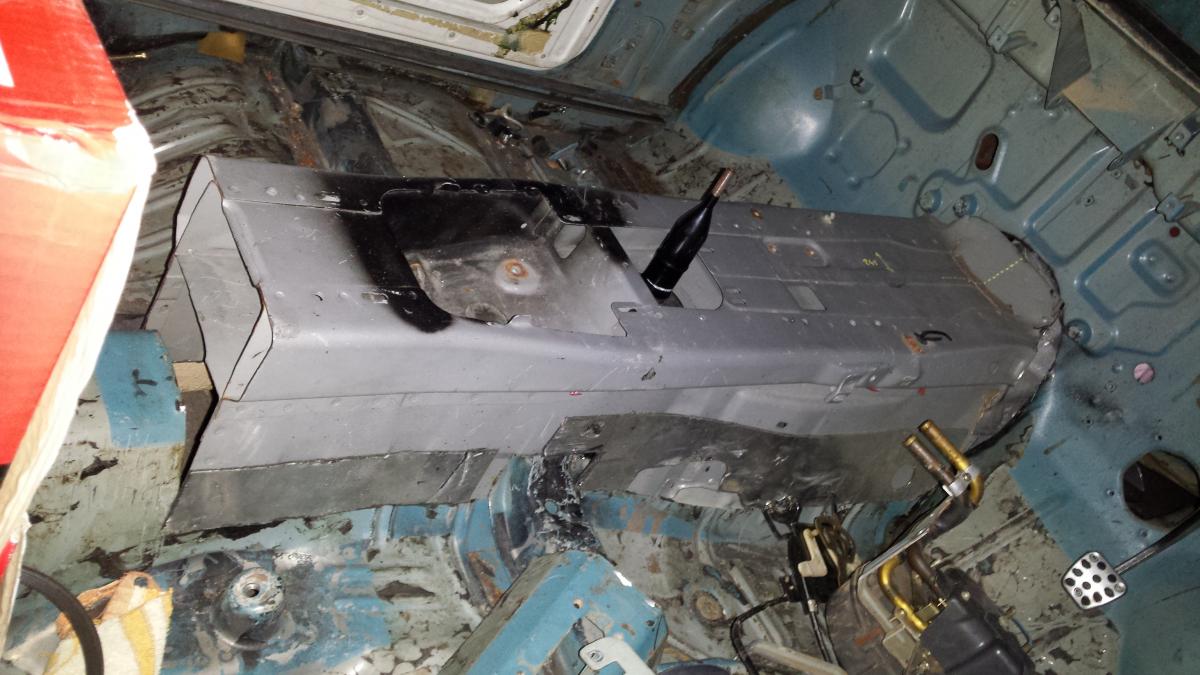

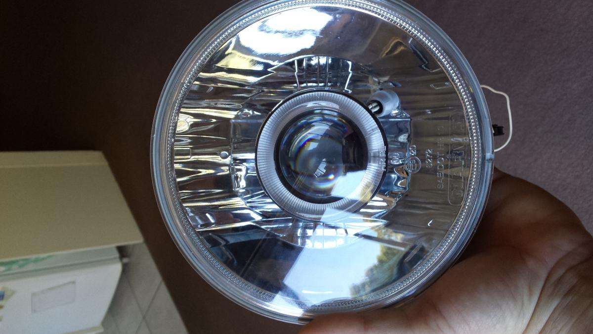

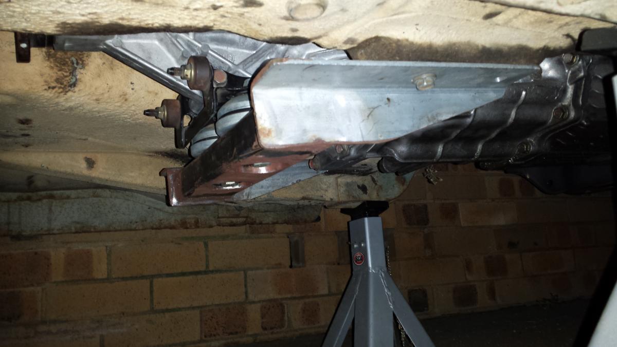

maccat01 Posted April 5, 2014 Author Report Posted April 5, 2014 Cut up tunnel and fitted s2000 tunnel. It now fits just needs welding and a patch up the front. Also finished gearbox crossmember and fits well. And finally my projection headlight inserts. Quote
maccat01 Posted April 5, 2014 Author Report Posted April 5, 2014 Btw, when I cut out the corolla floor so the s2000 tunnel becomes the under side of the car, I have left the ke30 floor braces in place to keep the strength in the floor. So underneath the s2000 tunnel will be nothing but the factory structure. Will look a bit odd but its the only way I can think to run this tunnel and keep the car from flexing. I am open to other suggestions or ideas on the matter. So fire away :-D Quote

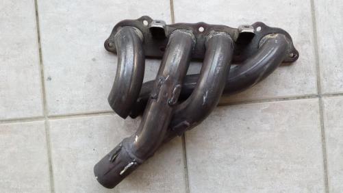

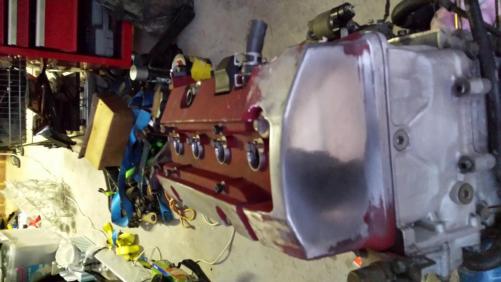

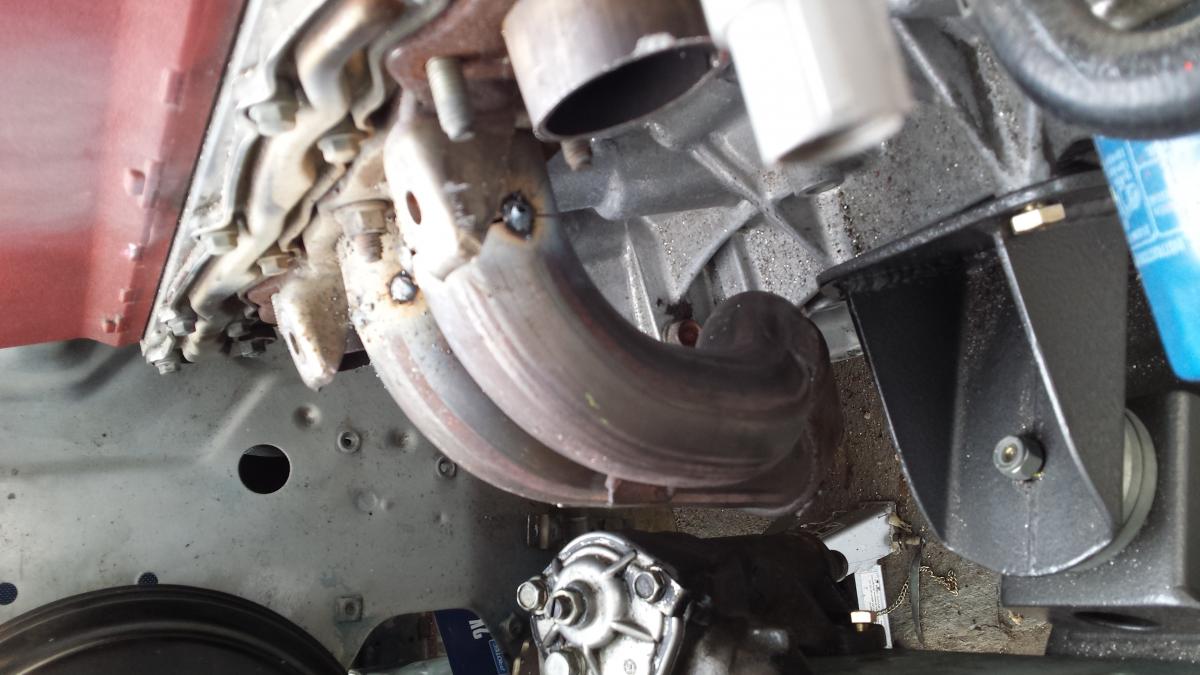

maccat01 Posted April 13, 2014 Author Report Posted April 13, 2014 Have 90% completed manifold. Welded in radiator supports and finished seat rails that work with the stock mounts. Quote

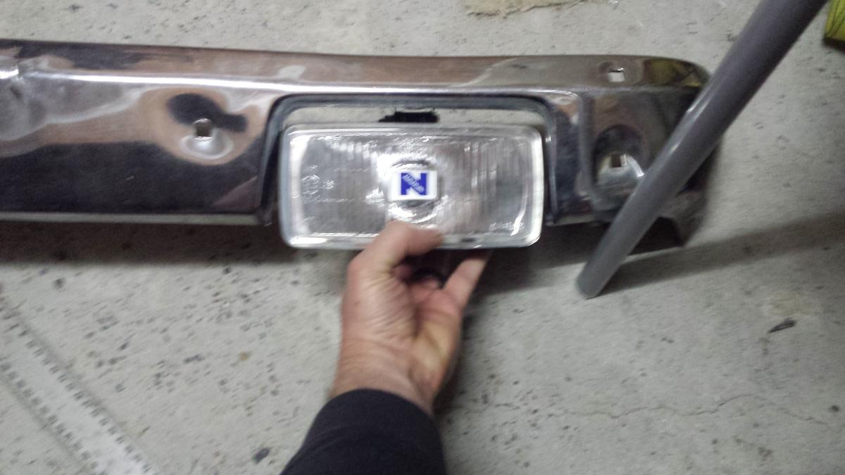

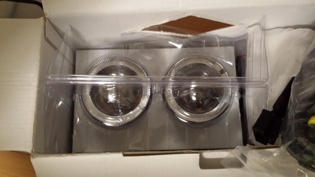

maccat01 Posted May 29, 2014 Author Report Posted May 29, 2014 Hey all. Long time no update. Car is still away getting things welded. But in the mean time I have built myself some projector headlight. I have worked out a way to fit some spot lights in the standard indicator sport and have purchased all parts to build a stainless 2.5 inch exhaust. The polishing is coming along ok and I'm doing about 2 hours a day so its not so monotonous. Quote
