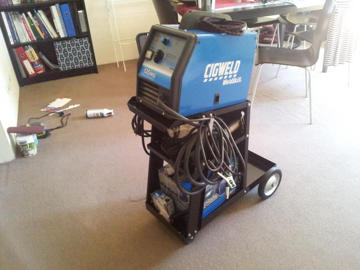

maccat01 Posted September 11, 2013 Author Report Posted September 11, 2013 I ended you getting a 130amp cigweld gas mig and an auto dark visor from masters hardware brand bew for $300. It was a fathers day special... can't say no to that price!!!! Ive seen that mick broke his tail shaft but I would have never imagined a honda engine breaking anything. A sewing machine has more torque... haha. Might be a different story supercharged :-) Quote

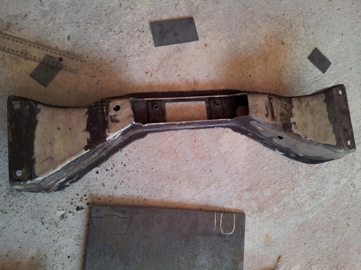

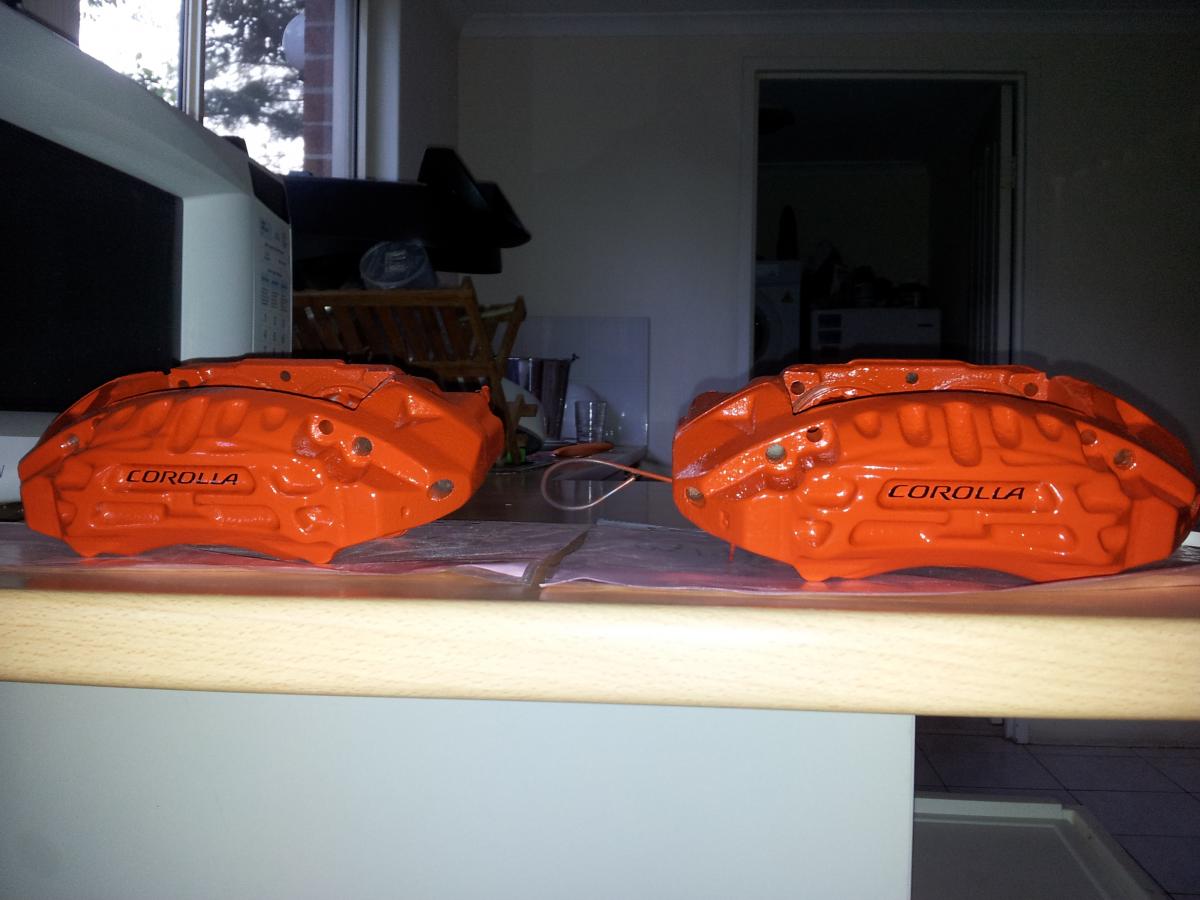

maccat01 Posted September 15, 2013 Author Report Posted September 15, 2013 New HILUX S13WB brakes Modified engine crossmember Quote
maccat01 Posted September 15, 2013 Author Report Posted September 15, 2013 (edited) Now brakes are 95% complete. Only the rotors to buy now. 2005 transit ford rotors for fronts and ma70 supra rotors for rear. Transit ones need a lip grinded out o they bolts sit flat. Other then that good to bolt on. :) Also, due to the calipers having huge vent fins on the outside edge, I was informed that finding wheels to fit would be very difficult. But I tried my BF Falcon 16 inch steelies on the setup yesterday and they fit awesome :). So I'm hoping 95% of wheels that will fit to a Falcon will fit to my car. Edited September 15, 2013 by maccat01 Quote

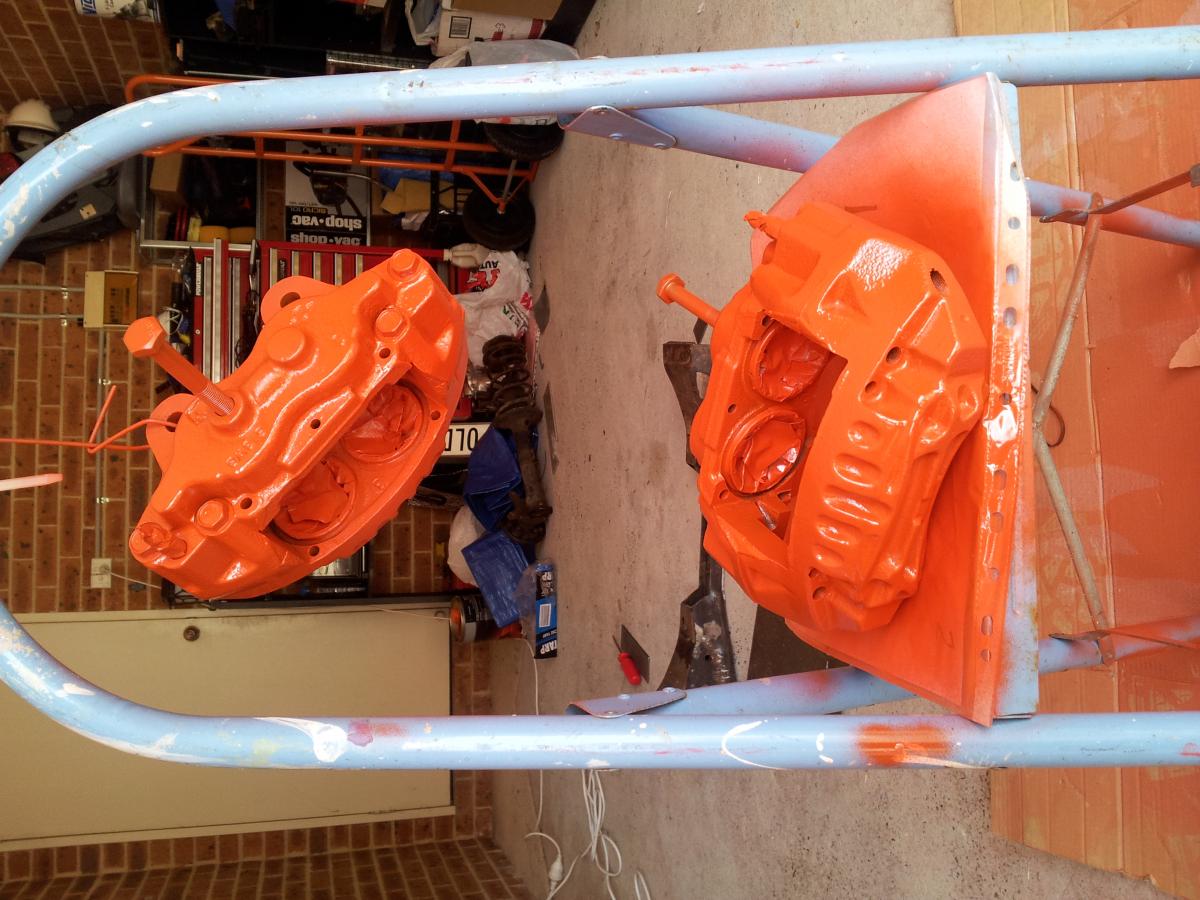

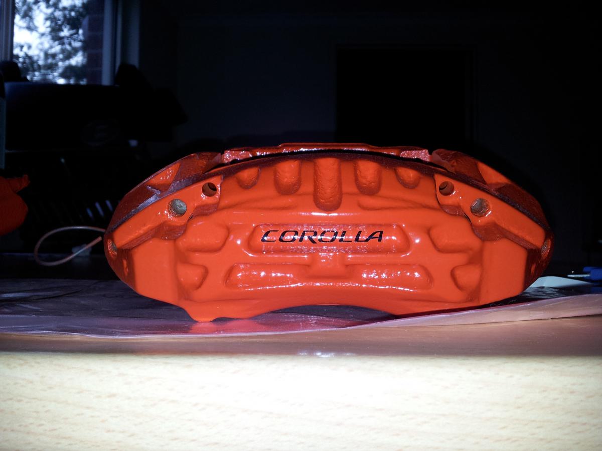

Robski Posted September 24, 2013 Report Posted September 24, 2013 Moving along great mate. What paint did you use on the brakes??? I just have heard of some people painting their brakes all nice and shiny and then within a month of driving they look like crap. Anyway the progress is great, crossmember looks great, and good luck with the wheels, keep me informed of the outcome. Quote

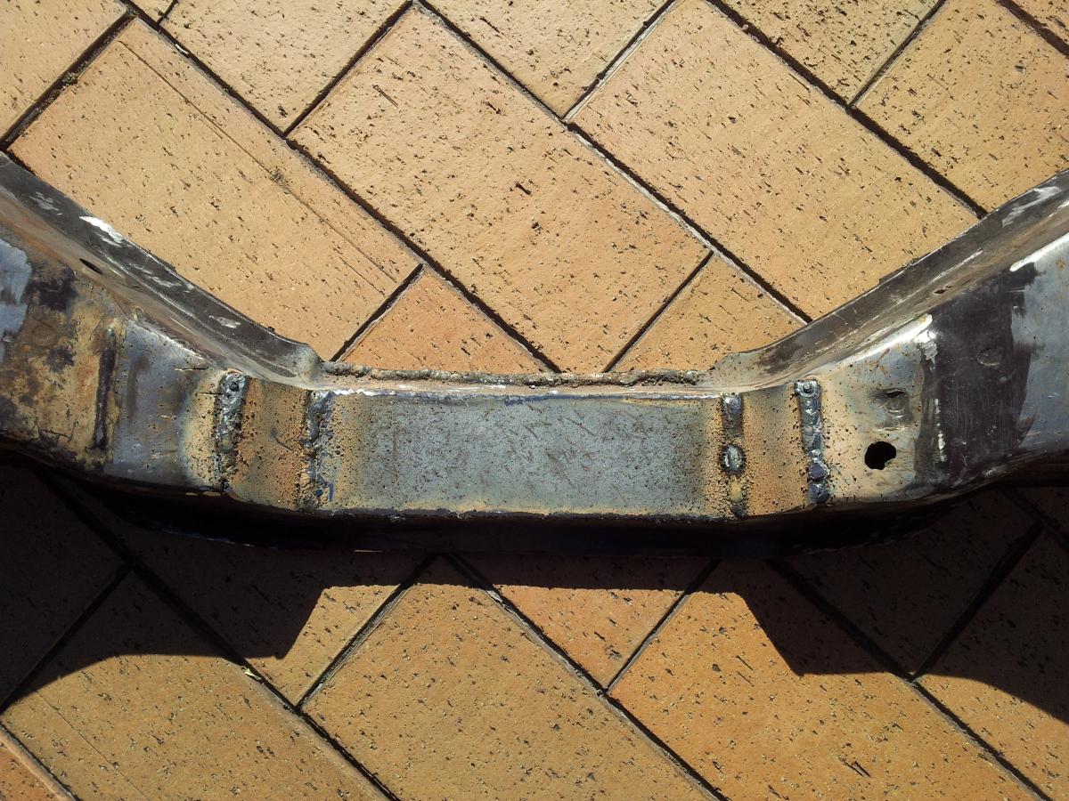

maccat01 Posted September 29, 2013 Author Report Posted September 29, 2013 The Paint is VHT high temp caliper paint, with their clear coat applied over the top. The first set of hilux calipers I did chipped very bad due to sitting in garage. I primered, coloured and clear coated as per manufactured instructions but still it flaked off. I called the manufacturer and they told me the primer is useless and just to colour. I still applied the clear though, as want the decals to stay on when cleaning the calipers. Just gopt new welder and crossmember is almost done now. Will post pics soon Quote

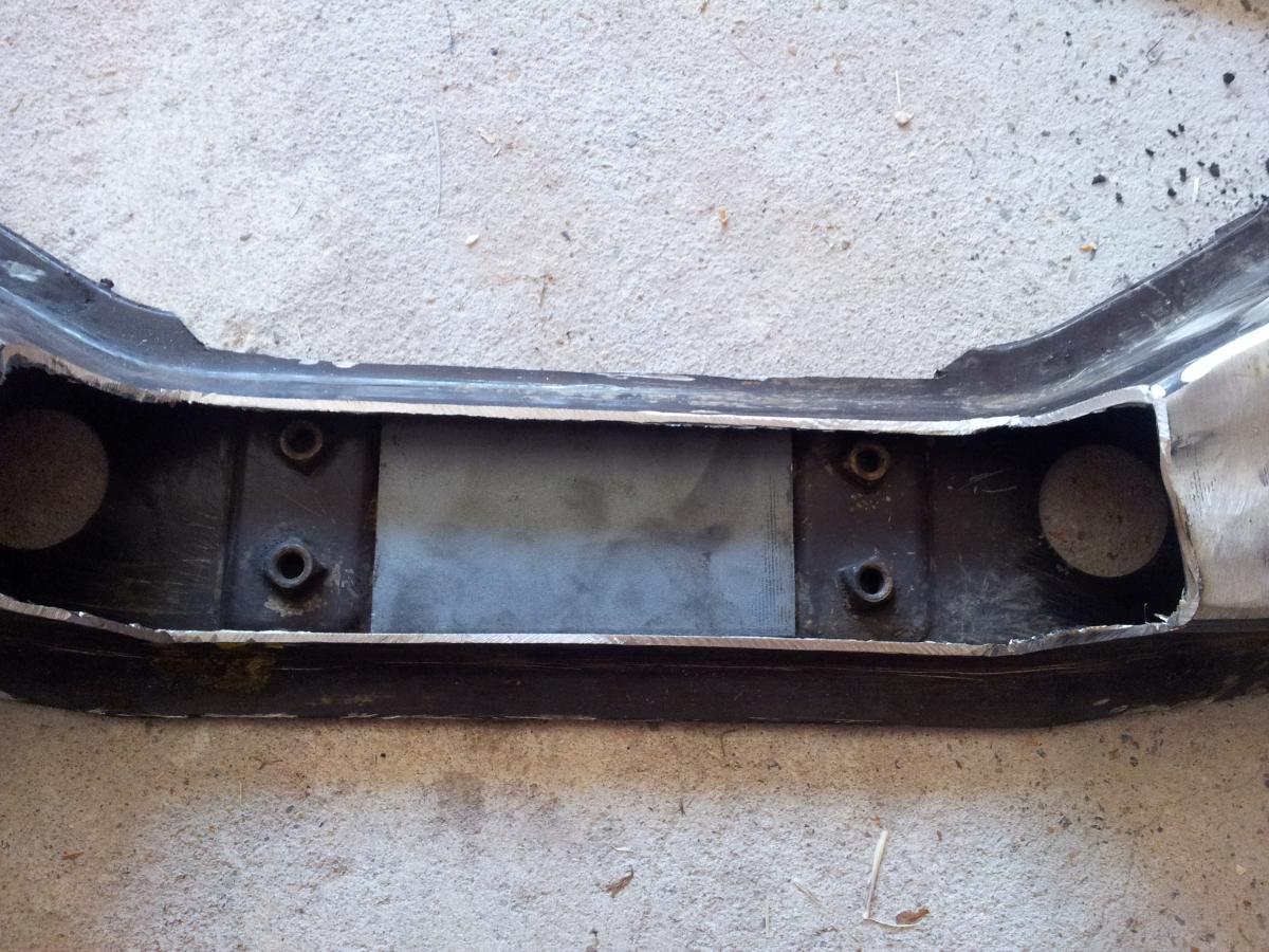

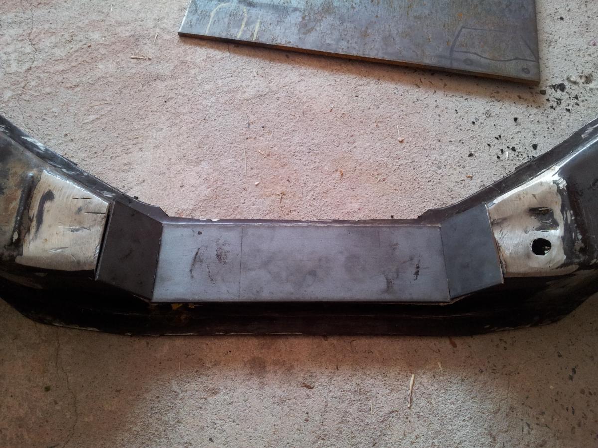

maccat01 Posted September 29, 2013 Author Report Posted September 29, 2013 New welder. whole setup only $350 brand new!!!!!!!! Still needs to be finished. welding 95% done on it. Just need to add taabs for engine mounts now Quote

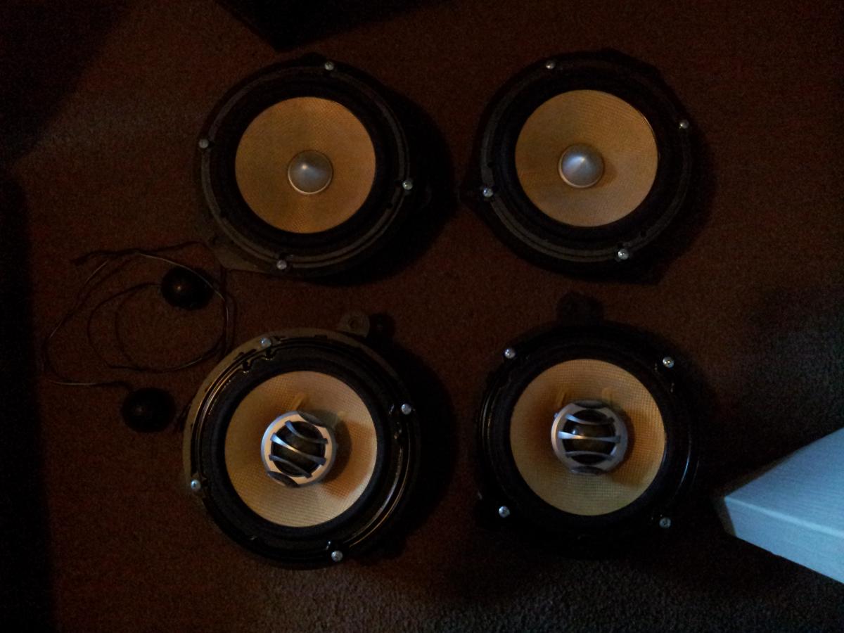

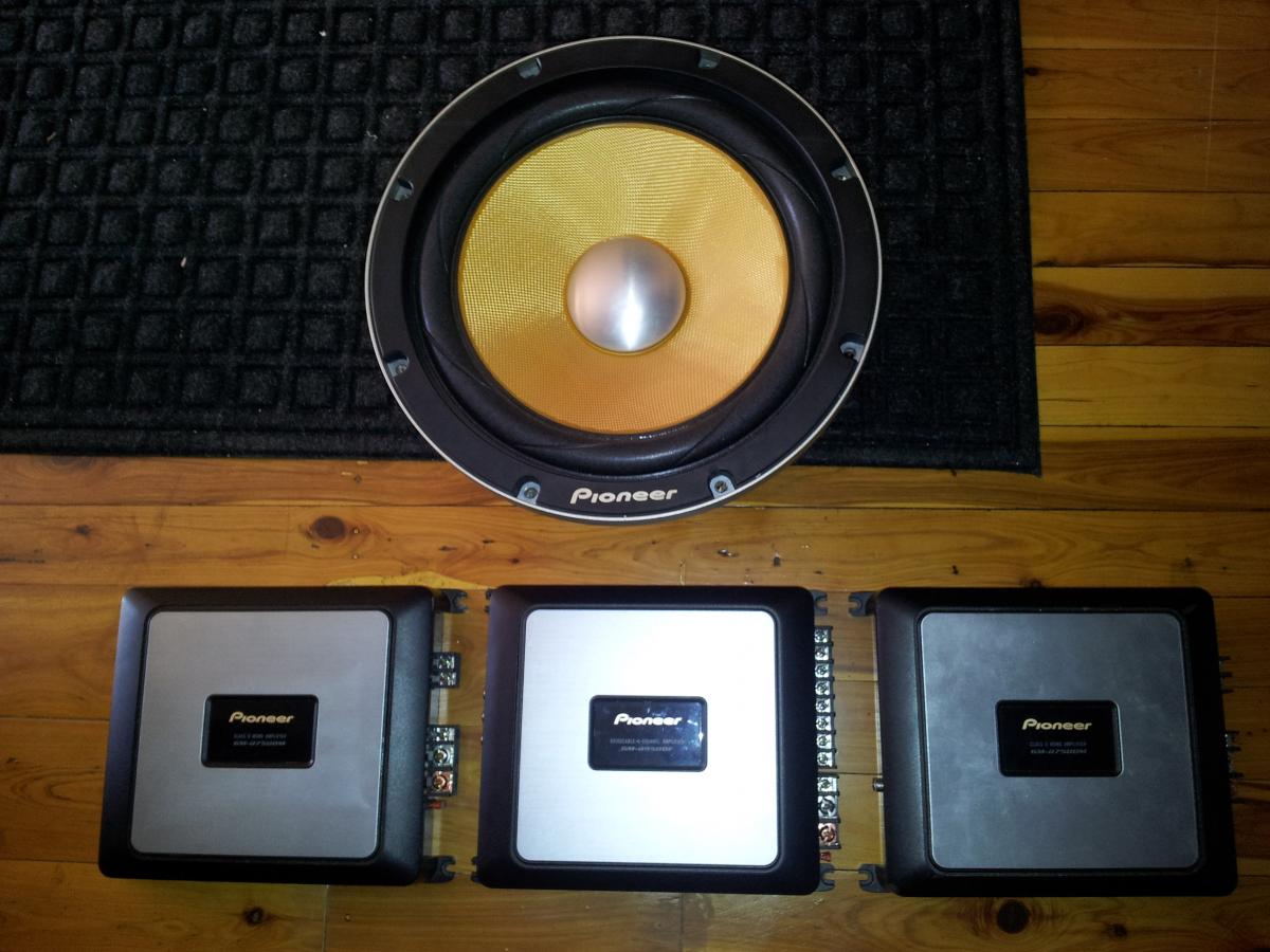

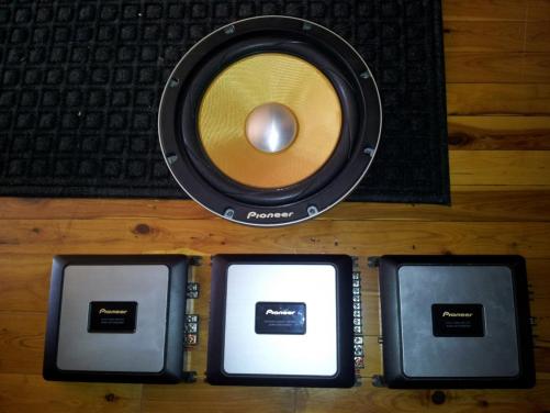

maccat01 Posted October 10, 2013 Author Report Posted October 10, 2013 On Wednesday I purchased the missing piece to my corolla stereo install. This type of Subwoofer was extremely hard to find as they are almost a 9 year old model. I wanted all my speakers to match so the install looked tidier. I apologise for the pic of the speakers being rubbish. Phone flash went AWOL. I kept some bits from my my11 WRX stereo setup as the usb interface installed in the wrx was very tidy. Will be installed in new transmission tunnel with S2000 console. Quote
