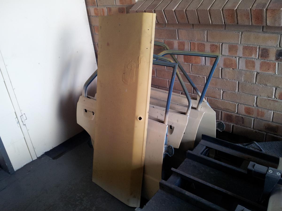

More pics of the build. Has been very slow but finally have the falcon wheels all mounted to the xt130 struts with the ms65 crown hubs and all new bearing, and have found doors in better shape from a ke55.

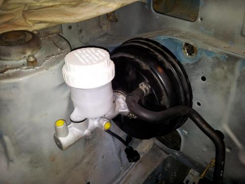

I have the engine sitting in the car now and will fab the mounts in the next few weeks. I have also mounted the honda brake pedial assembly and pajero brake booster.

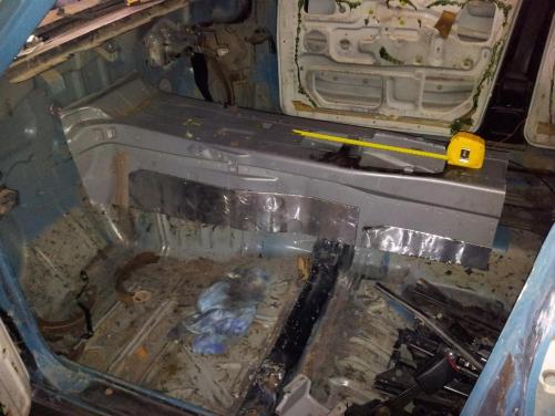

Next up the transmission tunnel from the s2000 was kept and I have now cut it to the right size to weld into the car. This was a bit quicker then having to make a tunnel from scratch.
