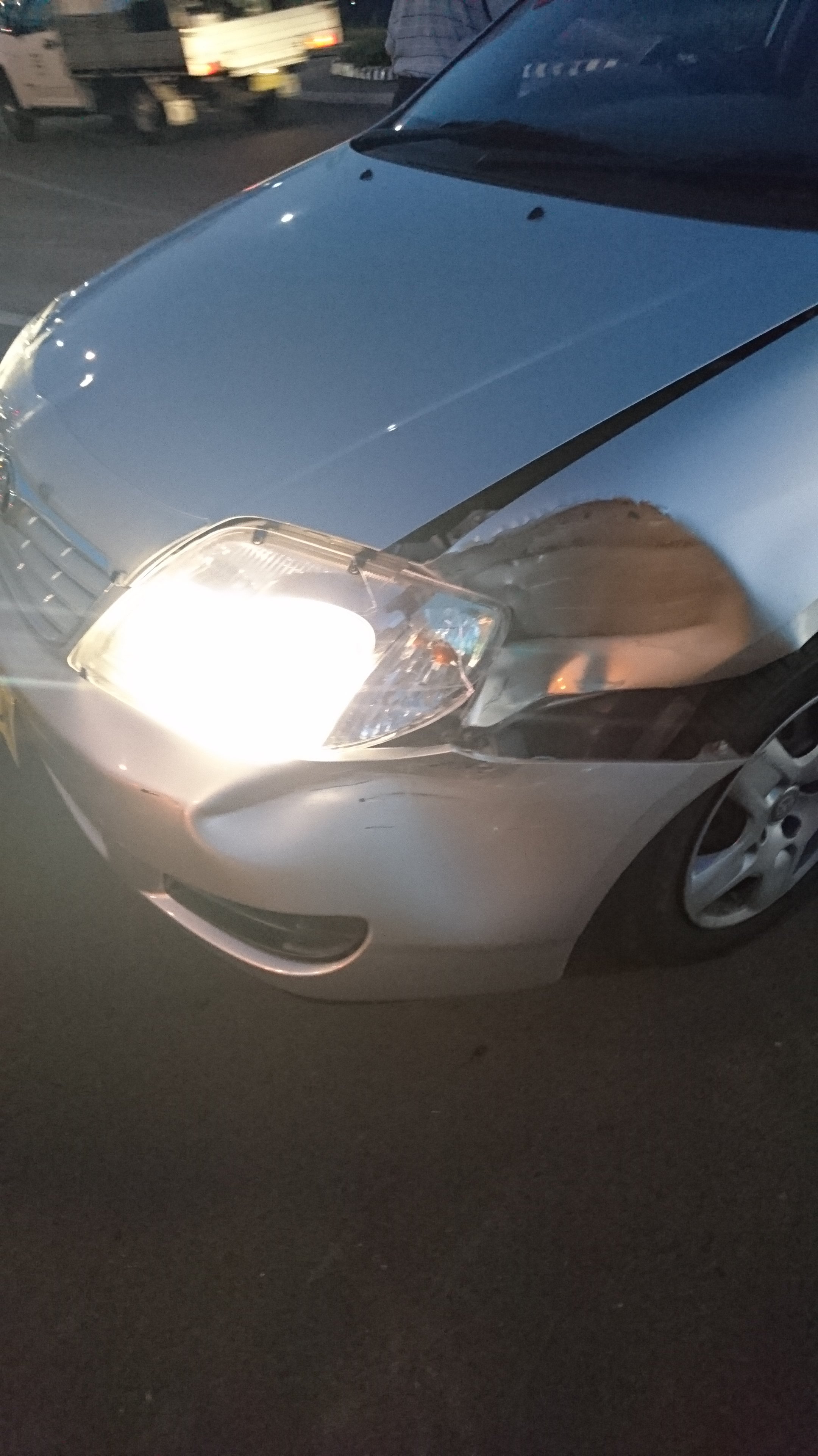

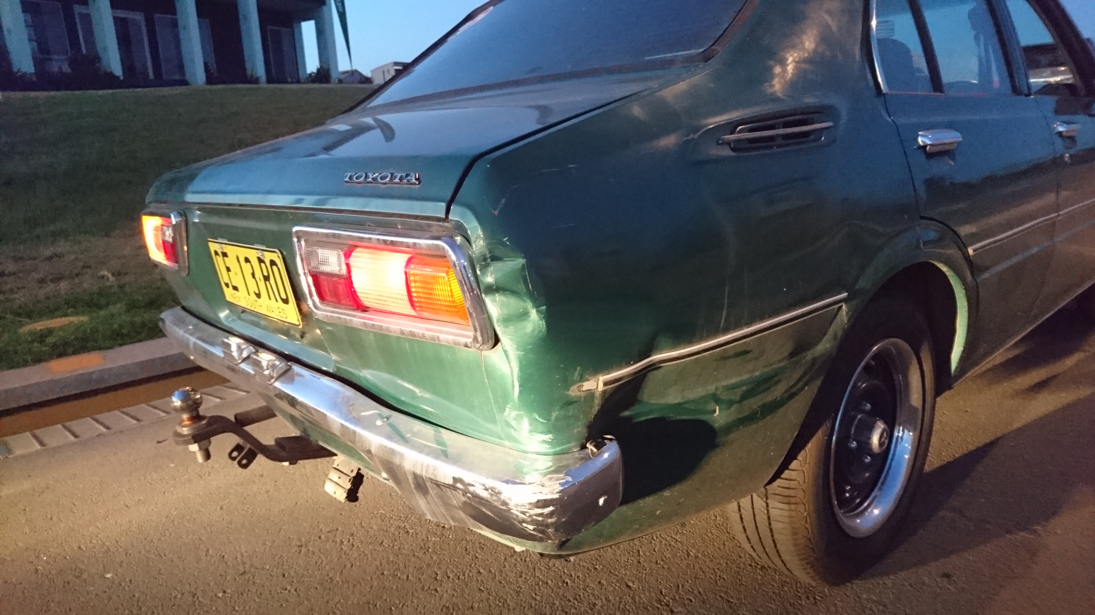

maccat01 Posted July 11, 2017 Author Report Posted July 11, 2017 In other news, the old green Rolla took newish silver rolla in the doot and has sustained some damage around the rear section. A 90 year old bloke was on his mobile while driving. Thanks to Shannons however, I got some cash for my trouble and salvage rites to the car. Week later I bought my pops 06 vectra with 36km on it and a new p plater promptly smashed into the back of that one too :-( same f#$king corner!!!!! The green thing is being shipped out to my mums place so the racing Rolla can move in. Will be keeping the green thing for my boy as his first car, but hes not quite two yet so plenty of time to work on it. I will be filming the rest of my build and posting it on my youtube channel. My mates have told me I have a video voice akin to Kermit the frog, but that aside, hopefully some of the new guys around he will be able to learn a few tricks of the trade. https://www.youtube.com/channel/UCiTUFBpihKUPv7QKit7J1Ng Regards macca Quote

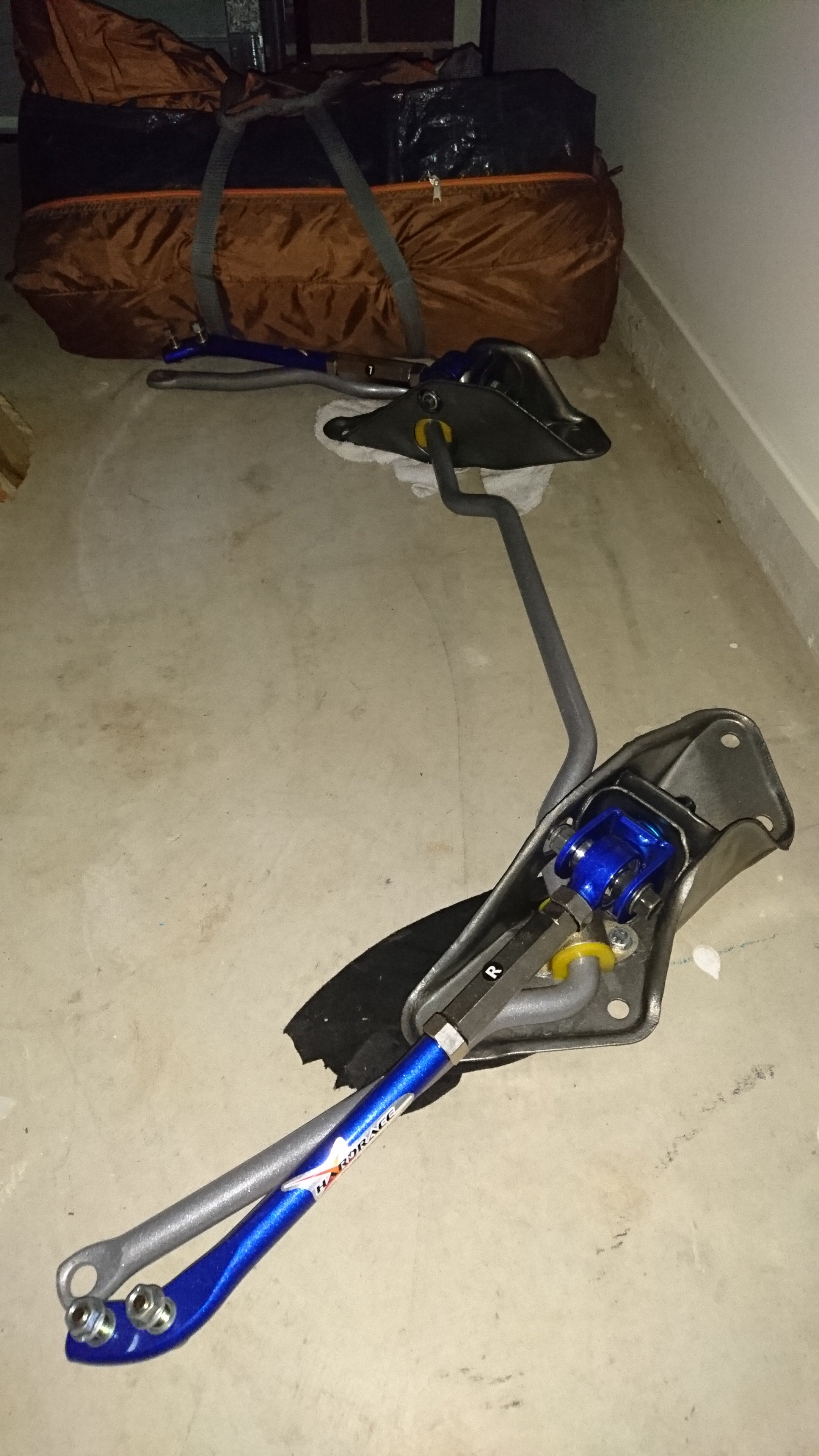

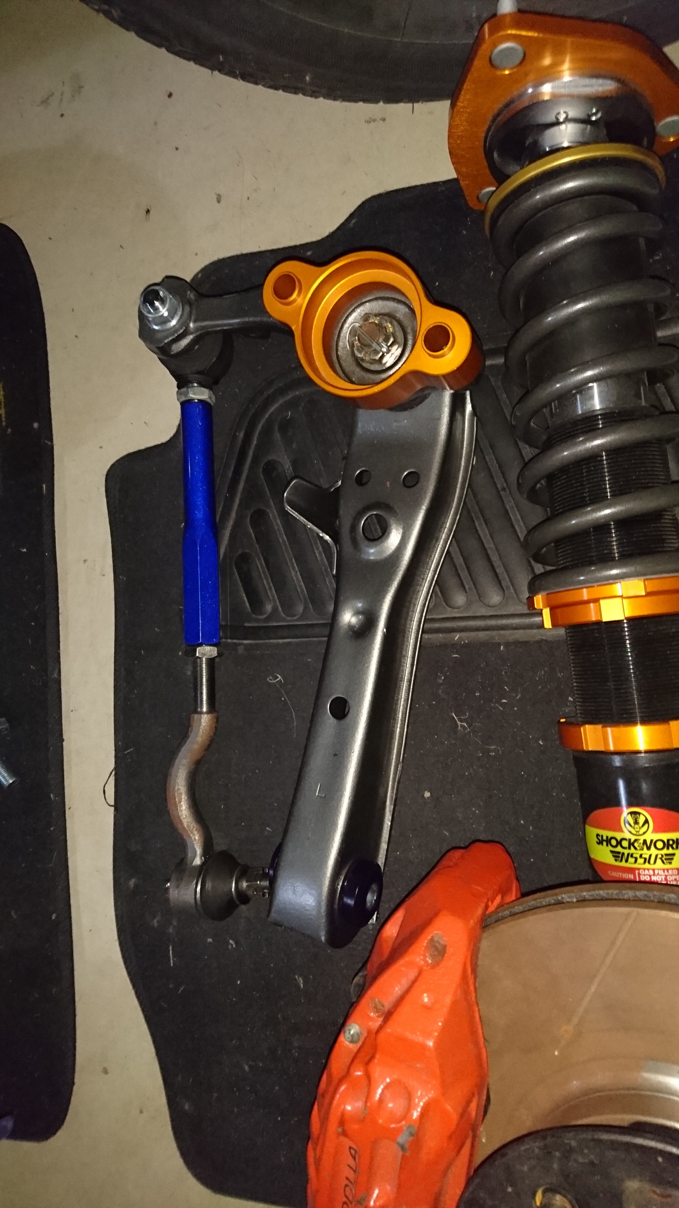

maccat01 Posted July 31, 2017 Author Report Posted July 31, 2017 Less then a month till the rolla is back. Here is some current work done Hopefully the best handling car in the land!!! So much spent on suspension and braking. Still have to repaint the blue bits orange, but untill i can find a cheap powder coater they will remain blue. Might be nice to have a bit of contrast to all the orange and silver. Quote
Taz_Rx Posted August 1, 2017 Report Posted August 1, 2017 Shocksworks are the shit! Have you sorted top hats/camber plates? I had to dick around a bit to get the t3 ones on mine. 1 Quote
maccat01 Posted August 1, 2017 Author Report Posted August 1, 2017 (edited) Hey mate. So shockworks built these as a bit of a bitsa for me. Purchased along time ago however. They are S13 silvia top hats, on an ae86 shock kit with ke70 internal shock valving. Rear shocks slighty softer then normal shockworks items as they are being used with the original leafs and not ae86 coils. I also optioned to get the rca kit aswell cause they threw it in for $80. They are a superb company to deal with and also did the welding on the xt130 spindles that are fitted. Macca Edited August 1, 2017 by maccat01 Quote
maccat01 Posted August 1, 2017 Author Report Posted August 1, 2017 How do they ride taz? Been keen to use them since i bought them. They been patiently waiting to be used for 4 years bahahahahaha. Quote

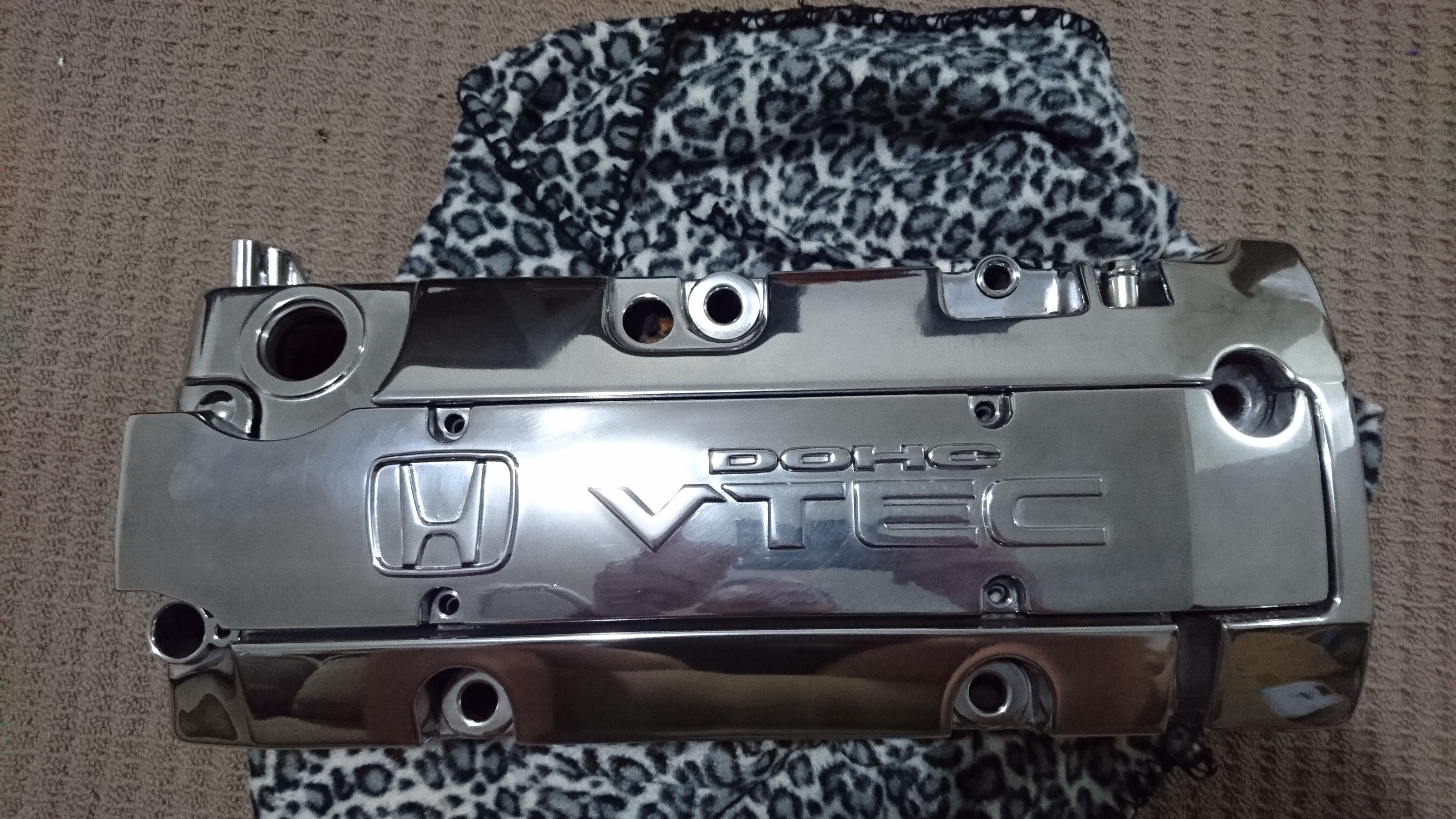

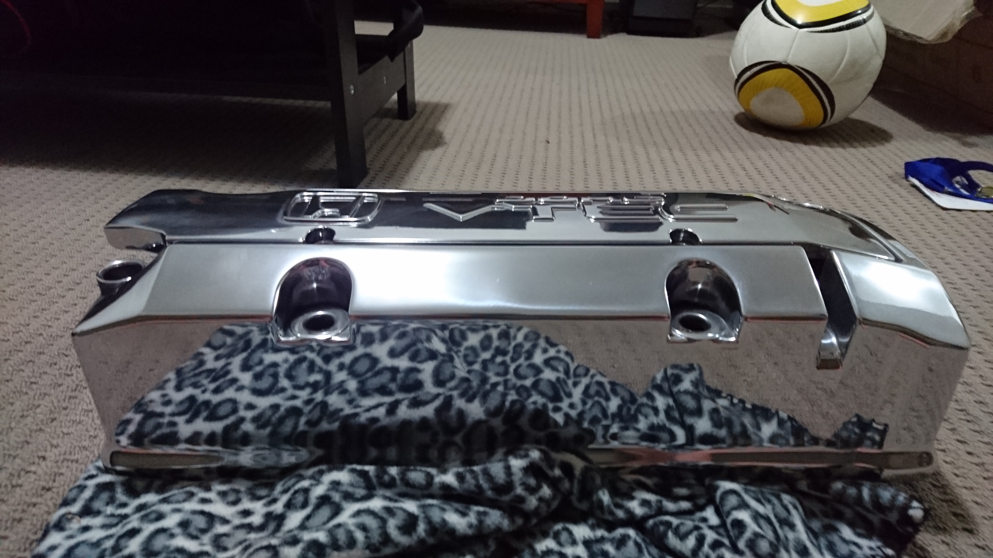

maccat01 Posted August 16, 2017 Author Report Posted August 16, 2017 So i been polishing aluminium parts like crazy. The rear quarter vents are up next :-D Quote
