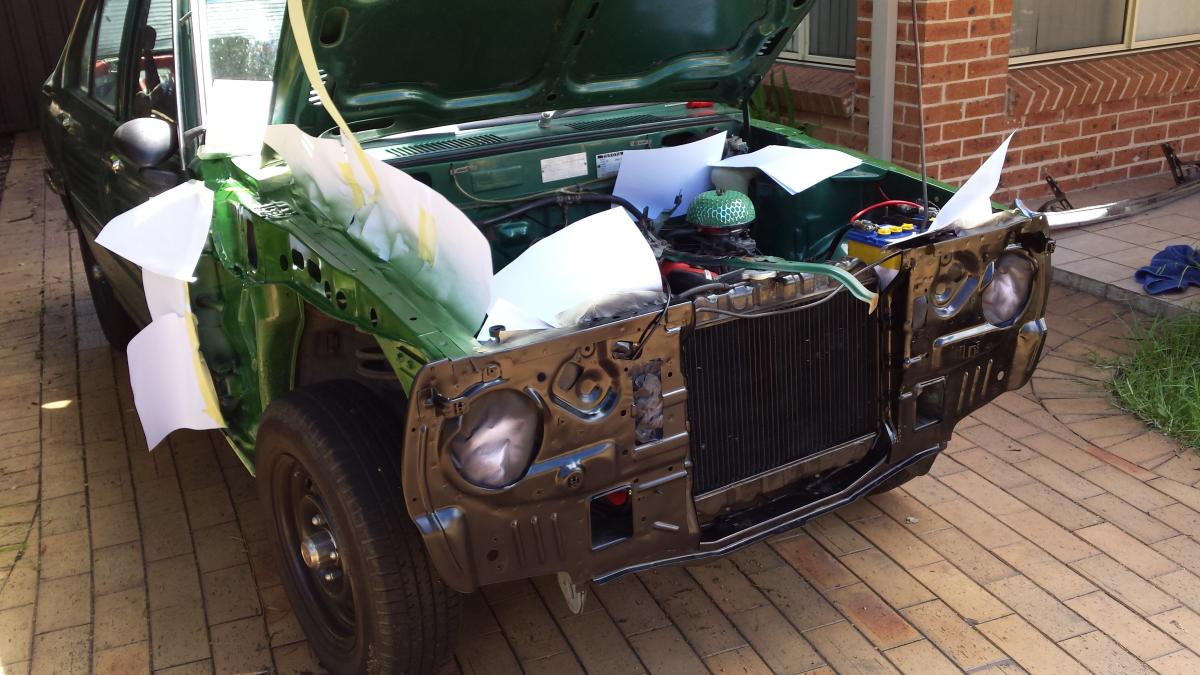

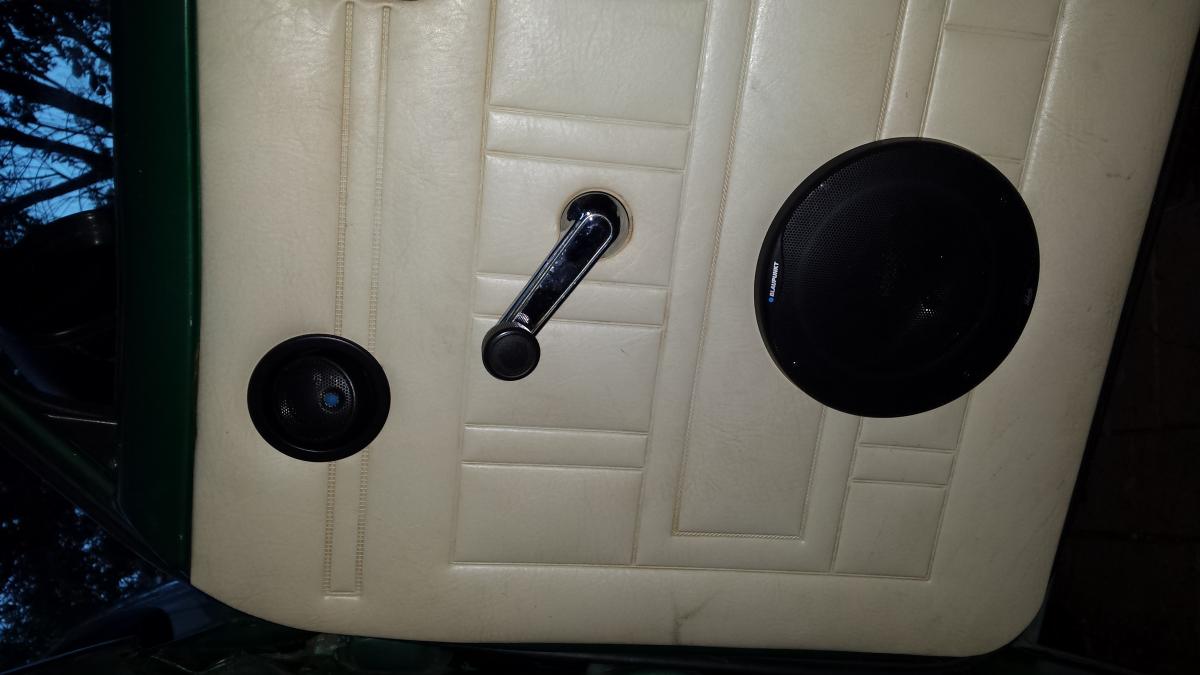

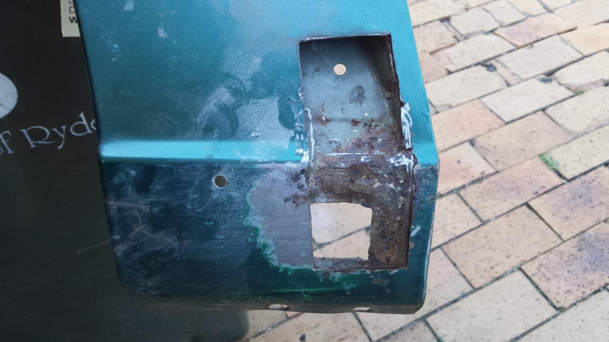

New front mounted transmission cooler has been fitted, the interior plastics have been sprayed, rust has all been repaired and brand new headligjts have been fitted.

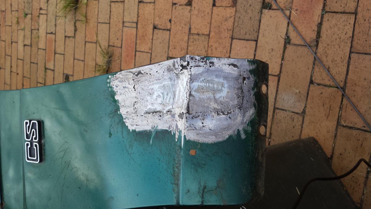

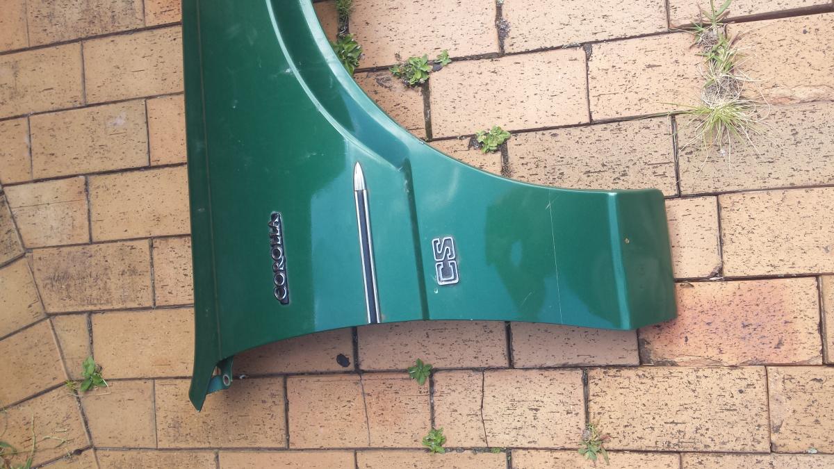

I know the pics posted of the guard repairs are from different side guards but they were both rusted out so i did the same repair on both sides.

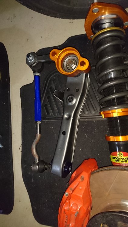

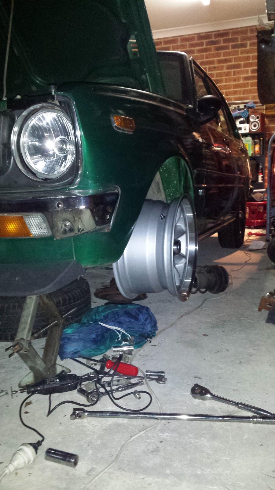

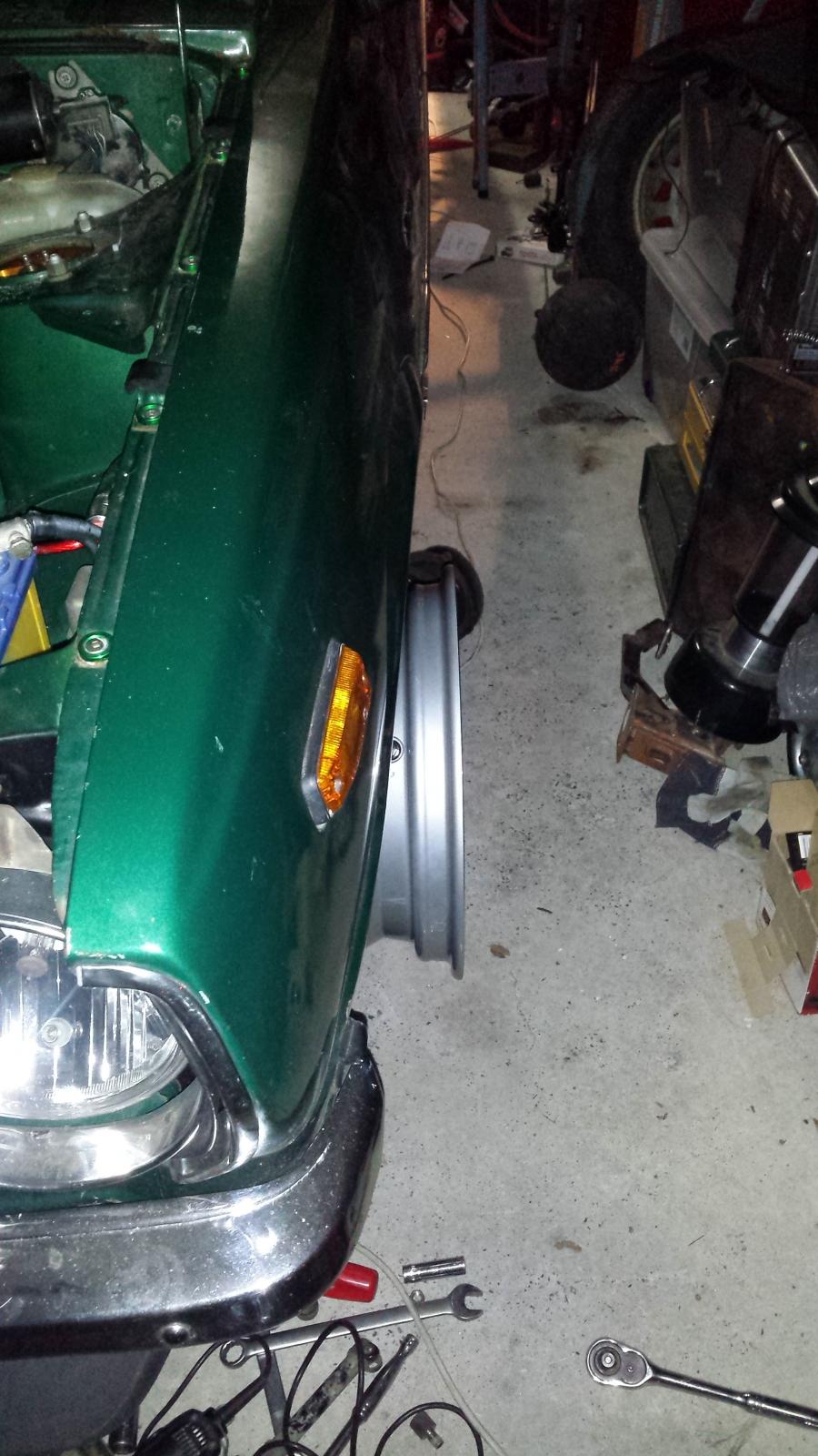

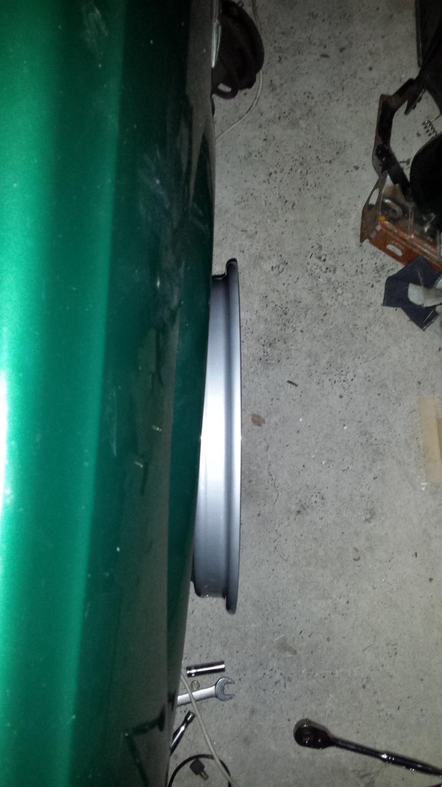

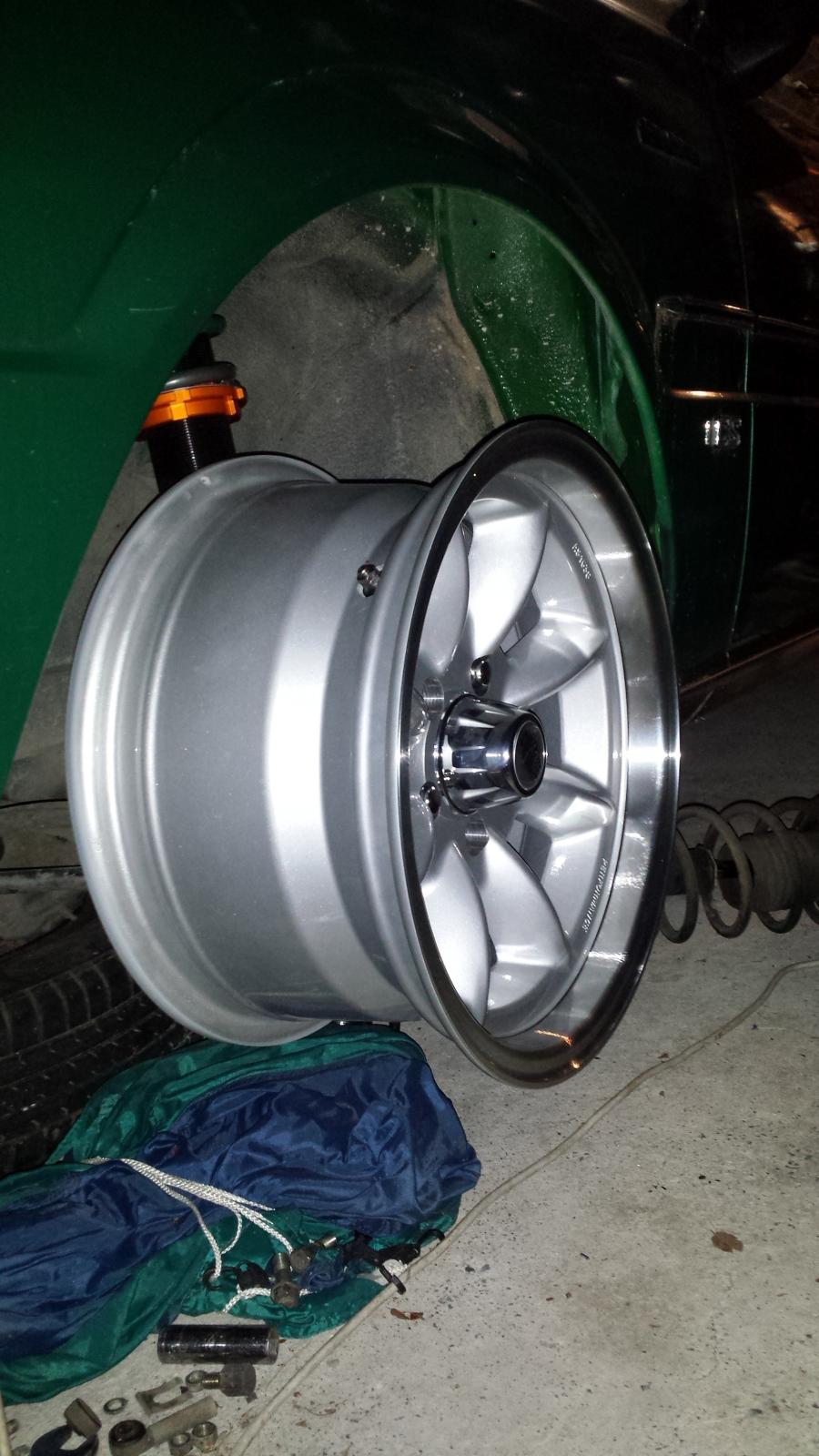

New superlights and coilovers test fitted on the daily driver.
They are 14x8 -4 offset superlites. Was not going to run them on all four corners but my 14x6 +25 superlites contact my cailpers about 3mm

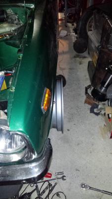

2 inch flares will be welded to the car front and back to cover the epic offset.

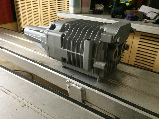

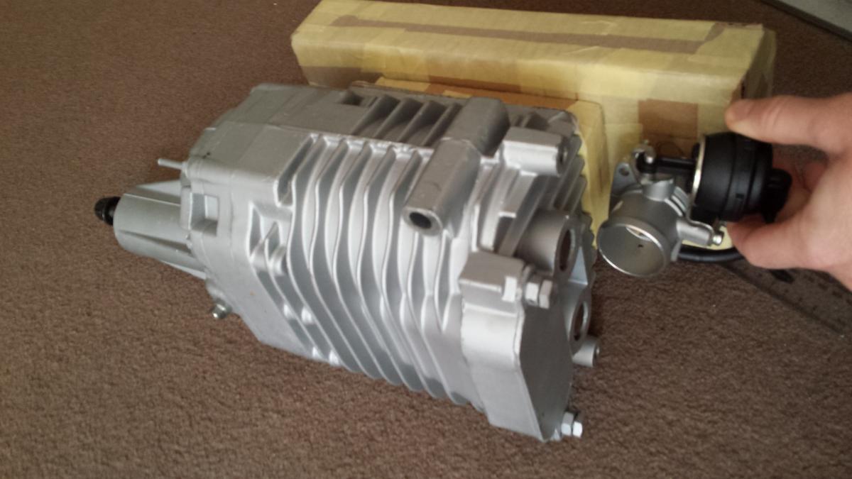

an eaton m90 supercharger is now being fitted to the f20c and will be running 5 or 6 psi. Not hoping for that much more power, just more of a mid range kick as honda engines arent known for having any torque.

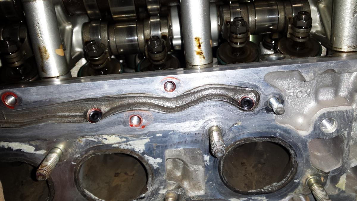

The intake manifold is being chopped up to remove the redundant secondary air valve, and the exhaust ports for the same system are being tapped and grub screws inserted as they are useless without the air valve.

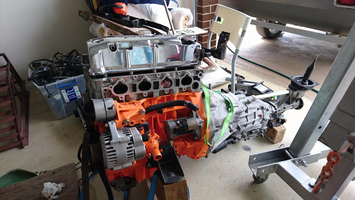

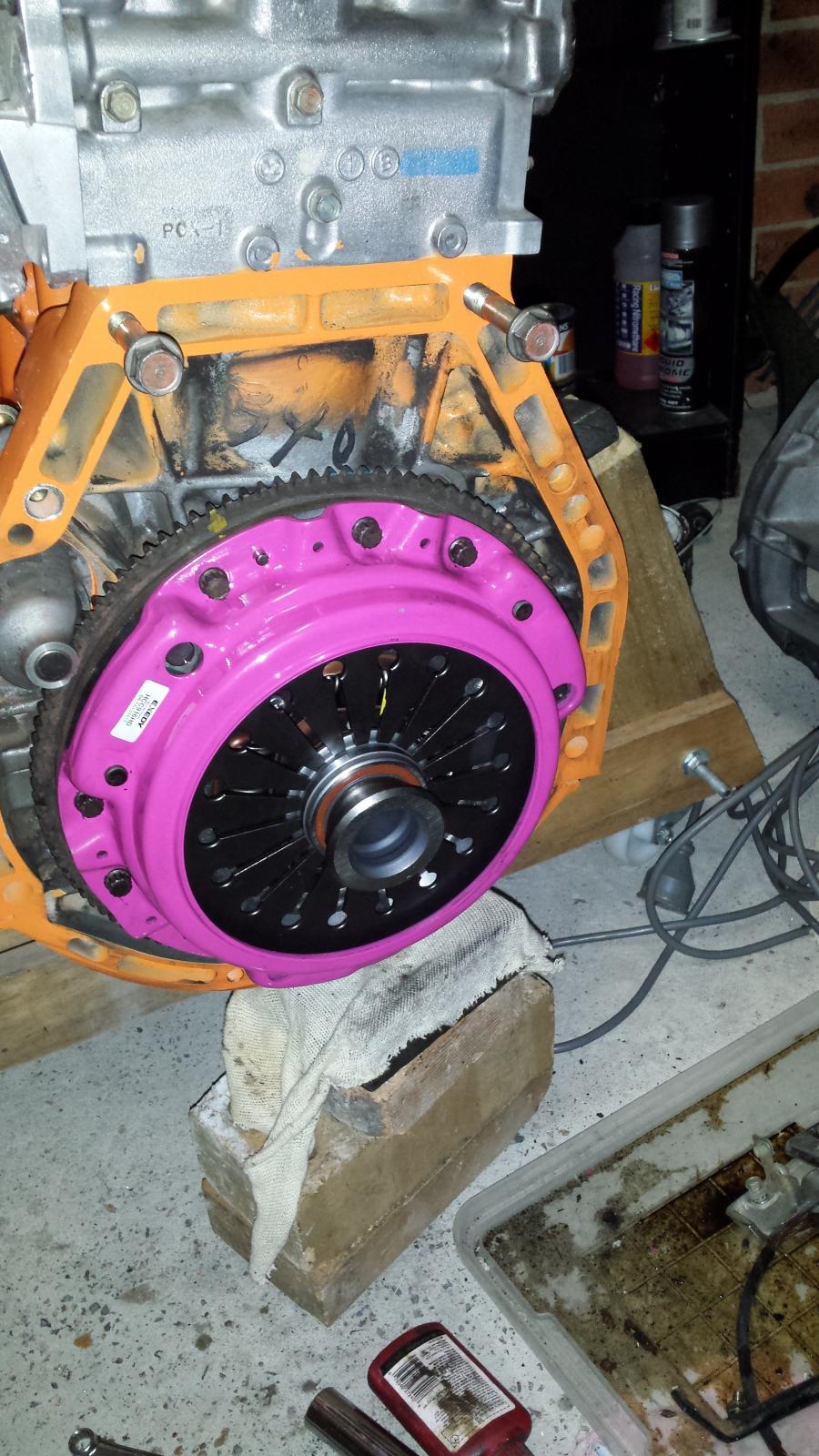

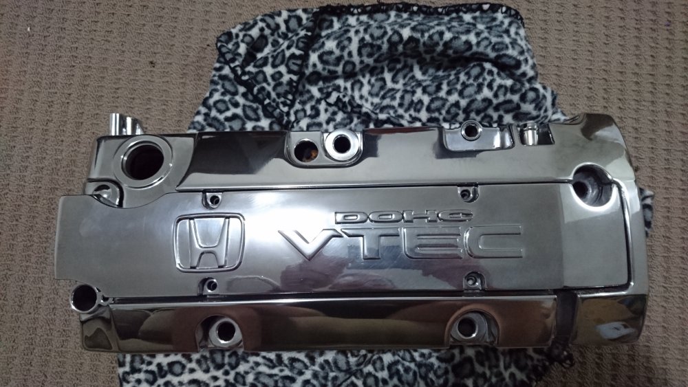

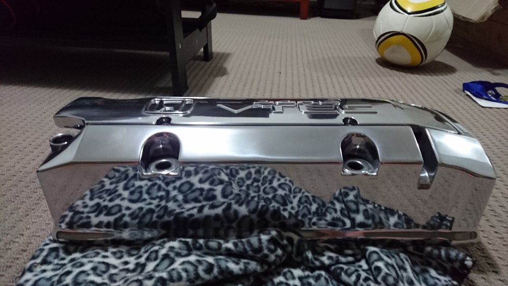

Engine has been fully rebuilt, down to every single bolt. It has been painted and most parts to be polished are 90% done.
New exedy hd clutch is purchased.

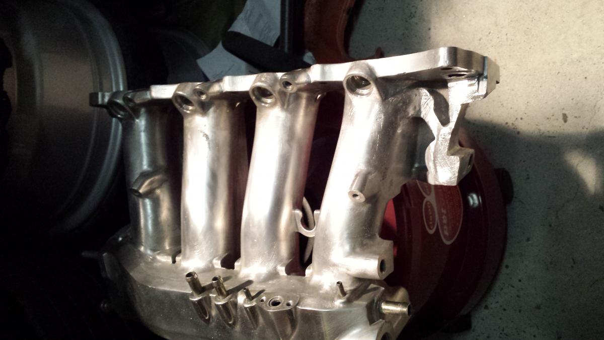

Manifold is currently being cut up to fit the supercharger and is having a water to air intercooler installed inside the new plenum.
Have also removed all evap system and secondary air valve system and have managed to remove about 15kg of defunct polution gear. Tapped and screwed grub screws into the exhaust ports for the air valve as its no longer in place.

I have done the calculations and to have 7-8 psi the charger will be spinning at 9700 rpm when the engine is at redline (9200).
The m90 max rpms is 12000 so I will be well below the superchargers maximum speed. The roots style charger is a very efficent air heater approaching its max rpm so this is why I cannot run more boost as even with a a2w intercooler the intake temp will be quite high.
I have negated the need to run a clutch on the charger by using a bypass valve off a mini cooper s ( the little throttle looking thing). This is operated from intake vacuum and at anything other then full throttle the valve is open so at least half of the intake air misses the supercharger meaning better economy and less stress on the engine.

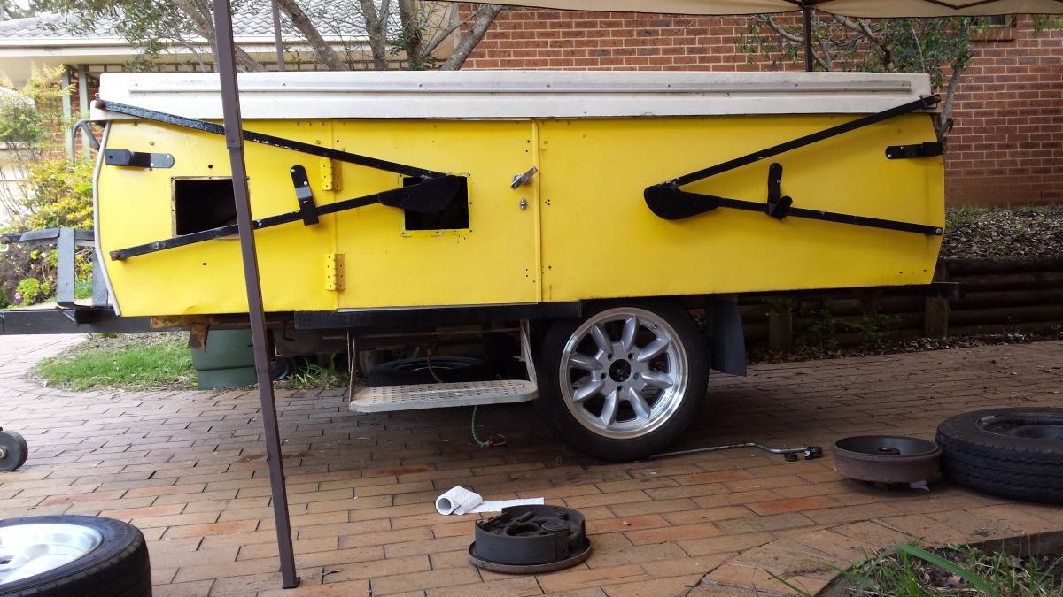

So my missus decided we should buy a caravan.
I have convinced her to let me style the outside and she can decide on interior finishes. So its going to look like the modified corolla so it will match for summernats :-)
This may be the only caravan to have ever been fitted with Yokohama advans :-/

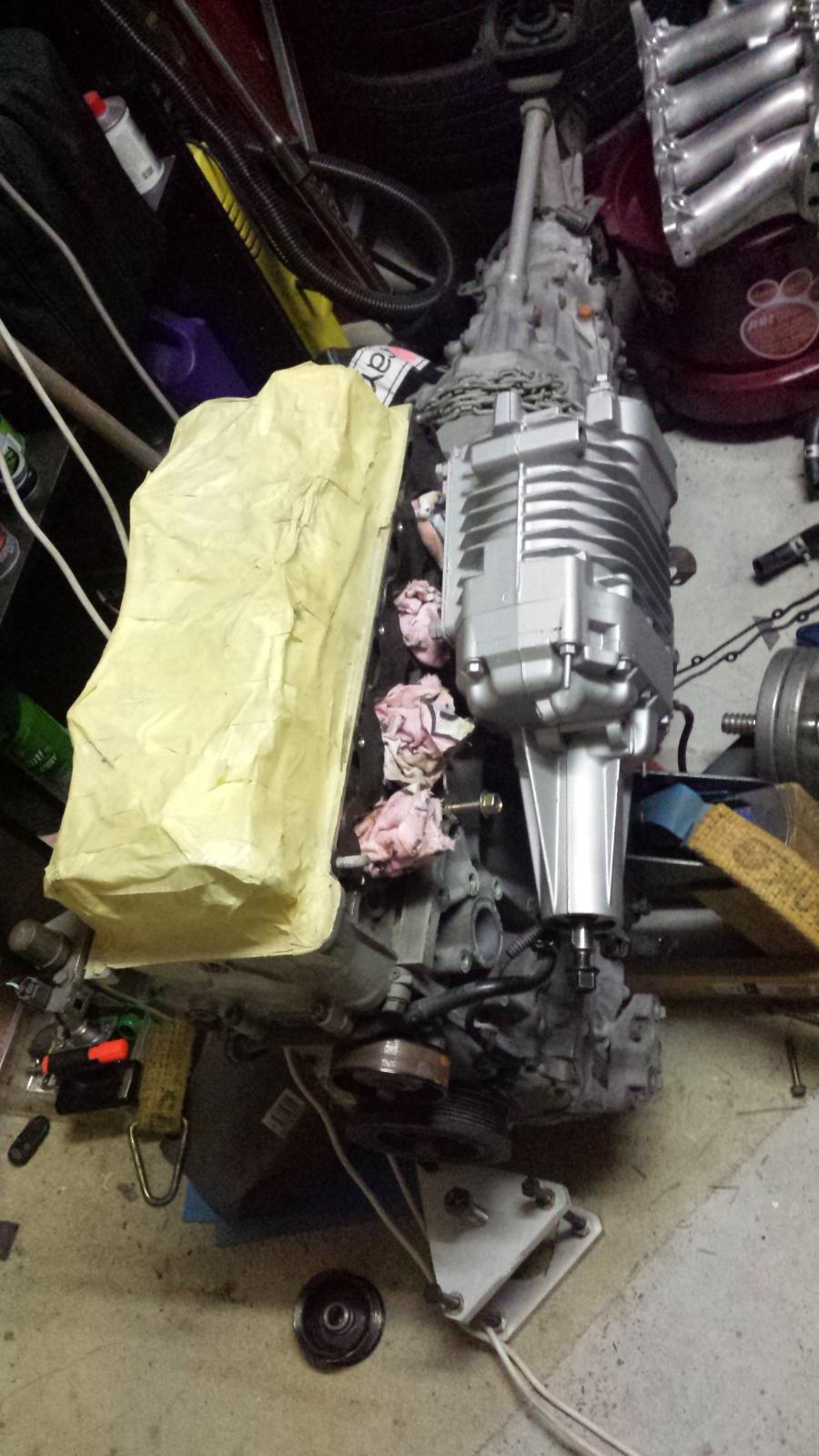

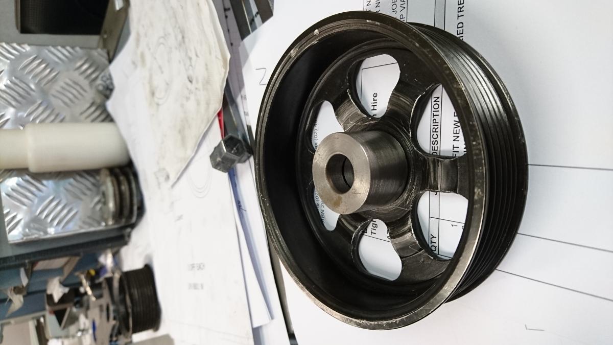

The blow is sitting next to engine to work out its positioning on the intake manifold. I am now searching for a 1.8L honda FD civic power steering pulley as that is the perfect size to spin the S/C up to 8.5 psi ( not counting loss throught the intercooler)
The wheels clear the strut by a small amount, so I'm very happy ATM.

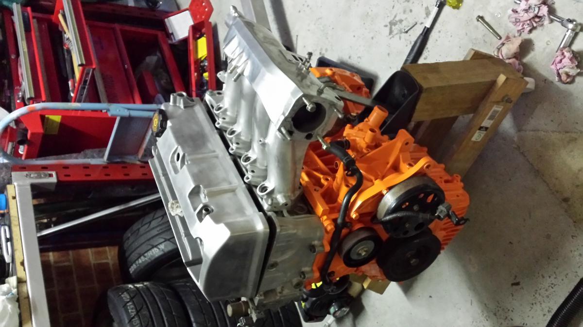

Engine back together and some bits have been polished.
Manifold is cut apart ready for welding. A 12x 5 x 2.5 inch liquid aftercooler is being installed inside the manifold to keep the intake air temp down.
Have worked out supercharger calculations and have had a Honda civic power steering pump pulley modified to get the psi of boost I require, which is 9 psi BTW.

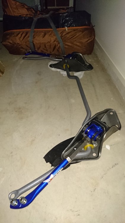

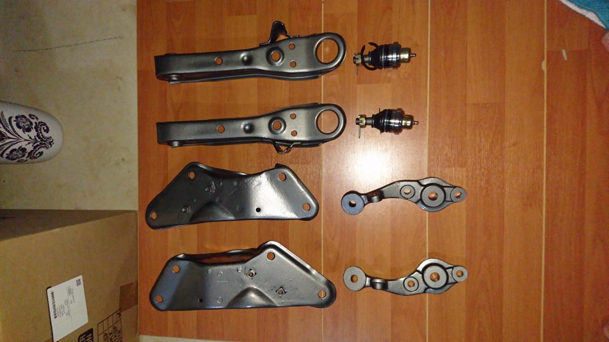

Have painted some more things and fully sorted the suspension. All ready to install into car.
