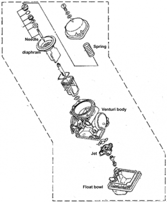

It looks like a Stromberg to me, similar to the SU but with a diaphram instead of a floating piston. With all the non-important bits cleared away it has the same layout as the SU.
You're right, the spring will give initial richening until the diaphram lifts the needle to match the airflow. SUs are actually amazingly complex in operation for such a machanically simple device. I suppose all variable jet carbs are, the mixture doesn't just depend on the needle & jet size, it depends on the velocity of air flowing over the venturi that sucks the fuel out. Even then, I'm not sure if its just velocity or if density is involved too...

Good point- how do bikes get around the lack of a pump jet? The SUs have the oil dashpot delay the piston rising so it immediately richens for a second or two when you boot it, but I haven't seen those on bike carbs.
yeah not sure tbh, just read other "bike carbs onto car motor" threads over the years which mentioned some don't come with accelerator pumps.
