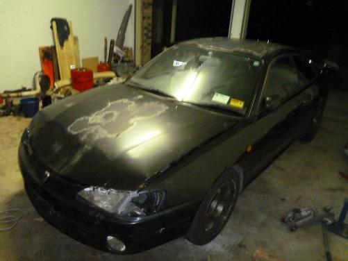

I've been wanting to put up my rolla for a while now but haven't had the time. Now i do so here it is!!

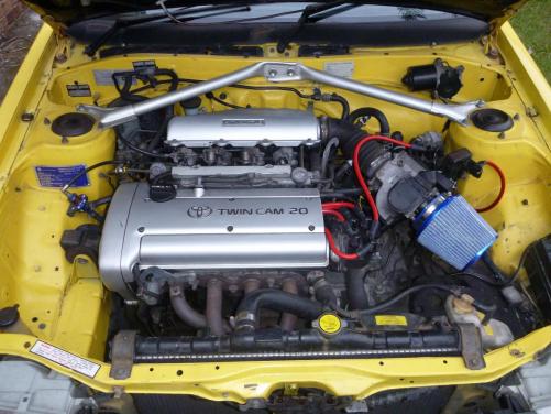

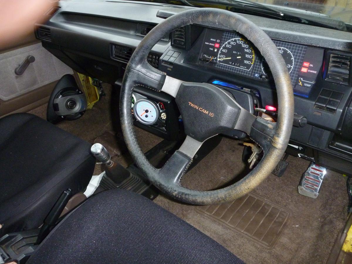

I bought the car pretty much as it is now only less most of the interior and a butt load of wiring issues, so when i got it i had to wire up all new lights, wipers, guages, dash cluster, tacho and speedo. I also had to replace all the plastic parts of the dash as they were in a pretty bad way!! Two new front seats new tyres and a very helpful roady guy later and it now registered!!
That said i am still having a few issues with the car that you guys may be able to help me out with.
The first and most prominent issue is the idle. When i start the car it sits at 1500rpm then once at running temp it sits at 2000rpm!!!!
I have google searched the crap out of this and come up with nothing excapt the obvious vacume leaks wich i have searched relentlessly for and found none. Next would be to replace the ISCV, but where to get one from???
My other problem is it over fuels and backfire's a lot! It has a fuel pressure reg set up but no guage, i have bought a guage and will put it in, but don't know what the correct pressure should be to have it set to??? Any help would be greatly appriciated.

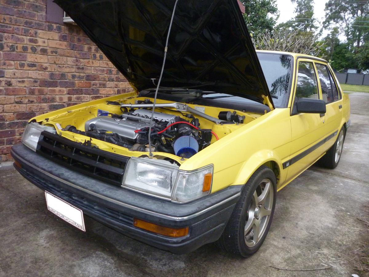

As it sits now it's pretty much a stock engine with an exhaust and a pod filter.... I relocated the battery to the boot to make way for a cold air box as the filter now is just sucking hot air straight form the exaust manifold and hating life!!!
I have a to-do list the length of my arm so i wont go into that now but first thing is to give it a good clean up, fix all the dints and a new coat of paint (get rid of the horrible black roller job on the bonnet and boot lid). Then it will be time for some more serious mods!!!!
