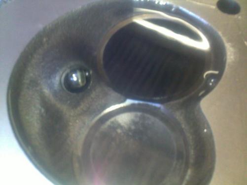

i cleaned the chambers on one hehad and wire brushed the ports, i'm gonna take them sometime this week to get machined :y:

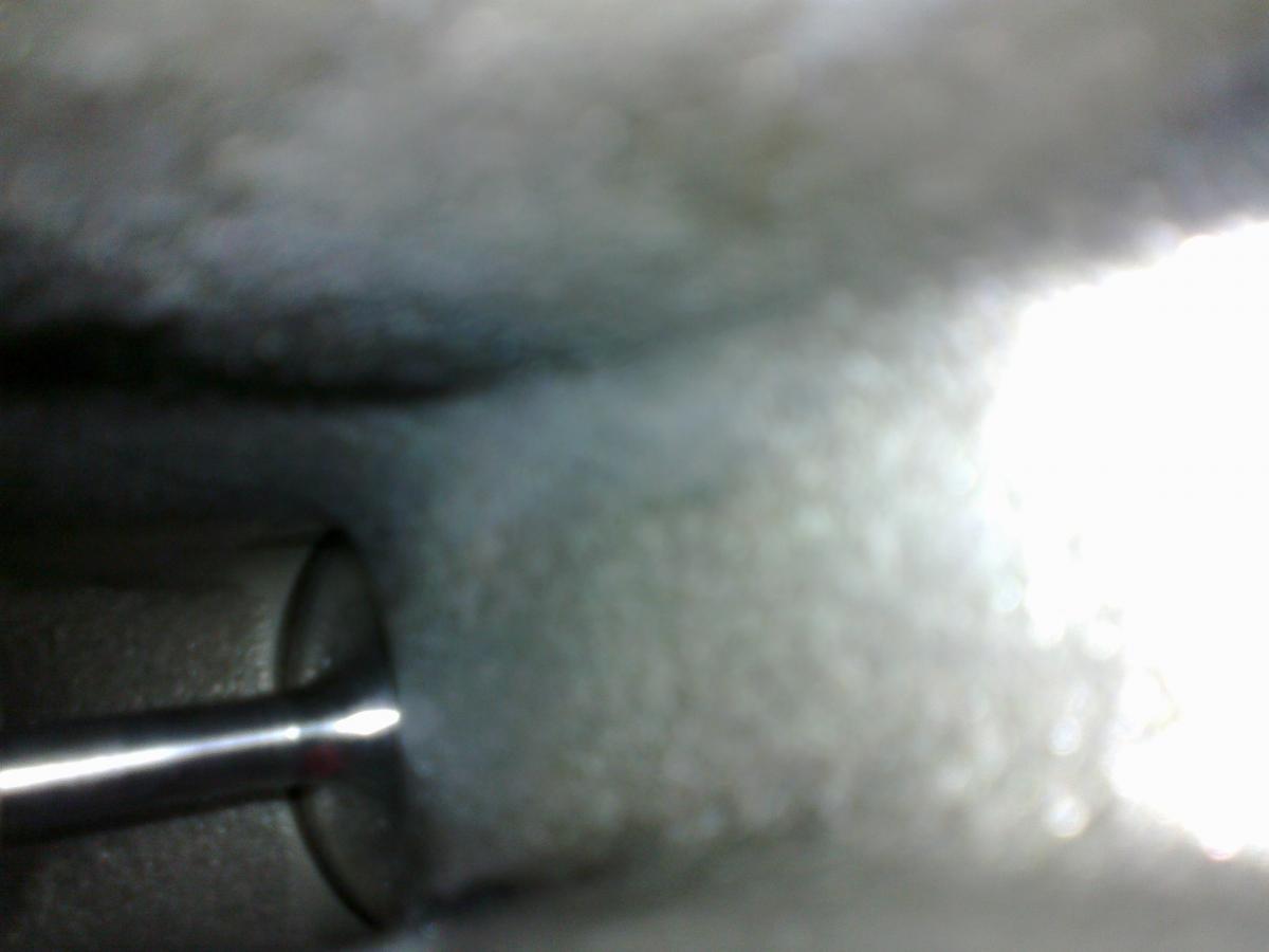

hello, cleaned the the heads up and took them in to get machined, and ordered a vrs kit, found out its a vy motor, all that i can find is different on them is 1.83 inch inlet valves instead of 1.80, and in saloon cars you can have up to 1.85 so they should be the goodsand different computer but mine is a vt one anyway, and i need a special one for saloon cars anyway, i got half the valves cleaned up and polished them too they look pretty good :y:

hello, picked up the heads today, they came up awesome and they acid tanked them to so they are all clean, i gave 2 valves a valve grind and put the new valve stem seals on and put them in, then checked the cc's i can have down to 54cc, and mine are 54.5 or 55cc so they are perfect, i'l start getting the old cam out tomorrow, hopefully the new one will turn up too haha :D

testing the cc's,
