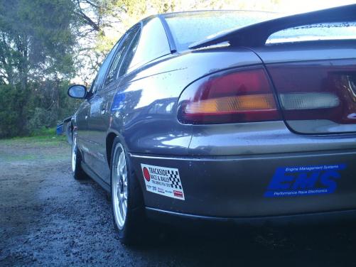

glenpos Posted June 25, 2013 Author Report Posted June 25, 2013 hello, finished off the dash, then got it out and gave it a wash :y: Quote
