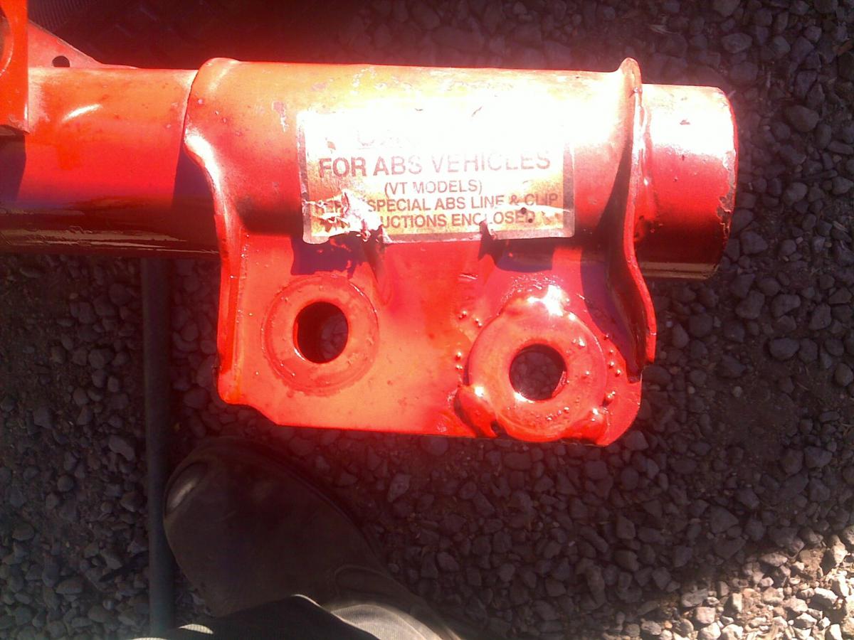

yeah iv'e been wanting to do the front end for a while now, i borrowed a mates mig, and i have to pull the power steering pump and rack out so might look at doing it then, i was going to mod the struts, but i need to get the saloon car ones so wont bother doing that until i get them, would be great if you could get a few pics, cheers

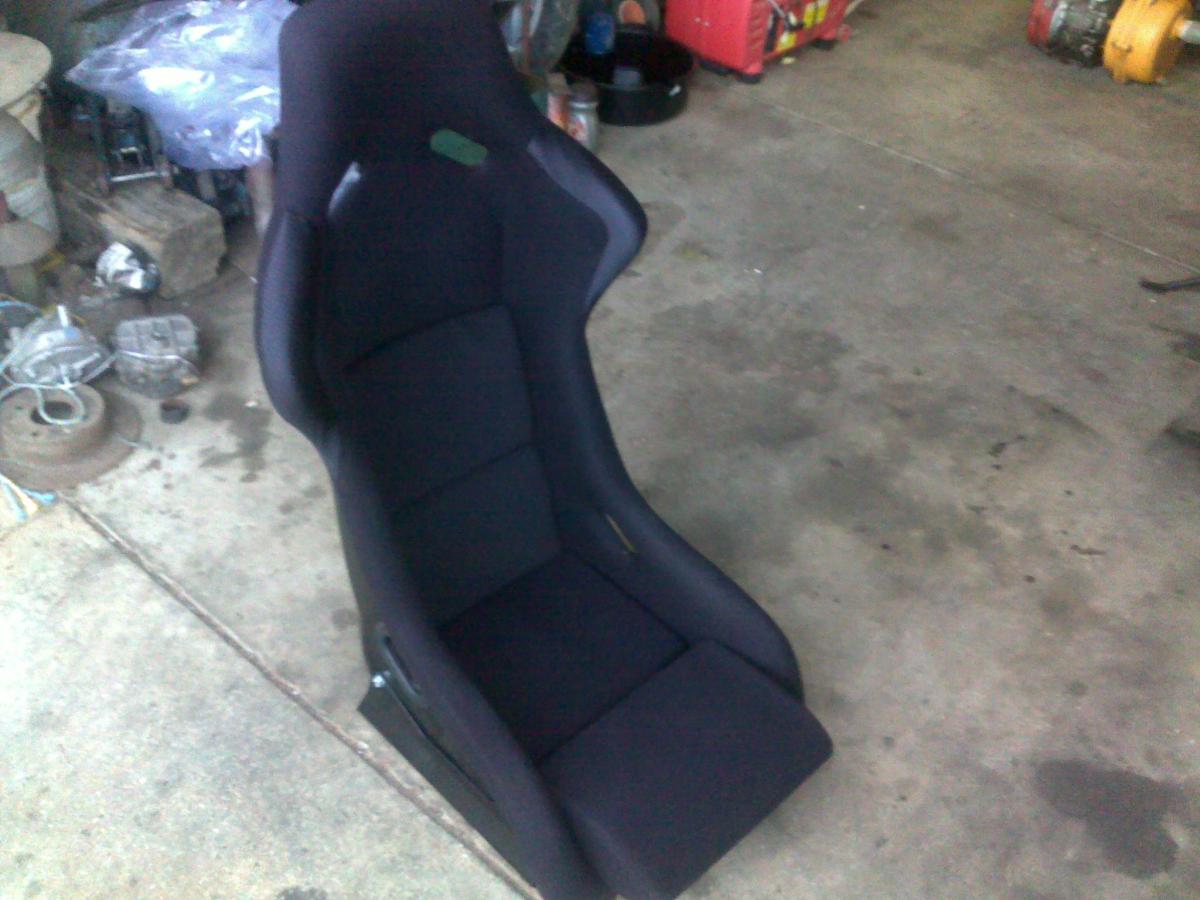

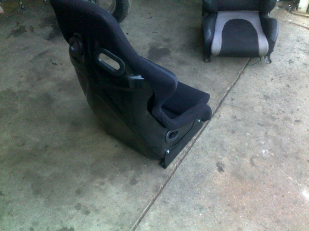

hey guys, iv'e pulled the power steering pump and the rack out, i'm thinking that the valve thats in the pump is stuffed, or the seals on the shaft that connects to the steering column are leaking, will have a bit more of a look today anyways, also pulled the bottom bolt out of the strut to look at camber, should be easy to do, will probably slot the holes and weld washers over them in the next week, looked alot better with some camber haha, also got a new fixed back race seat, just have to make up some mounts :)

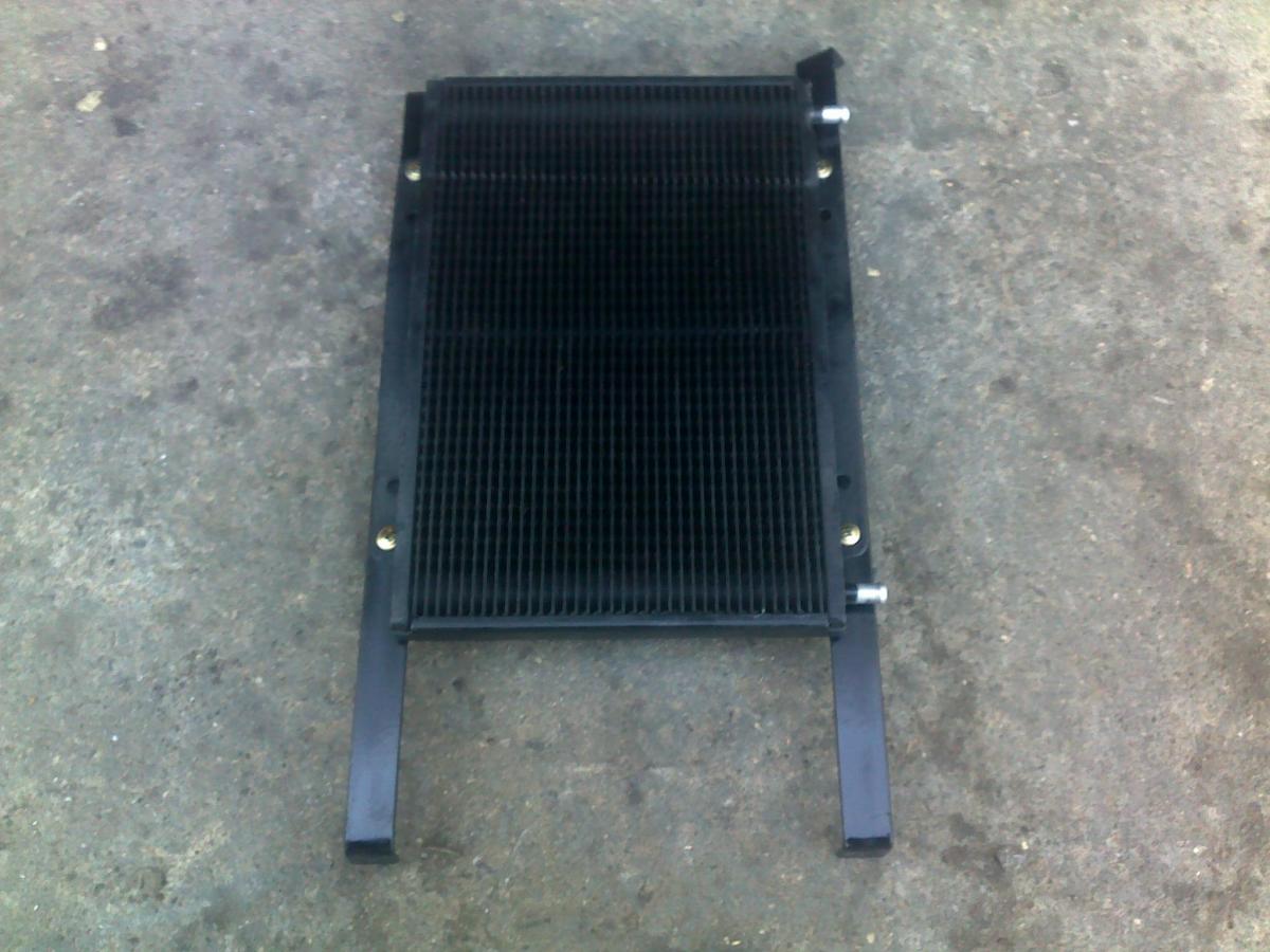

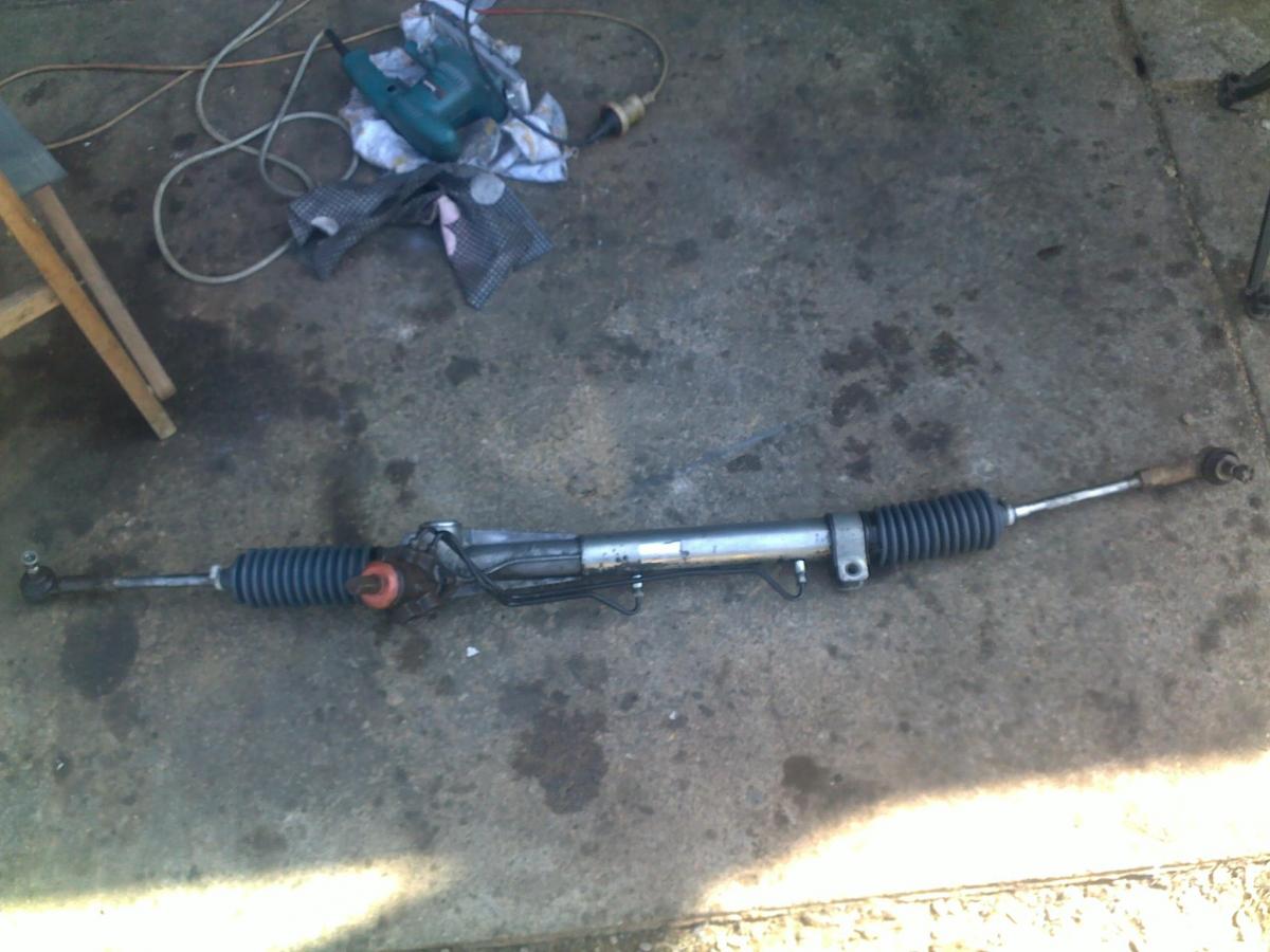

hey guys, got a few bits done, i gave the rack a clean up and put it back in, and got a pump off a mates car and got the power steering working again, also mate up seat mounts, forgot to get pics of it in the car though, also made a mount for my power steering cooler i got off a mate, just have to run hoses, so will finish that off tomorrow :)

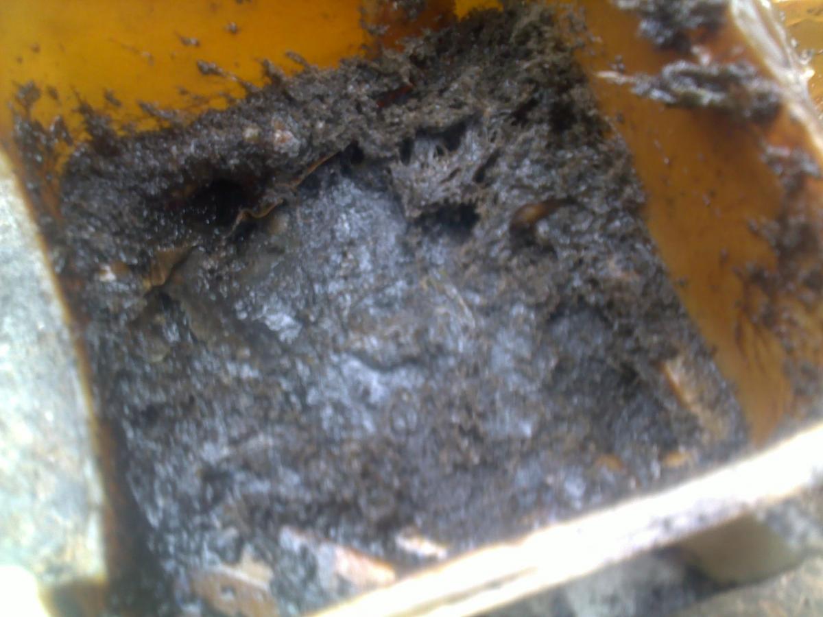

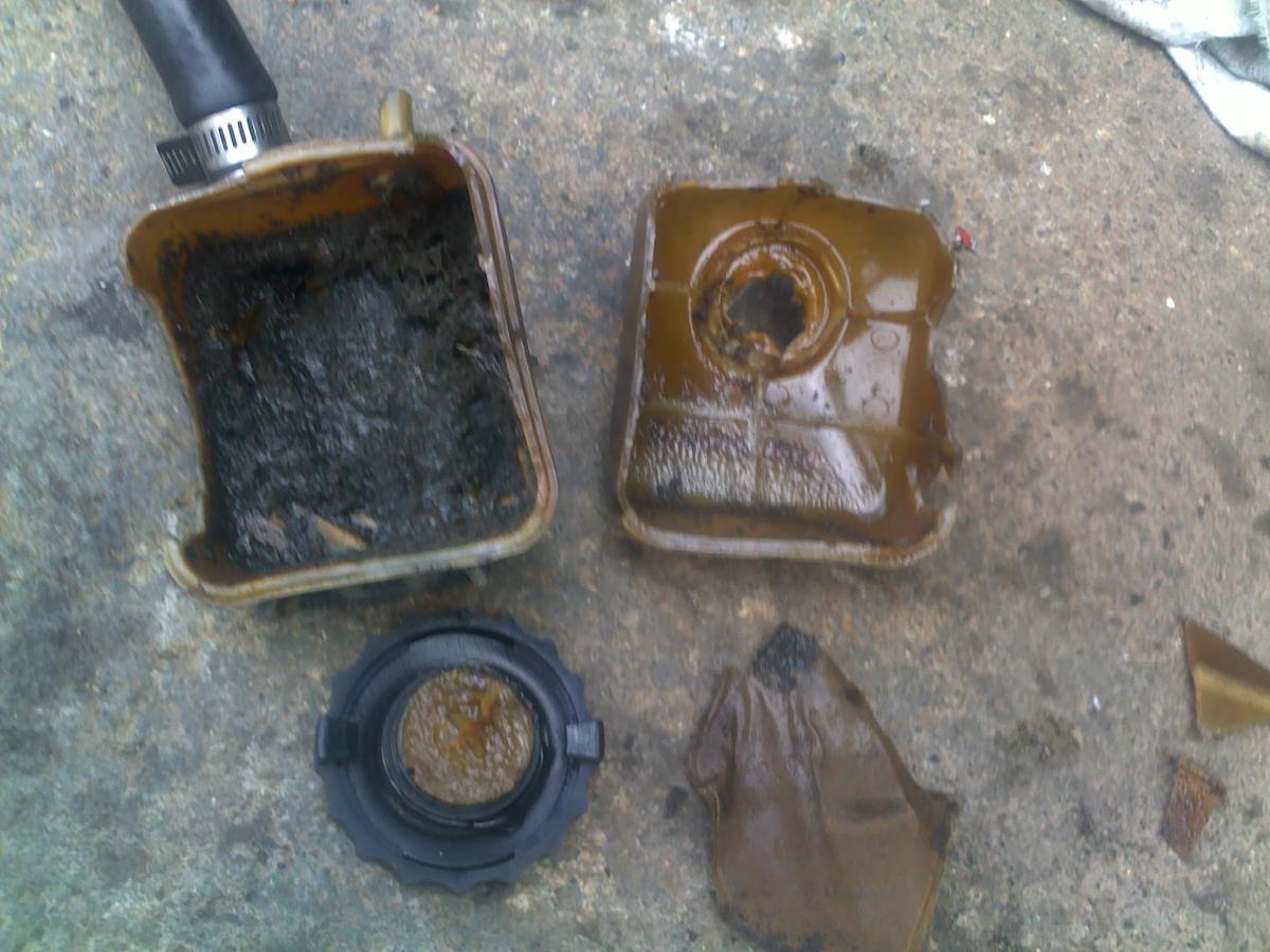

also smashed my old pwr steering reservoir open because i couldn't find the melted plastic.
found it haha, it had melted the filter out of its place also haha
and the rack, had a pedders sticker on it and has blue boots on it,
and the oil cooler, again forgot to get pics of it on the cars haha

yeah i got some skills haha, i think the new pump is pretty stuffed, its quiet and works when i first start the car, then gets noisy and starts to get notchey and then stops working until i turn it off, then once it cools it then does the same again, so think i'm gonna try putting the valve in my old pump that appears to be all good apart from the valve, and if it keeps doing it i'll pull the rack completely apart and check everything, and if i can't fix it i'll replace the rack, everything else looks perfect.

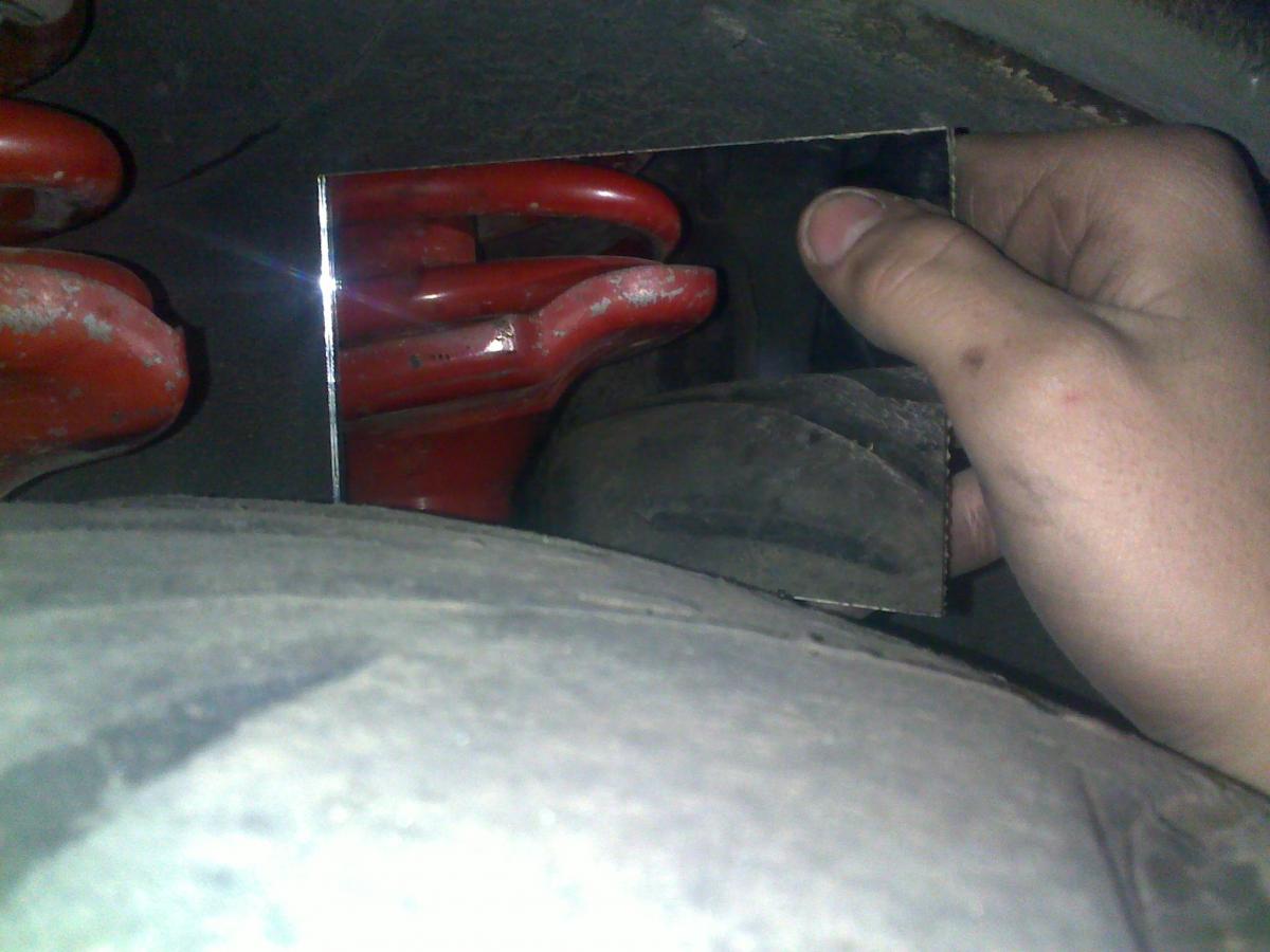

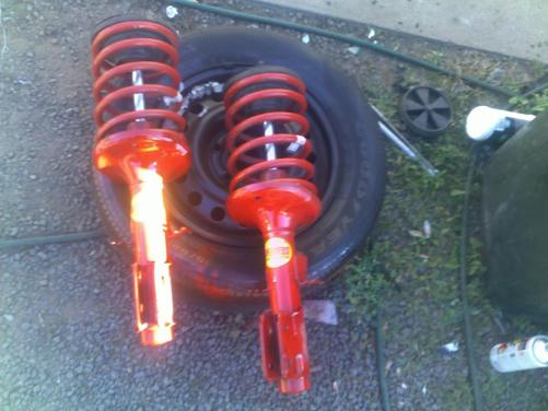

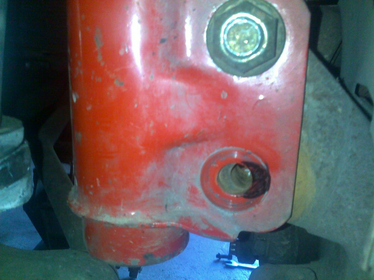

hello, playing with the front end atm, iv'e marked out where i want to slot them too, then will take them down to a mates and borrow his mig,
front has a little bit more than the back,
just misses and i can adjust the top out if iu have to

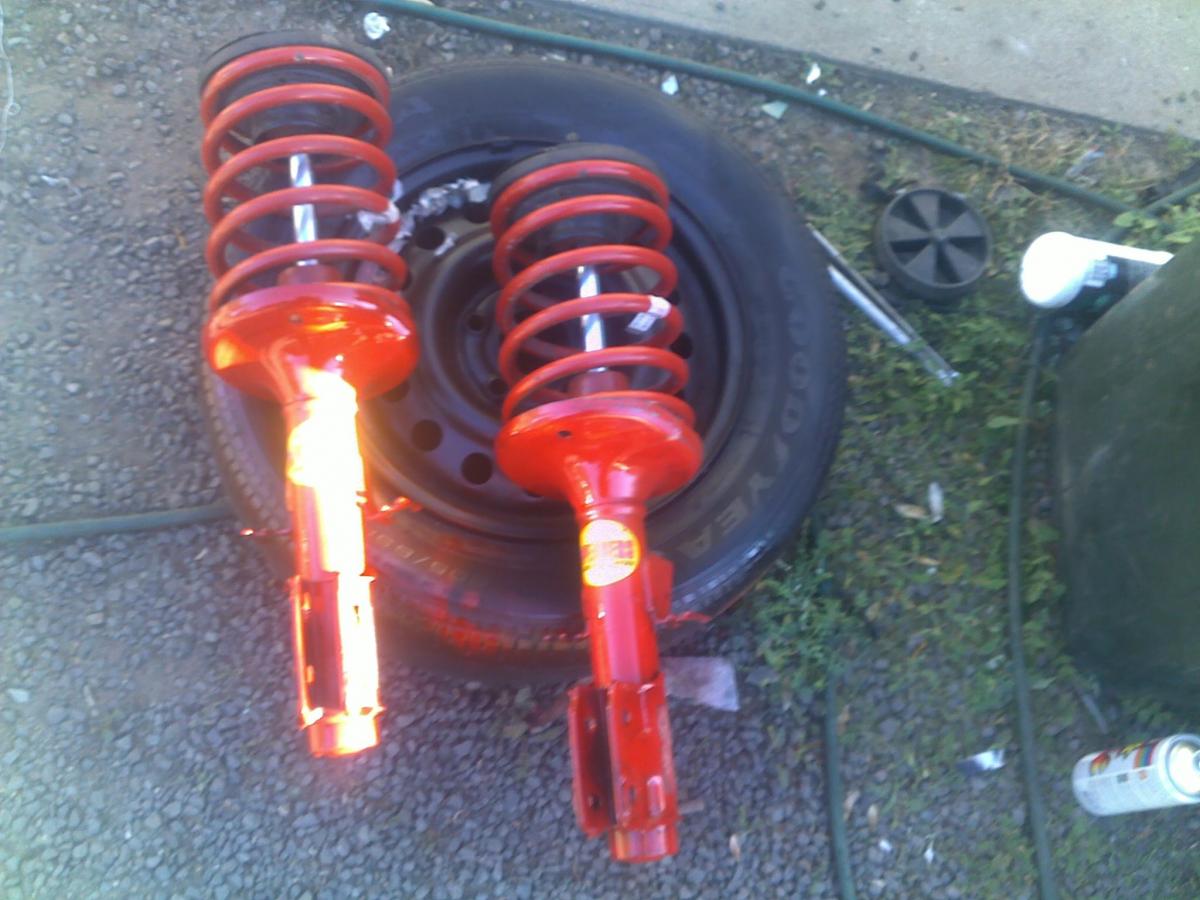

hello, did the struts on saturday and put them in yesterday, looks heaps better :P
gave them a quick coat of paint
much better
