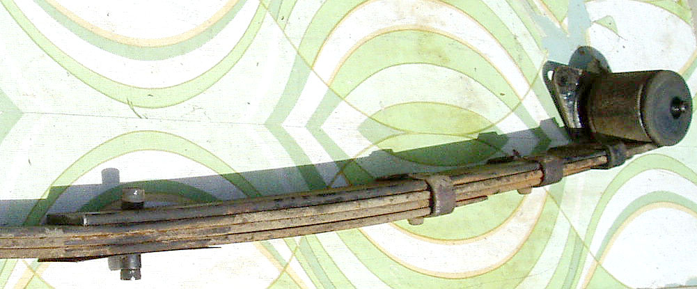

mat_jey Posted July 12, 2012 Report Posted July 12, 2012 I've been in the situation where I wanna low my KE72 Wagon too. Since one side of my leaf spring worn out badly including the rubber bushing, I end up getting my self a locally made brand new leaf spring. I'm happy with the new leaf spring now.. is just that I'm not getting enough lowered even with a 3" lowering block.. New Leaf Spring https://picasaweb.google.com/lh/photo/GHms2jFKDcifrqFGa5dBlkefL4LhXVmzgHMzd-Ilf_I?feat=directlink Lowering Block https://picasaweb.google.com/lh/photo/T-S9WffebSRRvwXHNb_Z6kefL4LhXVmzgHMzd-Ilf_I?feat=directlink Quote
flyinwall Posted July 12, 2012 Report Posted July 12, 2012 take those lowering blocks out straight away and get some proper ones as those look like they are crushing already Quote
altezzaclub Posted July 13, 2012 Report Posted July 13, 2012 Yeah, that doesn't look good. There is tremendous rotational force on the diff when you drop the clutch, so the diff will try to spin inside the U-bolts, and you have given it a lot of leverage with such long bolts. I suppose if it crushes a lowering box it will sway around and you'll feel the car move all over the road. Should be quite a wild ride! Many years ago I converted the 4link in a Stanza rally car to a 5link, and it didn't tear out the rear floor as I worried it would. The rotation torque pushed the lower arms forward and ripped the mounts off the floor. Rob & I took a spare leaf from another leafpack and cut it off just behind the u-bolts, then fitted it upside down in his leafpack. We took out the bottom leaf to keep the leafpack the same height so we didn't change any bolts etc. . It forced the other leaves to sit flatter and acted as an anti-tramp link by stopping them winding up, but his lady gave up motorsport soon after nad we never really sorted it out. Quote
