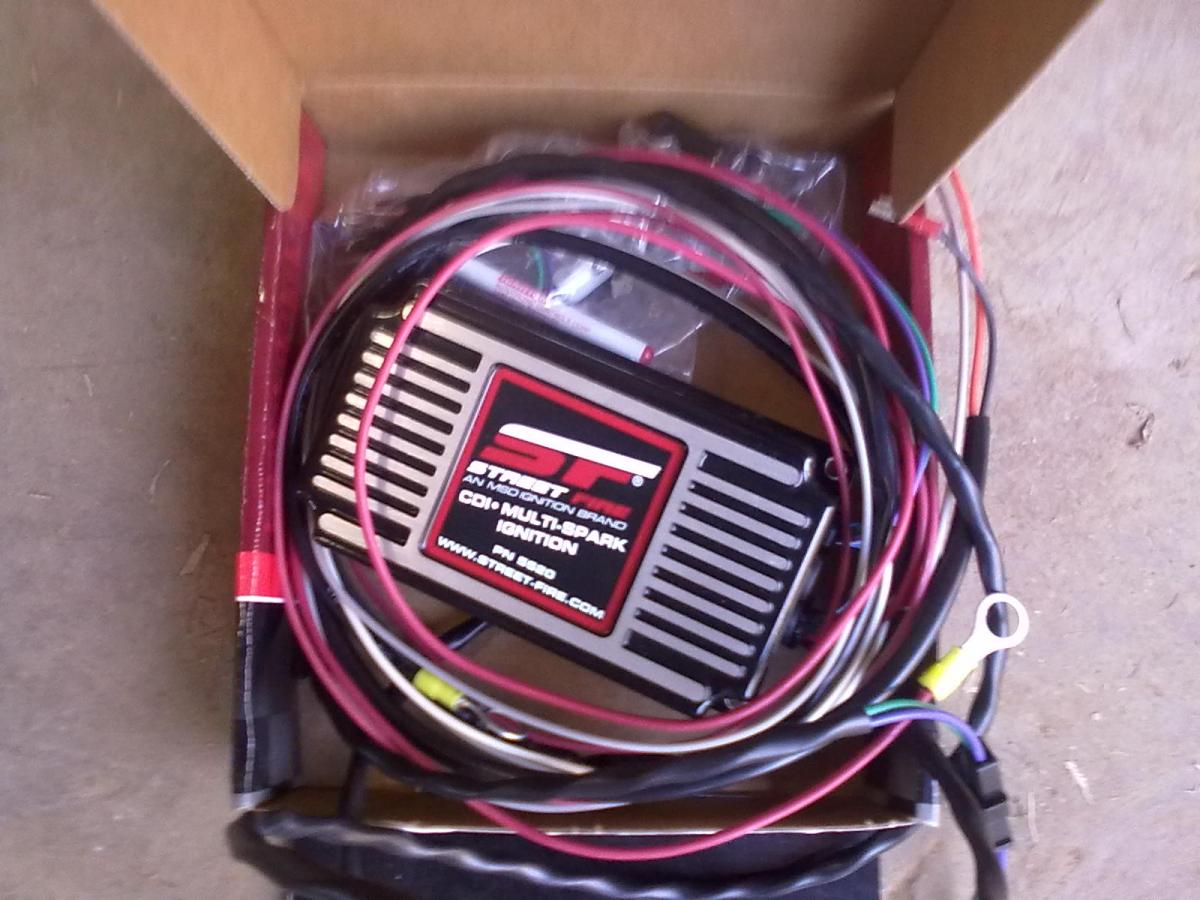

GJM85 Posted April 25, 2012 Report Posted April 25, 2012 On 4/25/2012 at 2:20 AM, Token said: I understand CDI is probably the way to go, but I don't have a spare $500 floating around, and even if I did, I'd probably just spend it on beer and hookers. You mean a CDI like this one I recently removed from my ke20? Quote

GJM85 Posted April 25, 2012 Report Posted April 25, 2012 (edited) I was using this CDI on my KE20. GT40 coil, 3k points dizzy with adjustable dwell. I've had no problems with the unit. I removed it because I was having a charging problem my car and coulkdn't work it out and removing the CDI I though might have fixed it. It turned out to be the alternator regulator and I haven't been bothered to put it back in. It still works fine. Heaps easier starting and an even idle. Didn't notice a great deal of difference in the performace department. For some strange reason it even prolonged the lift of my breaker points in the dizzy. http://www.street-fi...diignition.html If your really really keen on it I may part with it for 12,000cents (120$) ;) Edited April 25, 2012 by GJM85 Quote
