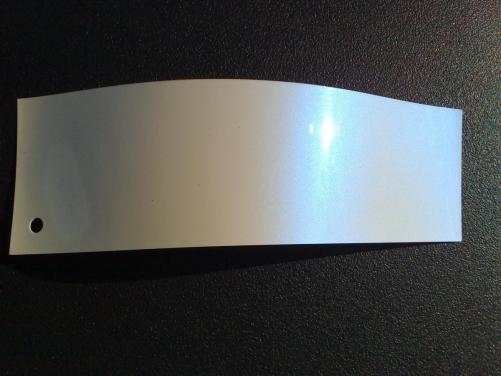

JJT036 Posted May 1, 2012 Report Posted May 1, 2012 (edited) Dad mixes paint everyday, and he says the Lexus Pearl White is an awesome colour. It's a 3-layer pearl colour too. Looks great under the sunlight. If not white, I'd vote for another candidate: Voodoo Blue from the VE SV6/SS, and Cruze. Awesome colour. :yes: But at the end of the day, it's your car. The colour choice is all up to you. :) Josh :cool: Edited May 1, 2012 by JJT036 Quote

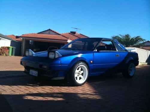

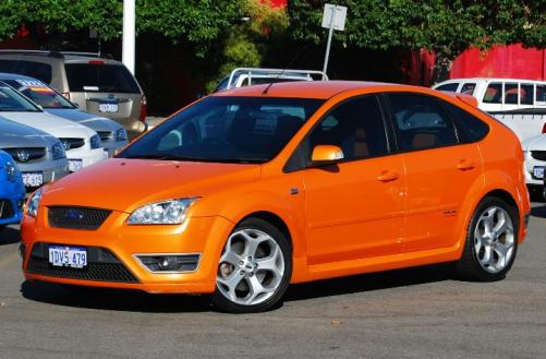

frasian Posted May 8, 2012 Report Posted May 8, 2012 in colour i vote: the stage 3 orange pearl from the ford terrortory the blue like your mr2 or the purple from the ve commos or an awesome red with alot of flake in it don't go pearl white as in the sun its sexy but without sun its a gay cream. Quote
