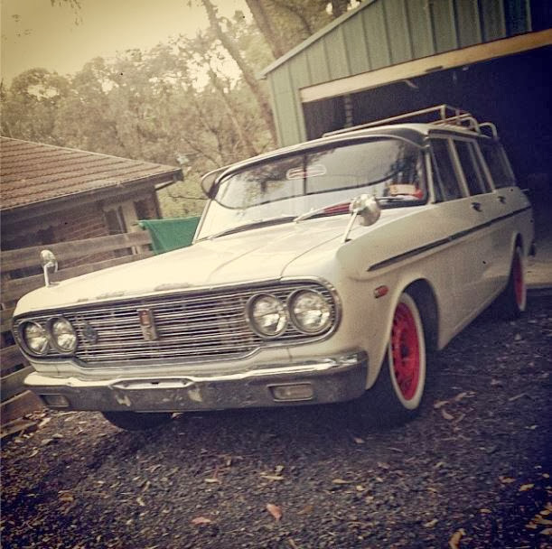

silverra23 Posted November 24, 2013 Author Report Posted November 24, 2013 Things learned over the weekend 1. Cheap Chinese amplifier importers are dodgy as ʞ©$ɟ - they are now offering me a part refund so that I can go and get the radio component fixed myself. Ebay/paypal dispute opened!! 2. King Spring KFL57 puts the front higher than stock when new (I imagine the old springs had some sag). So 3 hours of effort in the afternoon yesterday resulted in a car that was no lower than before, and much sads on my behalf. 3. Pulling front springs out for the second time in a day isn't much fun. 4. Taking Mr Makita to Mr King Spring sorts out ride height issues. In this case 1 full coil off leads to a significant reduction in front ride height. It is probably too low to be sensible, but it looks ʞ©$ɟing ace. 5. Angle grinders still scare the bejesus out of me when in use. Here is a pic taken at 11pm last night after I decided I wasn't going to bed until I had her low! All that is now left for CJ2013 is a good clean, sort out the wiring for the tunes and fit the hub caps for the final time. And maybe a quick drive to make sure the lows isn't too low! Quote
silverra23 Posted November 26, 2013 Author Report Posted November 26, 2013 I will just leave this here.... just about ready for our Classic Japan show on Sunday :) For any one contemplating lowering a MS47 wagon, the details are KFL57 front spring with a coil cut off, and 3 inch lowering blocks in the rear. The cut front springs sat it on the bump stops, so they will need lowering too. Its probably too low to be practical, but it looks ʞ©$ɟing ace. Rear could almost probably have gone 3.5 inch or 4 inch blocks, but this will do for now. :) Quote
