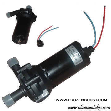

vltrb-0 Posted August 31, 2012 Author Report Posted August 31, 2012 stuck, not sure which one to go with? this is my water to air setup, the top hose goes to the heat exchanger under the floor, the hose in the middle goes to the cooler in the bay and there is a hose going from the cooler to the heat exchanger what i'm stuck with is the best place to put the pump as it has to push water through the cooler but also lift water out of the heat exchanger to the reservoir I'm tossing up between two intank lift pumps, on to lift into the reservoir and one to pump up to the cooler Quote
vltrb-0 Posted September 3, 2012 Author Report Posted September 3, 2012 booked for saturday the 15th to get tuned, used a fish tank pump for the water to air setup works a treat Quote
_FNQ_rolla_ Posted September 15, 2012 Report Posted September 15, 2012 used a fish tank pump for the water to air setup works a treat I do not understand using a fish tank pump when it looks like you have put some good quality equipment on your car. I just hope this does not fail on you, if it was my car I would have bought a bosch water pump like they use on the water to air intercoolers. Hope all went well on the 15th All the best with your build. Quote
