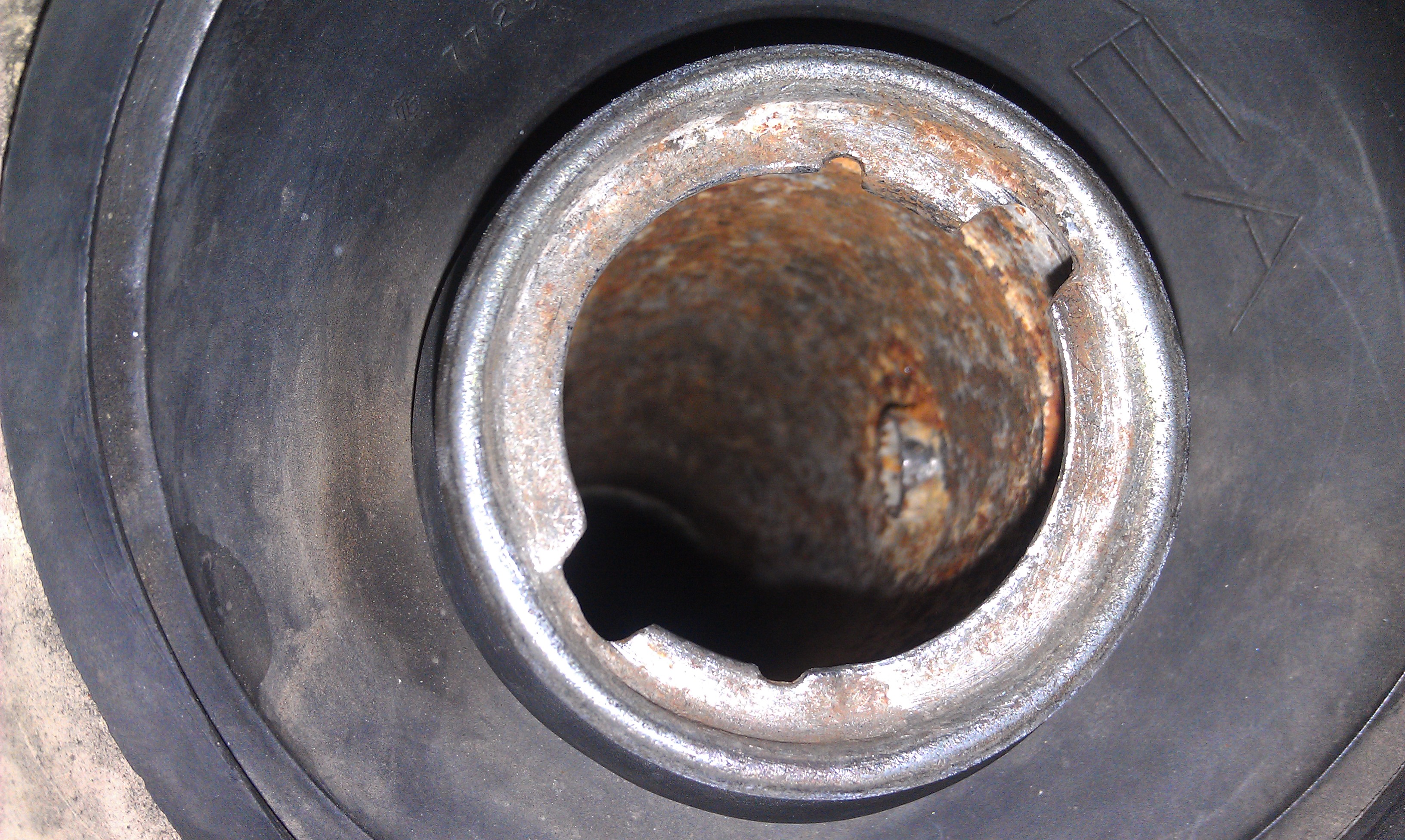

rxsammy Posted March 31, 2012 Report Posted March 31, 2012 So I picked up a 1983 KE70 last week. I had been thinking about getting a car again, never had a Toyota, had quite a few old Mazdas and a couple of Datsuns. This was fairly cheap so I thought I might as well snap it up and see how much it needs to get it back on the road. It had been a courtesy car for a local mechanic. Not 100% if I'm going to keep it yet, I'm a poor uni student so might move it along if I find it needs too much. It's got a stock 4k-c which seems to run great and a 4 speed. Here are some teaser pics: Dodgy repairs under fuel flap. Rust is bottom of rear guard, pretty bad but seen worse, I sanded this back and painted with rust converter. Plan is to just fibreglass filler this up and get through road worthy. Probably look at it in the future when it starts bubbling through again. Old repairs under fuel flap after grinding it back. Just gonna bog over this too for now. Rust in fuel filler, have to do something about this, can you just swap the filler neck? Example of some of the rust in boot sills after grinding back a bit. If I keep the car I'm going to keep it pretty much stock while it's going ok. Plans are: - Get some generic chrome door mirrors - New shocks and lowered springs in front - Prob chopped EA falcon springs in back - Urethane bushes all through front. - Basic stereo - Fit Sports Steering Wheel I've already got - Maybe extractors and 2" exhaust at some point. - Keep the steelies on it until I can afford either some MA61's or some other awesome oldskool rims. Thanks for looking, Sam Quote

rxsammy Posted April 1, 2012 Author Report Posted April 1, 2012 Any info on the rust in the fuel filler neck? Can this piece just be swapped over? I'm guessing it's pretty bad to have rust getting into the fuel tank.. Quote
B.L.Z.BUB Posted April 1, 2012 Report Posted April 1, 2012 Thats why fuel systems have fuel filters. I wouldnt stress too much about it. Check the condition of your fuel filter, if it looks ok then you probably shouldnt worry too much. If it is full of crap, then worry. Just had a look at mine, its the same if not worse. Quote
Willis Posted April 1, 2012 Report Posted April 1, 2012 Just change your fuel filter regularly. Should be sweet. Quote
rxsammy Posted April 1, 2012 Author Report Posted April 1, 2012 Ok cool, thanks guys. I won't worry about it too much then. Fuel filter looks fine too. Quote
