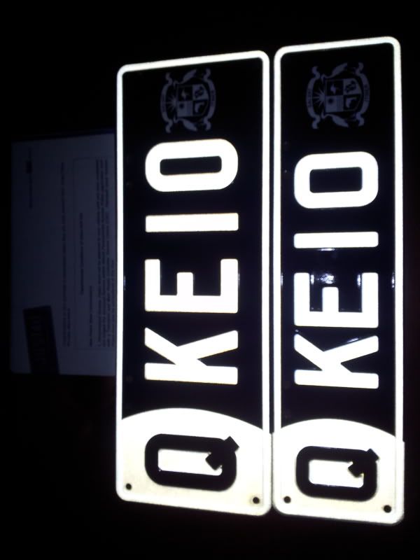

Stenzel Posted March 22, 2012 Report Posted March 22, 2012 (edited) Ended up getting the Q signature plate instead of the flexi? :hmm: Can't wait to see it on the car! if you get reprints can you get them in flexi as well?? Edited March 22, 2012 by Stenzel Quote
nerfbat Posted March 22, 2012 Author Report Posted March 22, 2012 thanks guys..! and dave the signature series and flexi are 2 different types, i just felt that these looked more 'classic' than the others? plus they were $300 cheaper :-/ so yeah if anyone wants, "KE10" in flexi 2x2 should still be there Quote
Stenzel Posted March 22, 2012 Report Posted March 22, 2012 Yeah! they look pretty cool and I haven't really seen signature ones on any cars, I just thought you had still booked them in for flexi :) Quote
