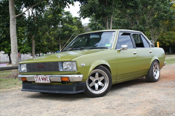

84Co-Rolla Posted April 27, 2012 Author Report Posted April 27, 2012 thats soo nice man just give me a hint, was it a primer.. was it clear coated? anything it looks effin sweet! Quote
B.L.Z.BUB Posted April 27, 2012 Report Posted April 27, 2012 (edited) It was a 2pac with a flattening agent in it. I used microfibre paint rollers to apply it. Came up a bit orange peel but as I was going satin/matte it didnt matter. No clear. Bugger all prep. Edited April 27, 2012 by B.L.Z.BUB Quote
chrisfindlay Posted April 27, 2012 Report Posted April 27, 2012 Green. Hardly any green ones around. Pic of my old flat green one. That would be my car.. Quote
84Co-Rolla Posted April 27, 2012 Author Report Posted April 27, 2012 ohh nice man! microfibre paint rollers? where you get them from? sounds pretty easy man, might do something similar! Quote
B.L.Z.BUB Posted April 27, 2012 Report Posted April 27, 2012 (edited) Bought it all from a paint shop, like Resene or something. All up the paint job was around $200 including rollers etc. Took a weekend to paint. Id start on one corner and work my way around and I circled the car a few times gave it about 3 coats all up. There were some roller marks on the roof but they could of been wet sanded out. Next time Ill roll the primer too. So easy and so much less mess. You can wet sand between coats and make it pretty m int too. Just takes ages to harden. Edited April 27, 2012 by B.L.Z.BUB Quote

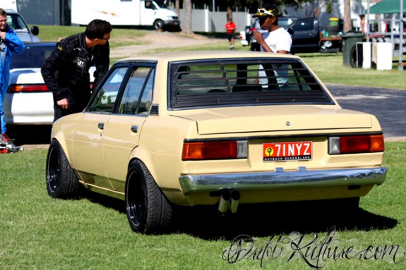

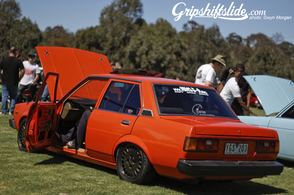

84Co-Rolla Posted May 16, 2012 Author Report Posted May 16, 2012 any way i havent made my mind up on a colour, its beteen orange or beige, what will suit a slanty better? Quote
B.L.Z.BUB Posted May 16, 2012 Report Posted May 16, 2012 (edited) that beige one is a V8, which reminds me I need to paint my upper doors black and find some black steelies ASAP and mount my rear louvre oh and slanties, I reckon white or red. Edited May 16, 2012 by B.L.Z.BUB Quote
