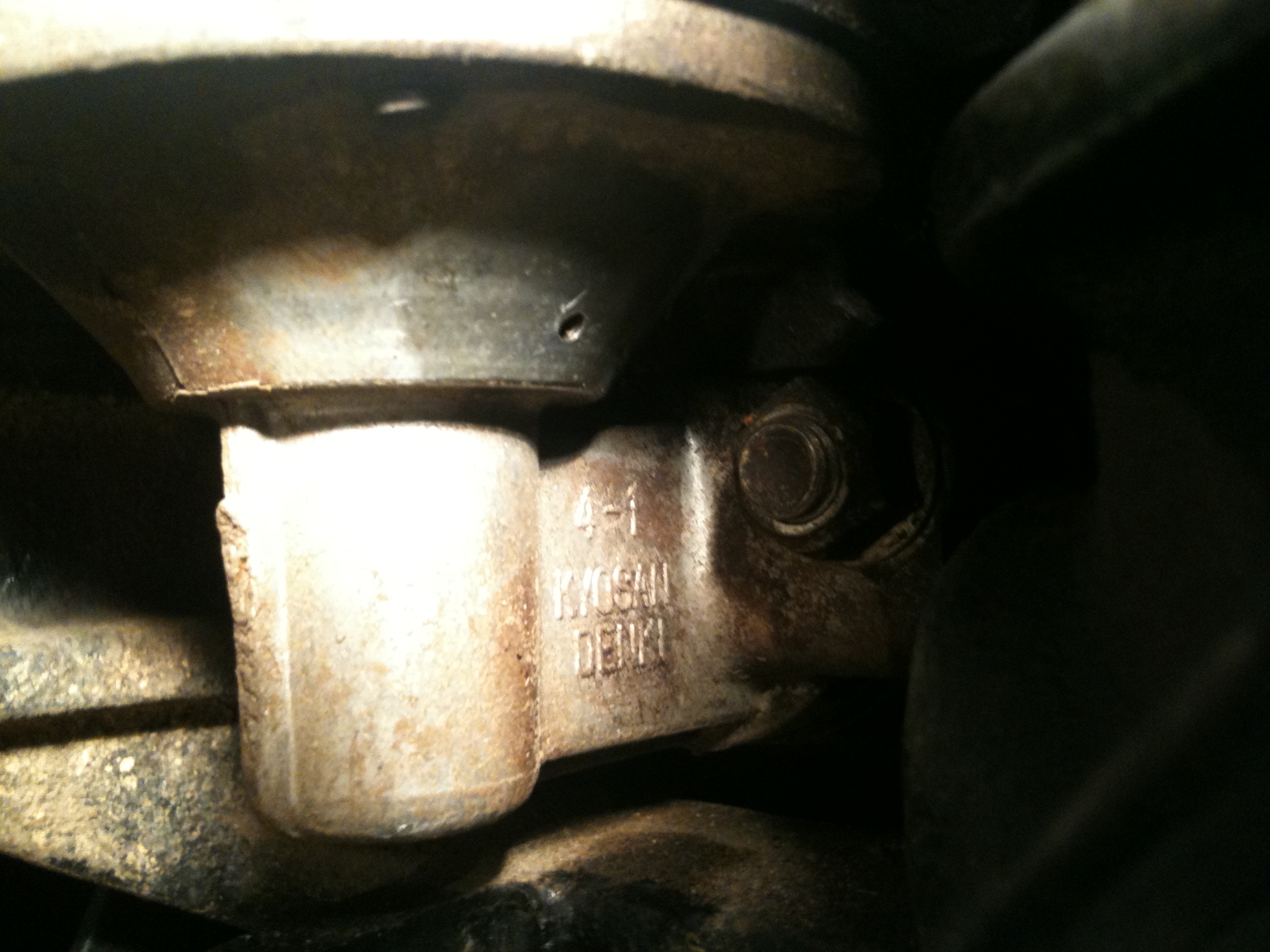

Majestic36 Posted January 29, 2012 Report Posted January 29, 2012 Ive got a ke70 with a 4k motor in it and I have removed the air conditioner system from it. I started it today and my mate noticed 2 small holes on the standard fuel pressure regulator are spitting fuel out. The small holes are on the bottom of the regulator what would be causing it to spit out the holes? are they meant to me there? Quote
ke70dave Posted January 29, 2012 Report Posted January 29, 2012 You talking about the fuel pump? The holes in the side of the fuel pump spit out fuel when the internals are cactus. No fuel pressure reg on a 4k? Quote

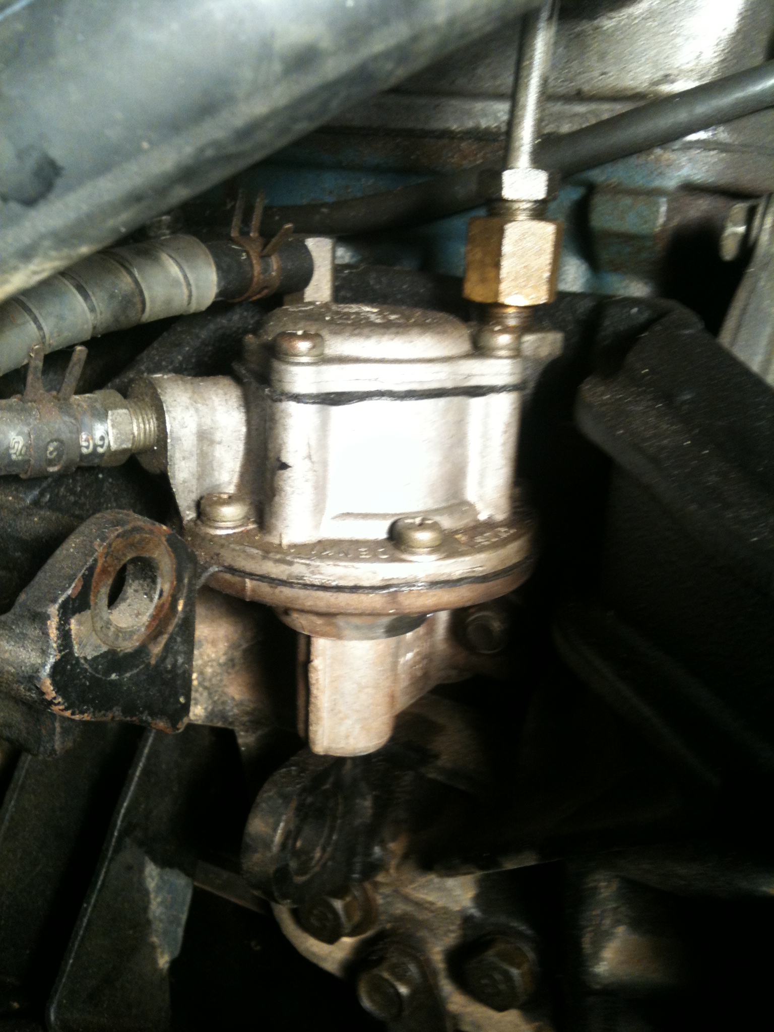

Majestic36 Posted January 29, 2012 Author Report Posted January 29, 2012 It doesn't look like a fuel pump more like a fuel pressure regulator but I've attached pictures of it. Where the hole is What its leaking from Quote
B.L.Z.BUB Posted January 29, 2012 Report Posted January 29, 2012 Its the fuel pump (mechanical) it leaks fuel out of those holes on purpose to let you know its screwed. Quote
Majestic36 Posted January 29, 2012 Author Report Posted January 29, 2012 Oh ok thanks for clearing that up, so it is a fuel pump. This is my first ke70 so I'm new to all this. Where would be the best place to get a new one from or better one? Quote

altezzaclub Posted January 30, 2012 Report Posted January 30, 2012 Its just the diaphram inside that has developed a hole. Check and see if the diaphram is still a part available. Quote

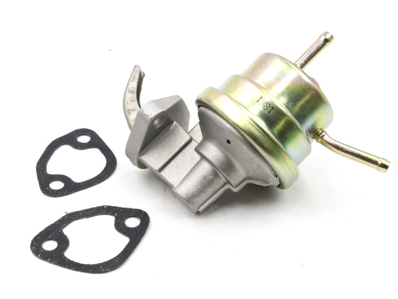

knibusu Posted June 29, 2023 Report Posted June 29, 2023 Hey guys I know its been 11 years since last reply, but worth a shot, so my old mechanical fuel pump was leaking from the bottom I believe it was from the bottom of gasket seal, as I could not see any fuel from the holes at the bottom of the pump and it wasnt leaking it was more like pissing, I ordered a brand new Goss Fuel pump with brand new gaskets, Installed on the 4k, and same thing is happening its pissing from the gasket seal, what could be some causes of this uneven insulator, did not scrape the old gasket off enough(I pretty much scraped it back to bare metal), just shitty aftermarket gaskets(they were plasticy ), the engine block is no longer flat, or just need to use permatex sealant. Any response will be helpful. Quote
Banjo Posted June 29, 2023 Report Posted June 29, 2023 (edited) Remove the fuel pump, & insulator, between the block & the pump mounting flange. Measure the width, or thickness of the insulator. This is critical. If it is too narrow, the travel of the fuel pump action will be too great, & damage will occur. It's too late, & too cold now, to head out to the shed, & measure the correct thickness, but off memory, it's quite thick, like somewhere between 10-15mm. Most replacement pumps come with two (2) gaskets, that go either side of the insulator mounting spacer block, but do not supply that block itself. I'll check that figure in the morning, & post it here. Cheers Banjo Edited June 29, 2023 by Banjo Quote
Banjo Posted June 29, 2023 Report Posted June 29, 2023 Quote as I could not see any fuel from the holes at the bottom of the pump and it wasnt leaking it was more like pissing, After reading your post again, I'm not sure whether you are referring to fuel, or oil pouring out ? The "spacer" / "insulator" is a fraction under 10mm in thickness, from the one I measured here this morning, fitted to a running engine. If it is oil, then it is simply a case that the preparation of the mounting land on the block, & fuel pump, have not been prepared well, or no gasket goo applied. There is a lot of oil being "splashed" around, inside the block, at that point. The seal of the fuel pump, to the block, must be totally secure. That's why all new pumps, are supplied with two new gaskets, (one either side of the spacer/insulator). Cheers Banjo Quote
