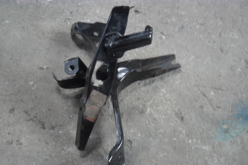

Thought i might update the build got some genuine toyota parts today apart from the front chrome bar brackets (rears are though) :dance:
