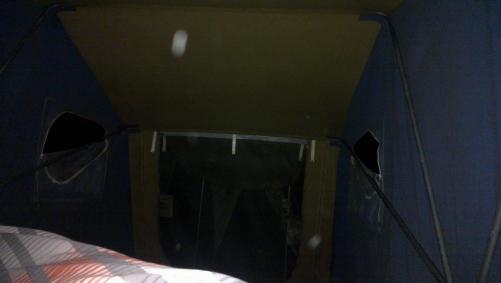

In this photo the inside tailgate is still lowered, It serves an extra purpose as a "step up" into bed. It can be closed off and the tent fully sealed.

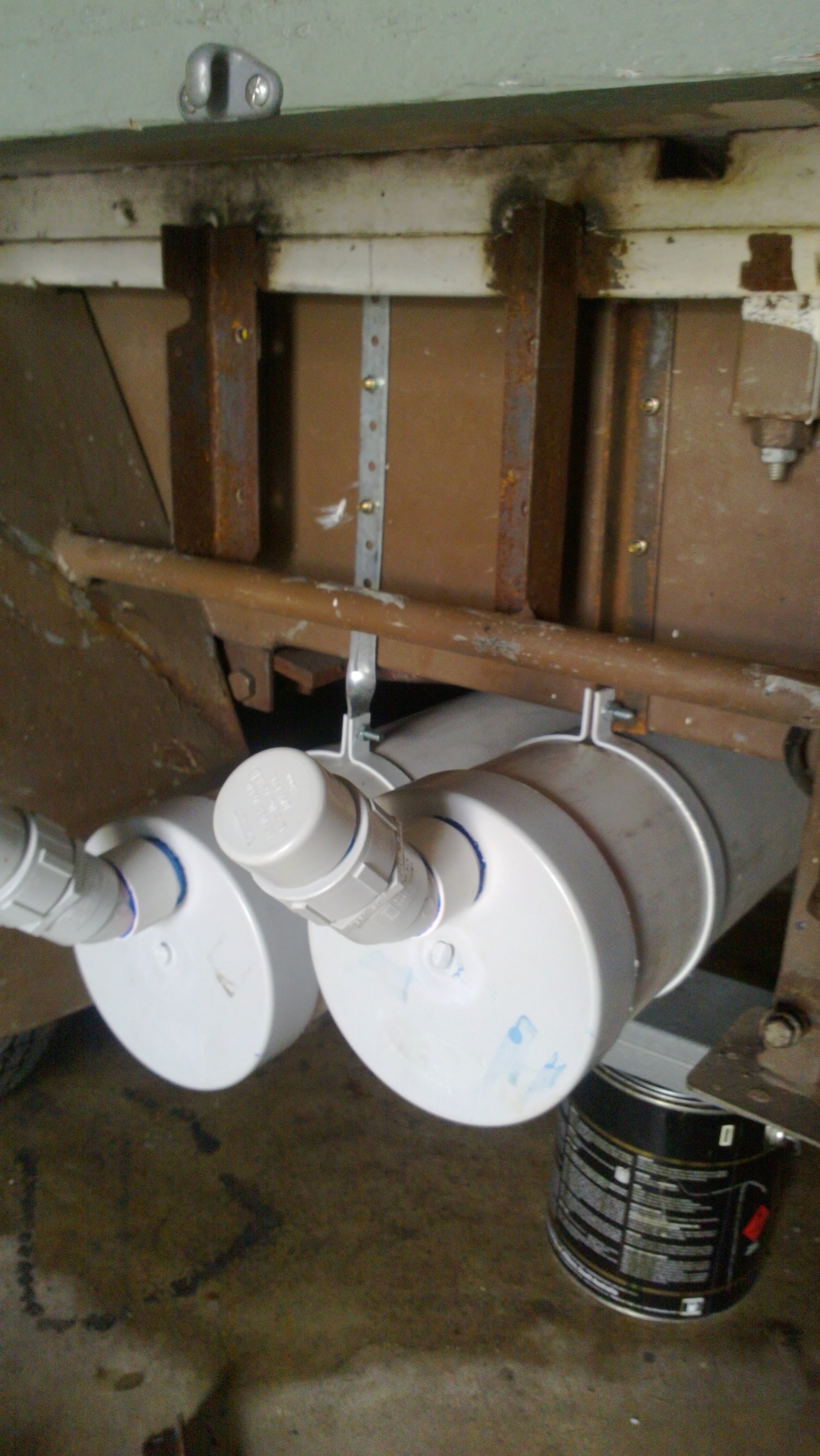

My plan now is to build my own water tanks and mount them under the trailer at the back with the tap ends coming out under the new kitchen bench. If my calculations are correct with both tanks filled, I should have around 60Ltrs.
Now I have realised how expensive this is costing, so I have limited both pipes to only having one screw end. The screw end will be on the lower side with the taps. Therefore if I ever have to drain them, I just unscrew the caps.
Both pipes have their mounts on the side of the trailer...
The filler end was a bit tricky. I needed to make it so one could easily fill the tanks with water, seal them as well as releasing the pressure so the water will flow out of the taps. The end result has screw caps i've had to make up with.
here is the end that will come out under the kitchen.
Here is how the filler end will look like...
And how the taps will look once installed...

One last possible mod would be to unstitch the zipper from the annex, and stitch in a small extension that would give me extra head space underneath as i'm finding it hard to move around. As you can see, i've jacked it up to its limits...

Do the filler ends of the water tanks stick out further than the guard ? could possibly get knocked off

As for the fillers, they do stick out further than the guard but not further than the camper top.

I've changed the brackets holding the water tanks. As you can see the difference here...
And now with both changed...
And the other side...
And from behind...
