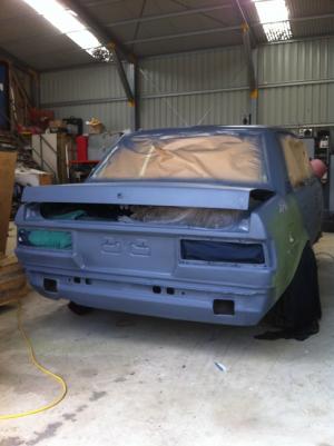

Then the rolla, went through 13 hours of intense sanding, she didnt like it..
post-14737-0-72371900-1334484935_thumb.jpgpost-14737-0-82807700-1334484950_thumb.jpgpost-14737-0-31803300-1334484977_thumb.jpg post-14737-0-43602100-1334484966_thumb.jpg
Then she got ready for primer, which was all sorts of fun!
And then I gave her, 3 lovely coats of primer, and now she looks unreal...

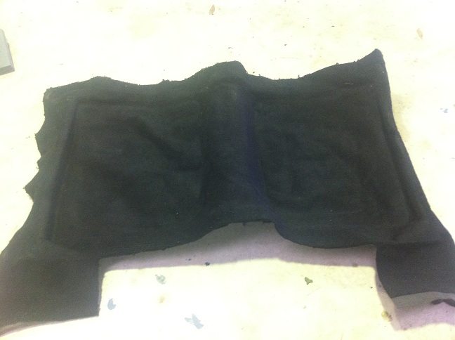

I then took the rear half of the pre-moulded carpet and shaped it out the best I could..
(WHEN SOMEONE OFFERS TO SELL YOU PRE-MOULDED CARPET SLAP THEM IN THE FACE AS IT DOES NOT EVER FIT LIKE THEY SAY IT DOES..I LEARNT THIS THE HARD WAY.) :oops:
Edited by chrisfindlay
You can probably use this as a "How to for installation of carpet" as I had absolutely no idea how to install it, and I'm sure there are plenty of other people who would struggle to install it also..

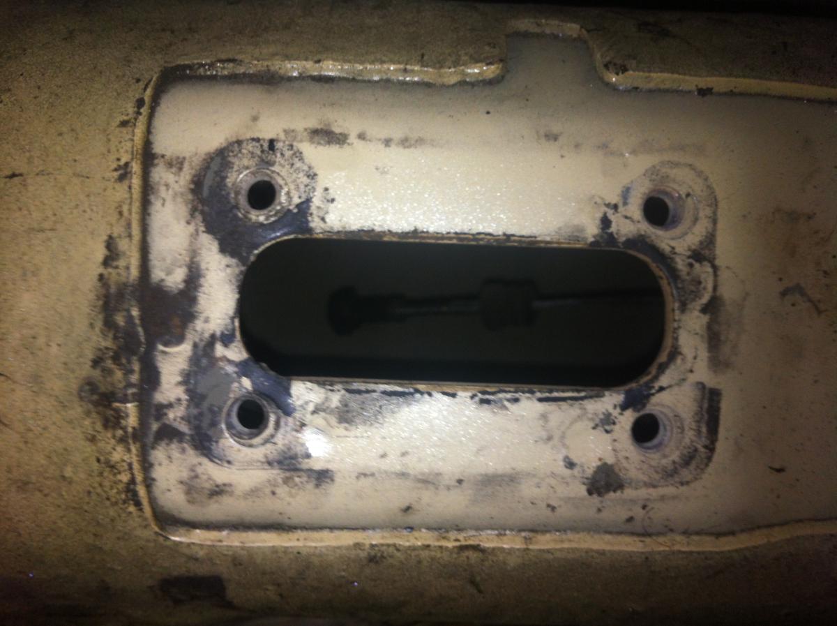

So when you do the carpet install, you have to remove your gear stick, I tried to avoid this but it just can't be done..
