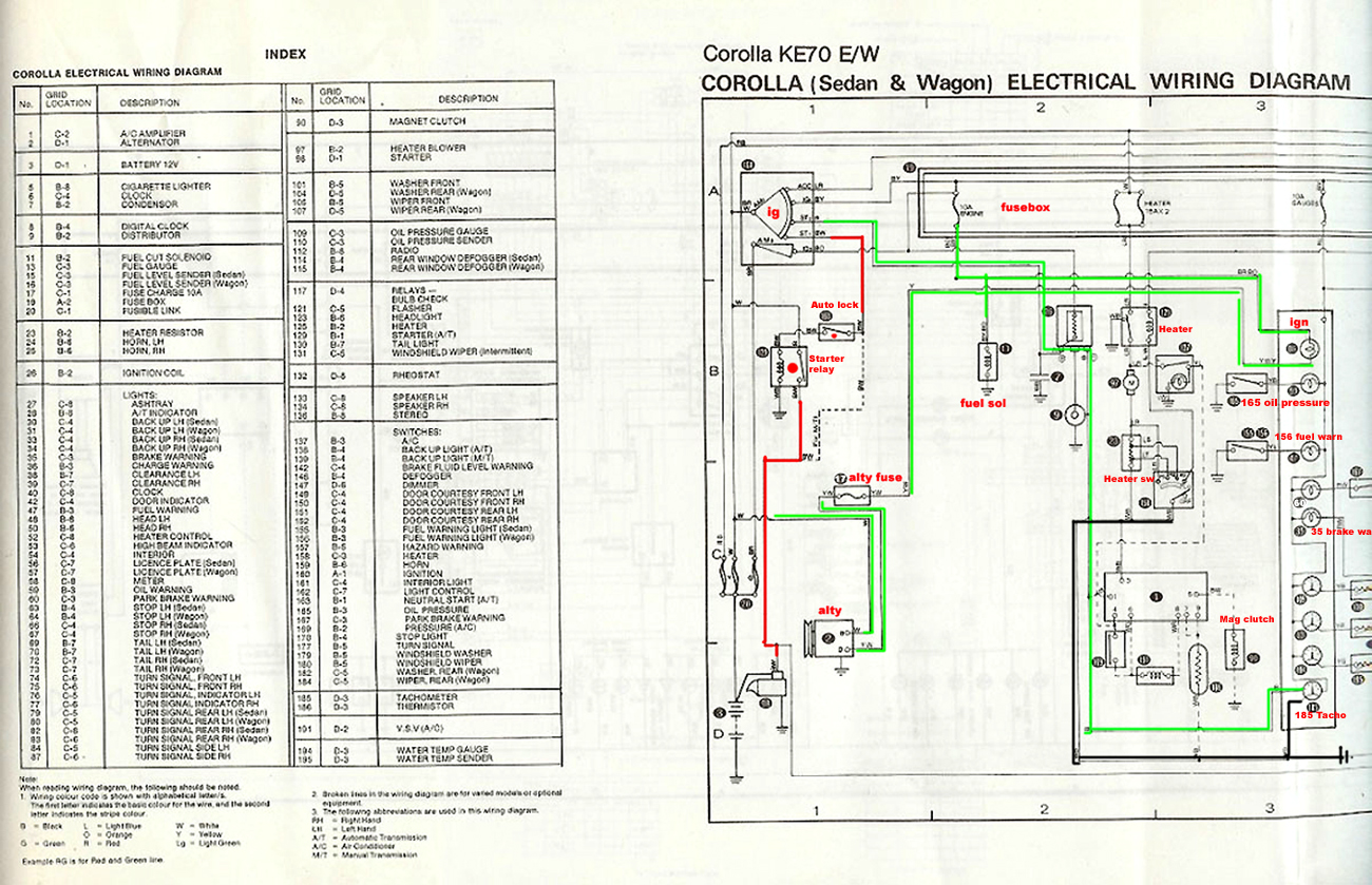

Hazzard Posted January 2, 2012 Author Report Posted January 2, 2012 so i went and had a look at a mates K series repair manual. it says that there is a fuseable link somewhere between the ignition, and the starter. checked the fuse box under the dash, and the one behind the battery, but neither of them have a fuse for a starter. does anyone know if theres a third fuse box in a 70 panno? Quote
altezzaclub Posted January 2, 2012 Report Posted January 2, 2012 No, but there ae fusible links coming off the starter motor and heading nto the general wiring. They are just coloured bits of wire that melt easily, and the power to the car goes Battery-Starter-Fusible links-Main power circuits. One of mine had been degraded by the exhaust manifold so I pulled them out, cleaned them up & resoldered one. They are the 3 curvy shapes by the letter "C" in this diagram, although I remember them as comng off the battery +ve at the starter itself. Quote
Hazzard Posted January 2, 2012 Author Report Posted January 2, 2012 where abouts is the starter relay? because there isnt one in the fuse box behind the battery like all aus spec ke70's. otherwise i would've tried the one out of my wreck. Quote
