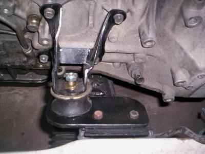

demotorsport Posted January 22, 2012 Author Report Posted January 22, 2012 On 1/11/2012 at 11:26 AM, EN33MY said: HAVE YOU GOT SOME PICTURES??? I'm DOING THE SAME THING, CUT DOWN AND LAID BACK THE MOUNTS ON THE K FRAME USED SUZUKI STOCKMAN MOUNTS ($50 PAIR AND AN 1/2" ADJUSTMENT IN ALL DIRECTIONS) TO ADAPT TO CA MOUNTS. HAD TO TAKE MAJORITY OF THE FIREWALL OUT TO CLEAR THE REAR OF MOTOR AND MAKE ACCESSIBLE FOR SERVICE ETC. REPLACED THE TUNNEL WITH 1.6MM SHEET SEEM WELDED ENGINE BAY, THE INLET MANIFOLD IS GOIN TO BE TOO CLOSE TO MASTER CYLINDER. GOIN TO TRY FIT A HIACE OR SOME FORM OF VAN PEDAL BOX UNDER THE DASH SO IT WILL HAVE VACCUM ASSIST AND A HYDRAULIC CLUTCH PEDAL OTHERWISE WILWOOD REVERSE MOUNT PEDALS WITH A BIAS BAR. GOIN TO TRY PUT A CUT DOWN CRUMMYDORE DIFF IN AND THE FRONT STRUT/SUSPENSION ASWELL WITH THE VT CALIPERS. THATS MY TRAIN OF THOUGHT THERE ISNT A LOT OF INFO OUT THERE.... didnt need to touch firewall or tunnel appart from shifter hole. made custom mounts have same problem with clutch master and still havent bothered to fix that yet. very intrested to see how you use the como struts as a have a vl for parts. Quote
